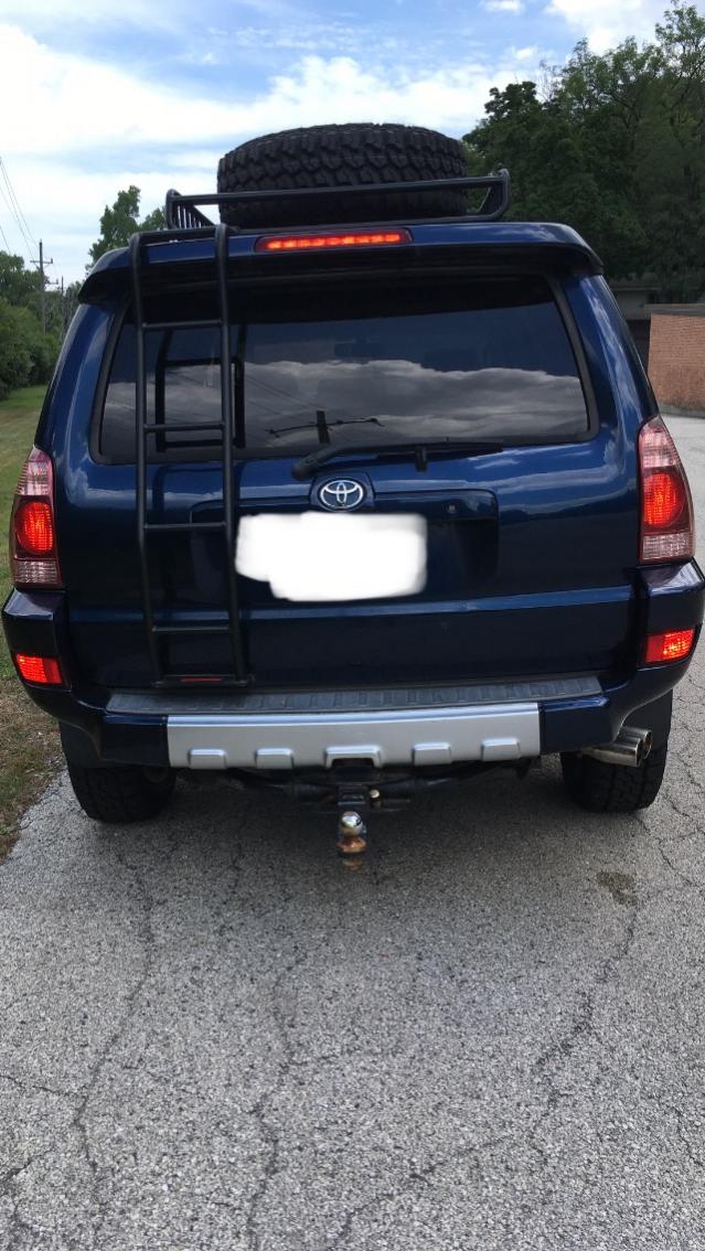

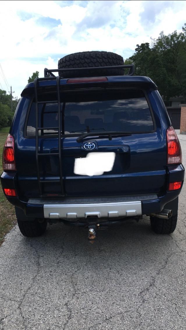

Update: I completed my install of the moforkit lenses and Sylvania 7443 LED bulbs today, connected to the tail light wiring, not the trailer wiring. My lenses are running/brake light combos, no other functions.
I haven’t gone through all 27 pages of this thread, but the OP said it might not be possible to have both brake lights and running lights with LED bulbs. I have both, and they are functioning properly (so far).
There appear to be small gaps between the lenses and the bumper. In the next few days, I may apply a thin coat of caulk to seal the gaps.
I have added two pics. The first is with the running lights on, and the second is with the brakes applied. It doesn’t show well in the pics because of the lighting, but the brake lights are a lot brighter than the running lights.
