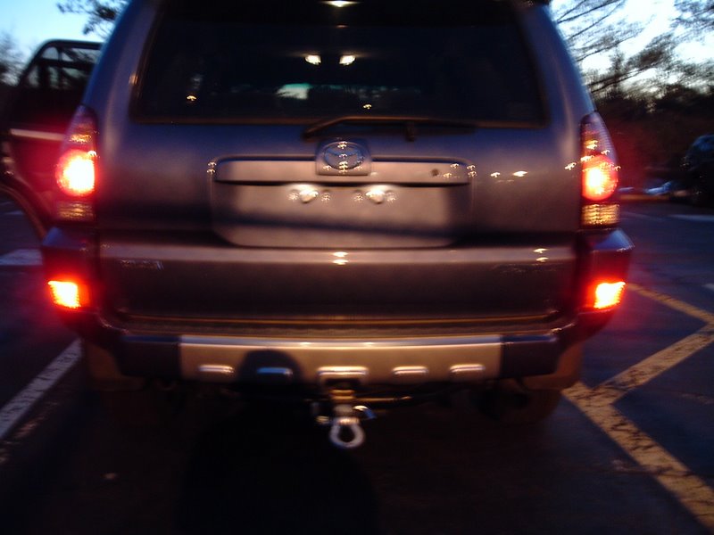

I did this mod about a month ago. Followed the route of a few different folk with mine.
I'm using the D-Cell LED light and 3157 socket/harness from autolumination, having them wired up to my brake, turn and running lights. I'm using diodes on the brake and turn signal lines.
Baking the lenses open makes for a much easier/cleaner mod. Used silicon and cold shrink/stretch tape to waterproof it all.
I'll try to get a vid up soon of it all working separately. Looks sweet. :)
