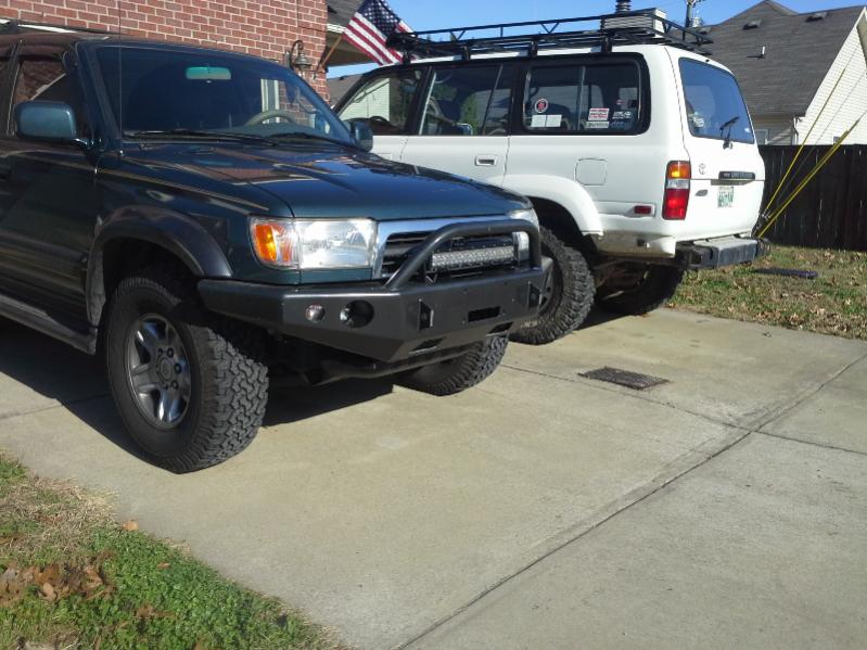

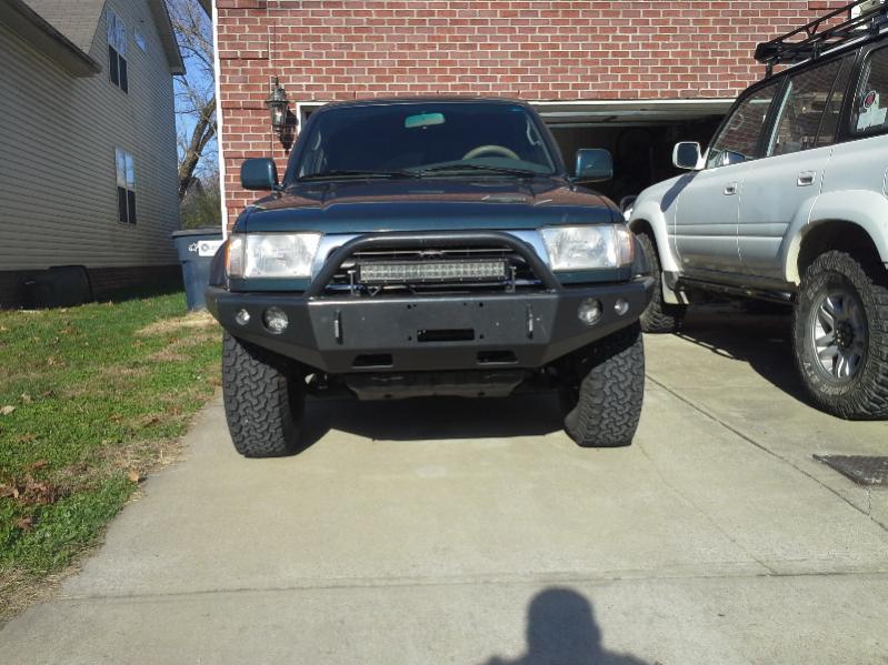

And for reference, here is my bumper installed:
