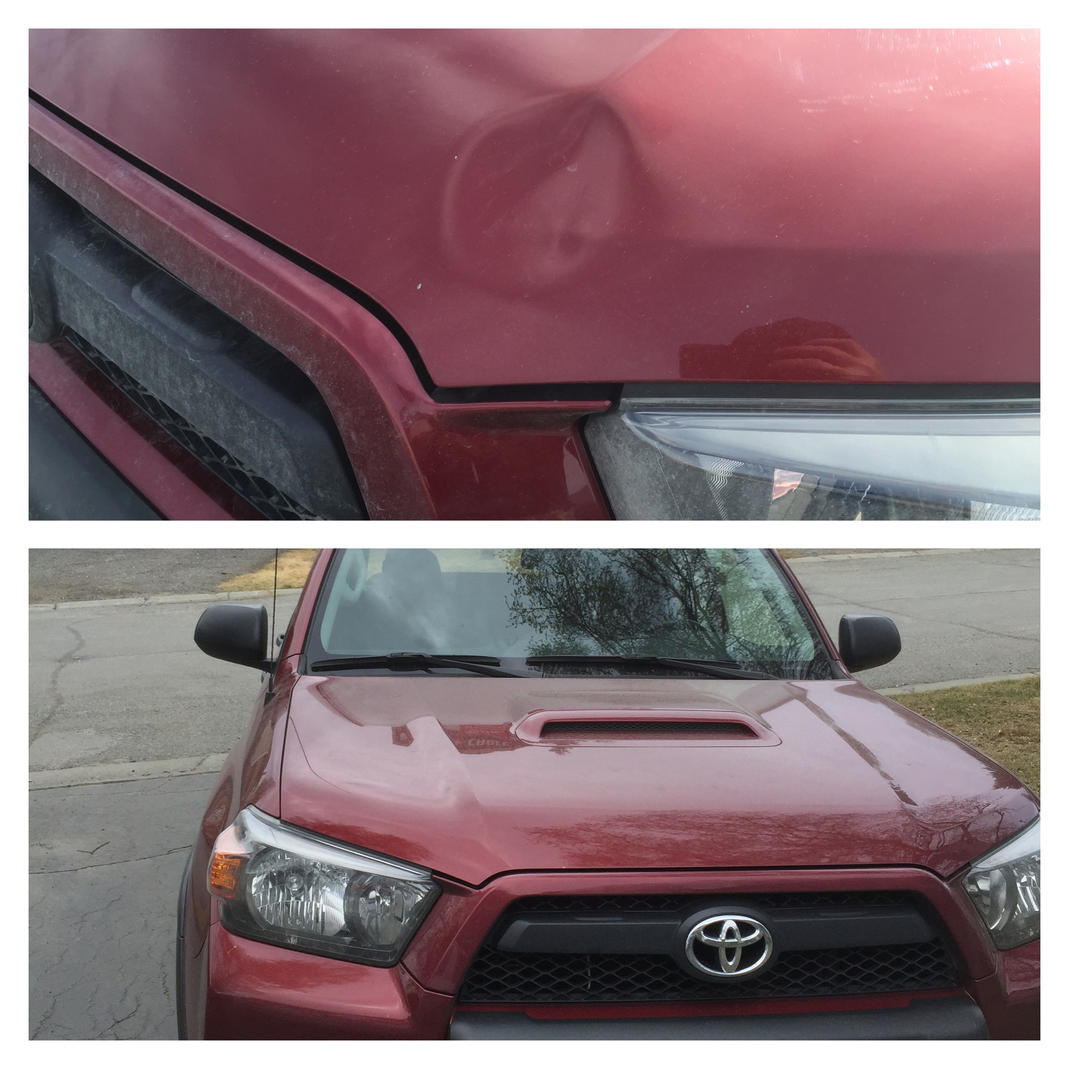

Here's my PDR. Sorry for the "after" picture. It's the only one I have... It just so happens I was taking a picture of something else and got my trucks front end.
