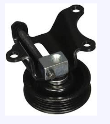

The ps tension is similar to the alt tighter. It's a long bolt through the colum shaft. Unless you stripped those threads, I don't see how you can have that happen.
You have to loosen the bolt so the pump can pivot just like the alt.
The major difference is the alt bolt can swing out of the tensioner where the power steering can not.
Did you run out of adjustment and the 2 threads separated?

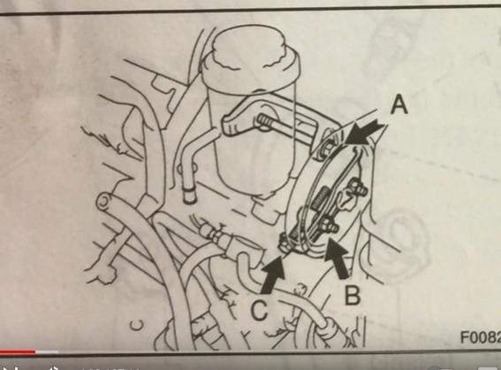

It's not reverse threaded. If you look at this Timmy youtube video: Drive Belt Replacement - YouTube at 4:10 ish is the FSM and then around 9:50 shows him loosening the power steering tensioner setup to get the belt off.
It tightens up eventually but seems to take forever.
Thanks for that. So what I have been doing in loosening A and B and turning C clockwise. Then I tighten B and A. The squealing did subside the first couple times. That C tension bolt is hella long in the picture I grabbed from the video! Maybe I need more patience and more turns.....It's probably a 16th of a turn each ratchet crank due to there being no space to work down there.
I had to replace that whole tensioner setup on my 5 speed. For some reason it was all missing when I bought the vehicle. Anyways, I felt like I spent 15 minutes just tightening that long bolt with a ratcheting wrench. It took forever!
I will crank on.......
