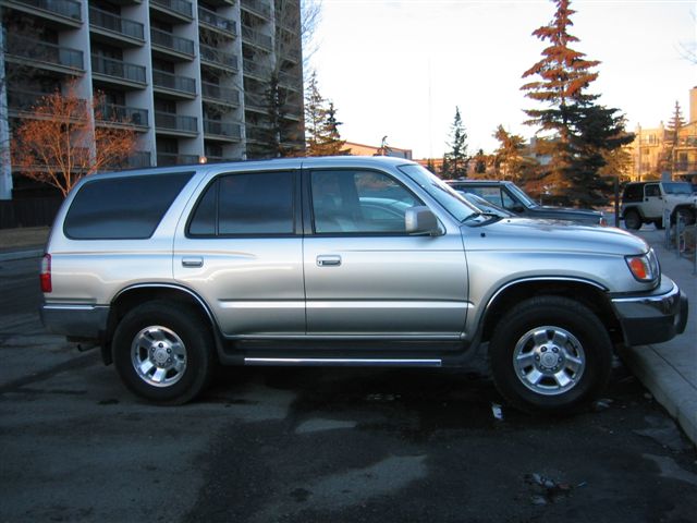

My 4Runner
quick pic..

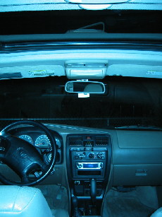

Just got back from install shop...

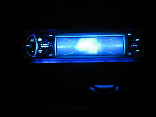

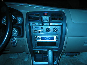

My Panasonic head unit sounds great. The sound is much crisper than the factory head unit. Here are some pics:

The stock headunit has a small separate amplifier behind the headunit. It probably produces around 30x4 (max power).
Goose said:
Hey MR...where's that blue glow come from? Is that from the radio??
Yes my head unit gives off blue glow around the edges. Its the only CD player I have seen that has this. It looks sweet at night.
