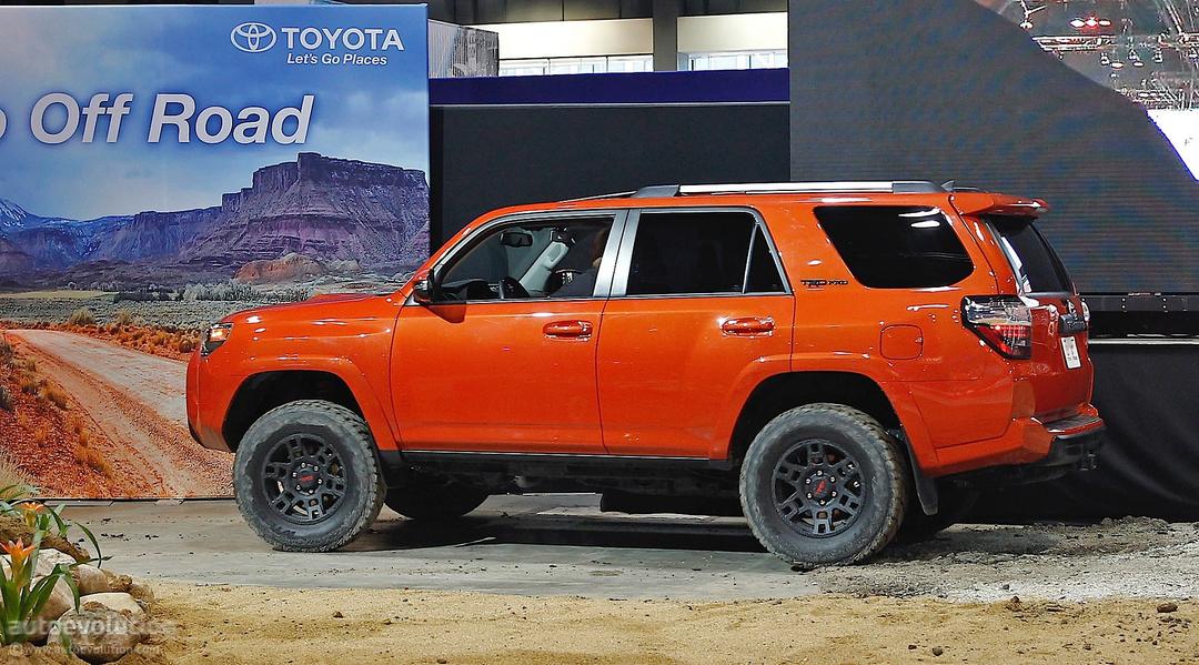

TRD Pro Reverse Rake?
Since we've established that the 5100s set at 1.75 gives a level fender look, but a slight reverse rake with regards to the rockers/frame, does that mean the TRD Pro with a 1.5" lift up front might possibly have the same problem? Especially with a load? Or just maybe to a lesser extent? As far as I know, the only thing they're changing for the back is new shocks, so there shouldn't be any change for the height of the rear.
Here's a pic from Chicago...maybe not the best, since the ground might not be completely flat under the runner, but it does look as if there is a slight reverse rake, especially when you look at the rockers.

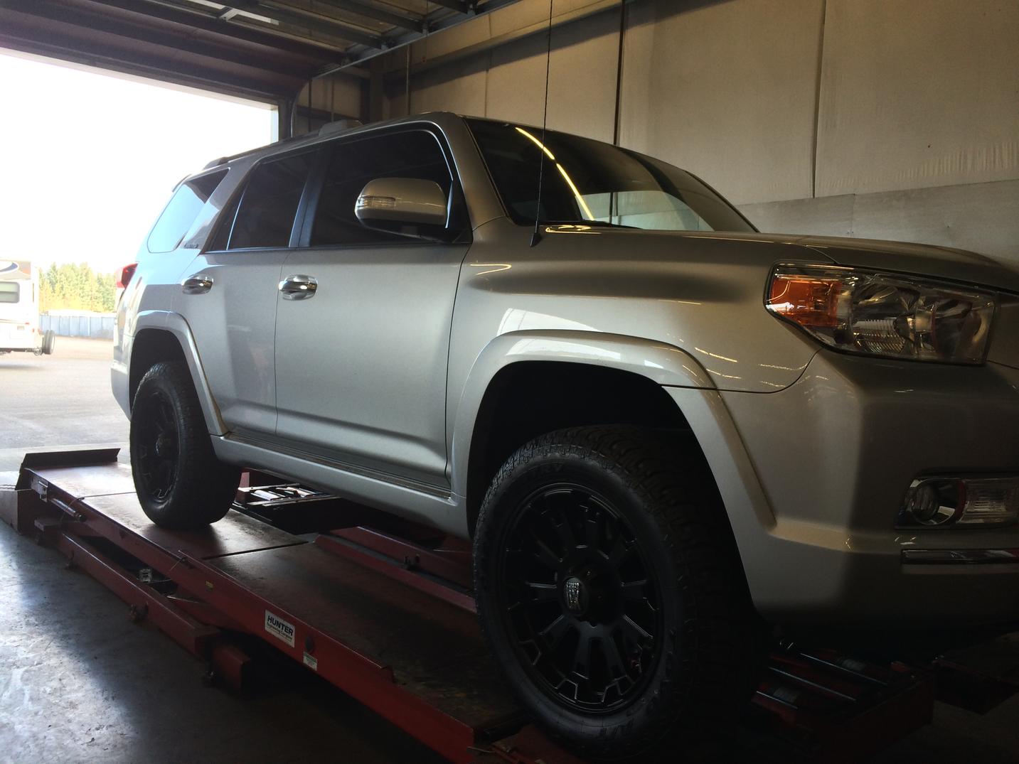

1" spacer did the job.
Okay; after all the back and forth as to what's level and what's not level. I decided to go the simple/safe route and add a 1" spacer to the front only. This route also saves me from replacing the expensive XREAS system. This is a new (to me) vehicle and I just can't get myself to start tearing out parts too quickly.
I'm really happy with the end result of the $40.00 1" spacer. IMO it sits perfect. just a small amount of forward rake which levels out when putting the kids in the rear.
Thanks again for all the insight and feedback. Really liking the community on this forum.

^ That looks good. Seems like a 1" difference in lift between front/rear is a good compromise for leveling. I'll soon be doing a 2.5/1.5 lift.
