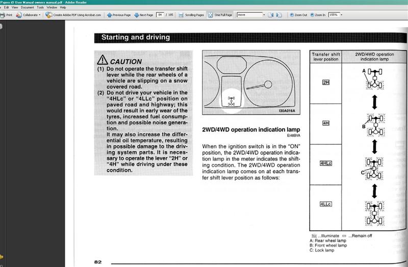

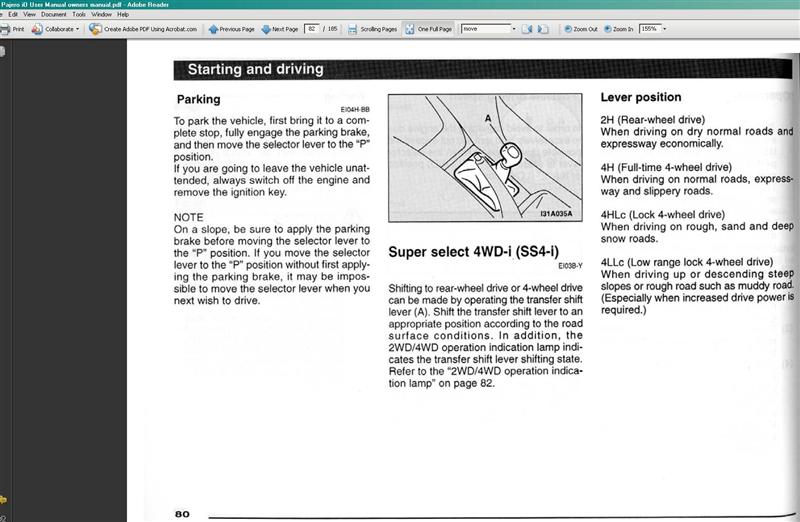

Have you ever seen the manual of a vehicle that has the option of 2wd or awd? I'm not sure I know of any such vehicle. I don't think you would include it in a manual if there wasn't the option to use 2wd. I think there was once a Pajero for a while that had something like that, but I don't know if that's the case or not.
A couple of screenshots from a Pajero manual showing the drive modes and 4wd cautions. It mentions "tyres" in caution #2.
