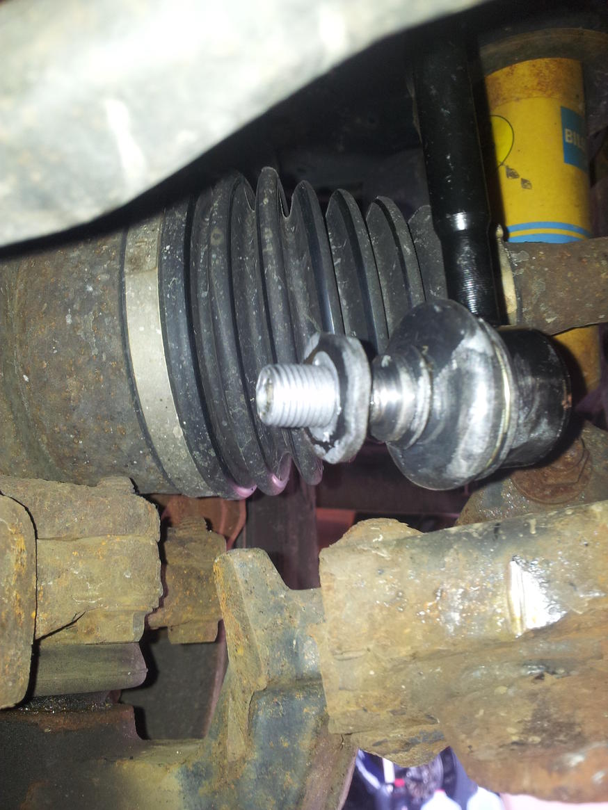

Hi folks. I'm swapping out the front swaybar end links and I can't find any info on where the lower threaded square washer goes. It seems to be somewhat threaded but I don't know how far down the threads it goes when installing it. I replaced them once already and those washers seemed to strip out which caused the links to be loose again. I must've done something wrong... I'm not even sure it goes on the inside! Can someone help? Maybe post that page out of the FSM so I know where they go? Thanks!

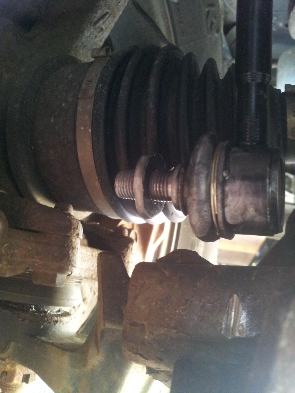

Thanks for that. Unfortunately the FSM doesn't accurately address my question. Take a look at the pics attached. that black "washer" thing is threaded on the shaft. It seems to go on the inside, but how far in or out does it go? I think I had itall of the way in last time I installed the links and it stripped out the thread which left them loose and flopping around.

Oh, I see what you mean. I took a closer look at my truck and it looks like mine is bottomed out against the inside surface near the boot. I would assume it's only threaded for manufacturing so it can be taken all the way down to the end providing a larger flange for the end link so the end link won't dig into the control arm mounting surface. I would bottom it out completely and torque the nut down on the other side.

Thanks for the info. I bottomed them out and tightened the nut down.

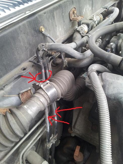

Yeah, I don't think it would hurt anything to do that. You can bypass it for as long as you'd like and it won't cost you a thing. You just have to switch one of the rubber hoses to a new spot. There was a similar post made earlier by someone wondering what was missing on their truck and it had been bypassed just like you're talking about.
Look at this thread and especially at the pic:
http://www.toyota-4runner.org/3rd-gen-t4rs/176248-what-am-i-missing.html
Follow the one rubber hose that is still connected and you'll see that it's just resting over to the right side of the pic not connected to anything. The other line doesn't even have a hose connected to it anymore. The reason you don't see that hose is because the angle of the pic doesn't show, but it's pulled back to the t-junction where that other rubber hose is supposed to connect. You can see it in the second pic. That hose that is contorting back to the t-junction I mentioned is the one that is supposed to connect to the bare metal line seen in the first pic. That will effectively leave both of the lines from the rear heater unit hanging open under the hood, everything still in place, and the coolant system closed off and functional.
