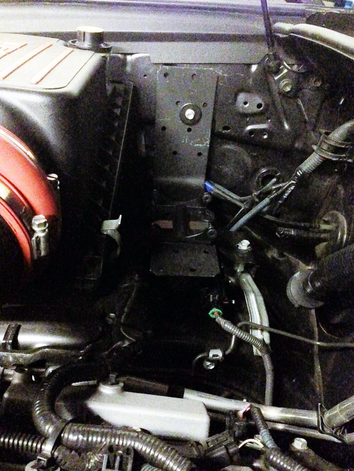

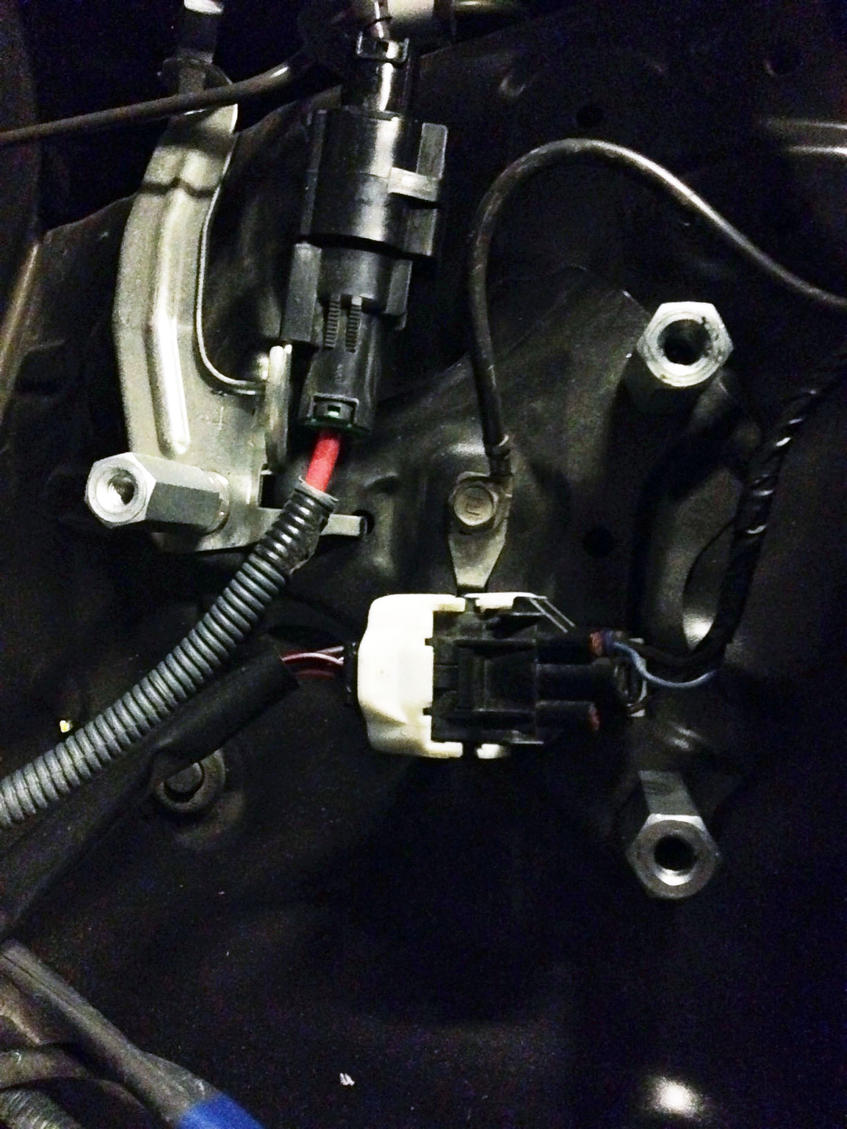

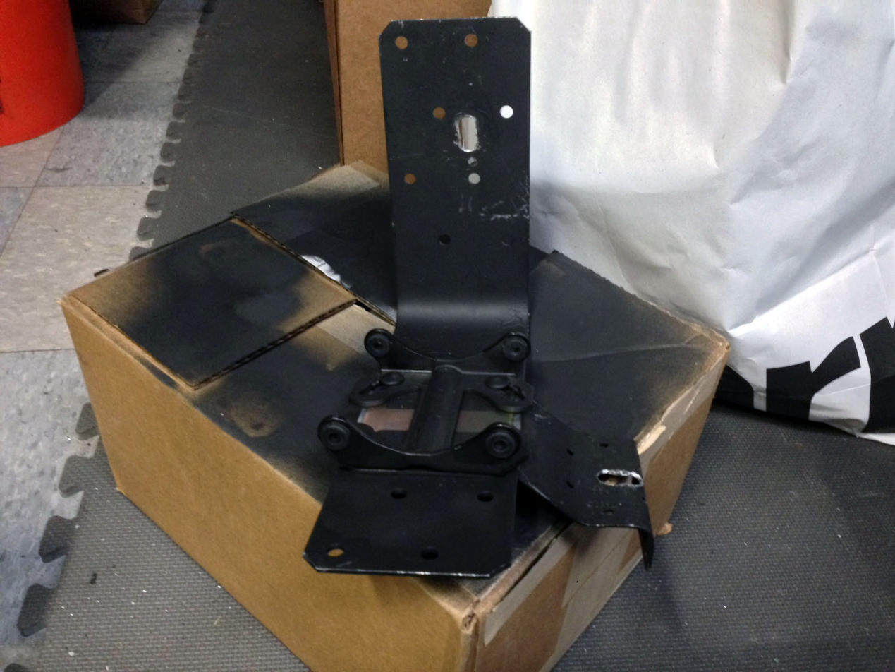

So I ended up leveraging some simpson ties (thanks [MENTION=102715]CrazyNorwegian[/MENTION]) along with some coupling bolts. This way I didn't have to move anything, and got to use all factory bolt locations. Also pays to save your bolts...I am reusing factory bolts.
Pics tell the story...
Coupling nuts in three locations
The fabricated bracket with the compressor mount on
The bracket bolted on to test fit

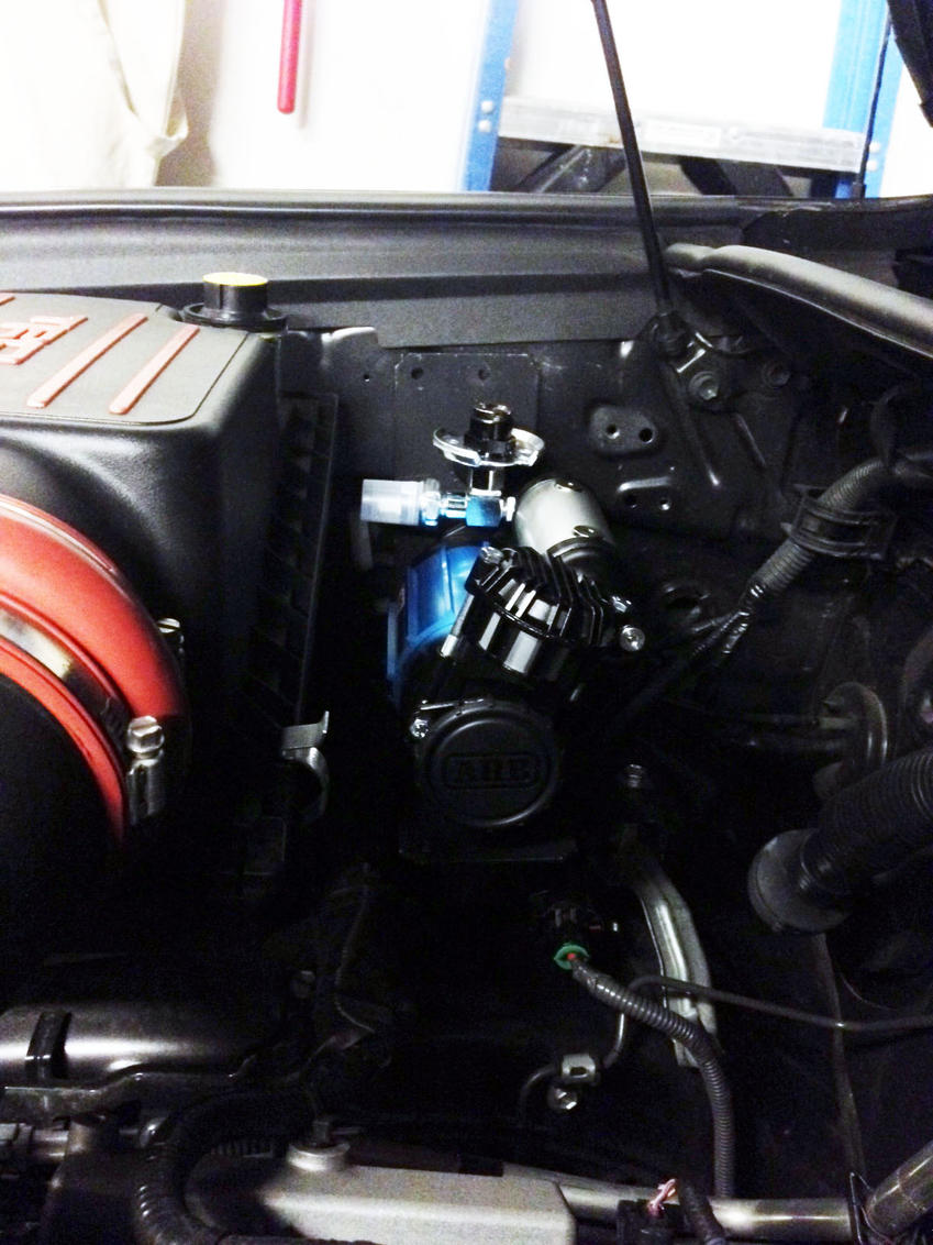

The compressor on to show spacing
This thing doesn't move at all...will wire it up this weekend along with IBS system. :clap2:
