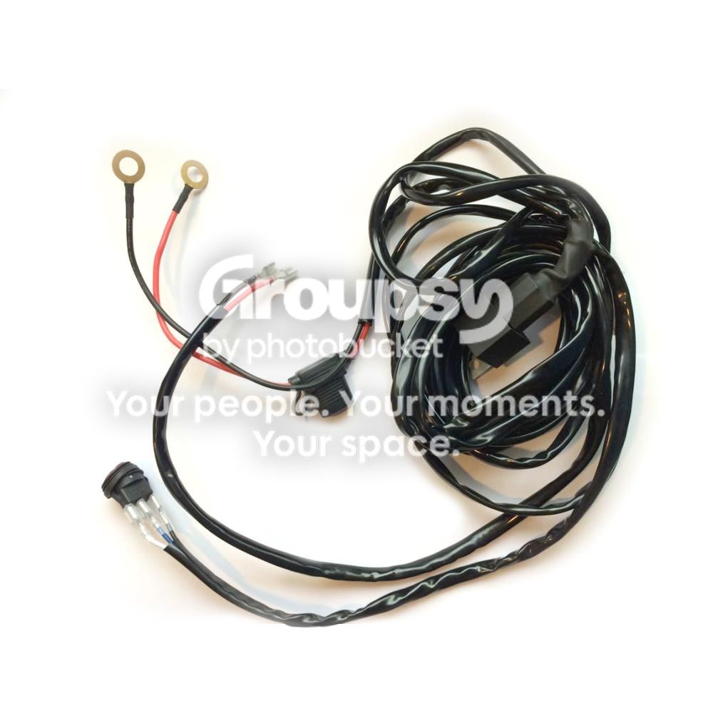

The picture of the actual harness is:

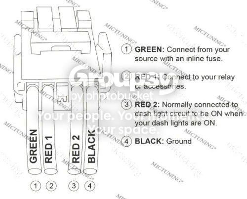

And the switch diagram is:
So I guess my question is, to what wires on the switch do I connect the blue and white wires on the harness. I assume black is ground and they are to be joined. Would rather not do anything to F it up so just seeing if any of you good people can steer me in the right direction.

No way to tell from the information you posted.
You need to connect the blue and white to green and red1, but it's unclear which of the two is source power... Easy to test though. Just connect up the other end of the harness and use a multi meter or tester to see which wire is hot. That one will go to the green wire on the switch. Red2 needs to go to your dash light circuit (I can't remember what color those are under the dash but a search should work)
Illumination Dash Light Circuit = Green Wire on the Wiper Warmer Switch
OK so just got off the phone with a Pyle engineer. Black is ground obviously. Blue is dash illumination for when the dash lights are on. White is power. So I will attach black to black. Then Blue from the Harness to Red2 on the switch. The question becomes, I have an inline fuse and relay so which one of the wires (green or red1) do I connect to white on the Harness? I think that I would wire white from harness to red1 since there is a relay between the switch and light bar. The inline fuse goes from battery to light bar....

OK, the top one is the OEM wiring harness that will attach to the back of the new switch.
The next 2 are the one that came with the pyle wiring harness.

So the factory red2 goes to the pyle blue, the black wires will get spliced together.....so the only question is which one of the two remaining factory wires will join with the white from the pyle harness. Apoloigies if i made this way too complicated.....I tend to overthink things but just want to be sure.

What he told you does not sound right. There has to be a wire going to the relay. It's probably blue. One will be hot all the time even when the switch is in the off position (most likely white) This is the wire you want to go to green on your new switch.
There is no way for that harness to deal with dash illumination (based on the diagram...). You will need to pull that wire from one of the factory switches as described above.
Go back and read my first post and the one below it. That is all the information you need. A cheap multi meter will cost you almost nothing. This will be required unless you just want to trust that the white wire is power. Considering he gave you other misleading info.. not sure I would run with it.
OK, so I got out my multi meter. White is hot when connected with switch turned off (lights off). Blue is hot with switch on (which also illuminates the switch button). Black is ground.
I have thoroughly confused myself but I think it would go like this:
White from Pyle to red1 factory
Black pyle to black factory
Red2 factory tapped into green wiper warmer switch
Blue Pyle to green factory
Am I correct in this?

Nope,
White P to Switch Green
Blue P to Switch Red 1
Black P to Switch Black
Green wiper to Switch Red 2
Its really simple (white is always hot) that is your power source to trigger the relay. Blue goes back to the relay. The switch is NormallyOpen. A relay is nothing more than a remote operated switch. It only requires a very low amp draw to activate it and can therefore use very small wires with concerns for heat or voltage drop. If you simply touch blue and white the relay will trigger. That is all your switch is doing with the addition of an internal light that activates...
Ah well, I had a 50/50 shot. Just glad I asked. Thanks a ton for the help
It actually would have still worked reversed.. But it may have caused problems with activated illumination depending on the switch. Best to just do it as specified by the switch mfg.
