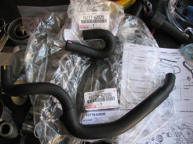

I would change the upper and lower rad hoses and you might consider the oil cooler hoses as well. They are a pain to get to but in a bad place near the exhaust. So if they have never been changed you should probably do this.

I plan to change the radiator hoses as well as the radiator when I do mine. What kind of shape were those oil cooler hoses in when you pulled them off? I've seen a few posts about them, but not a lot. I don't recall anyone having issues with them either. I would just hate to replace them and have an issue with them because I messed with them. I think that's my mindset for the cam and crank seals as well, if they aren't leaking when I get in there.
I have changed mine out, but did it by removing the alternator and going through the wheel well. Not fun, but I really only saw a slight advantage (frees up a little more space) to performing this preventative maintenance with no timing belt so I did it at a later time.
