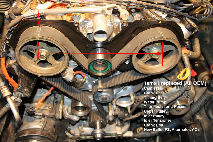

The tension on the belt between the left and right cams are critical to your timing. If you're off a tooth on the belt then your timing will be off. That's the purpose of the timing belt marks. If it didn't matter then you could just slide the belt on "willy nilly". I believe in either the FSM or the Haynes manual they even tell you how many teeth on the belt there should be between both pulleys when at TDC. I don't have the original photo here at work with me or the FSM/Haynes. When I get home I can look at a hi res pic and see how many "teeth" are between both cam pulleys.
EDIT: I hi res pic won't do me any good. Best to go to NAPA or the dealer and look at a new belt and count the "teeth" between the marks.
EDIT 2: This is pic from my rig. I did my belt about a year ago.

i know the slack in the belt should be towards the side of the tensioner. both cam gears are at 12 o'clock and the crank is also at 12 o' clock. so as long as they are all correct still when i pull the pin out it should be fine correct? i can turn on the harmonic balancer bolt to make sure everything is still correct after i pull the pin. these are non interference motors so it should cause no damage. the markings on the belt are just there to give you an idea if everything is correctly done. correct me if i am wrong?
Non-interference - exactly our point. You won't know if you're off or not until you start it up and it pings and detonates because your timing is off. You're dealing with a finely tuned DOHC with a belt that has less than 0.1 percent total length change for a reason.
The purpose for the marks on your belt is to POSITIVELY ENSURE your cams are in tune with your crankshaft. The last pulley to install...for a reason...is the #2 Idler pulley. Hopefully you replaced your WP, #1 and #2 idler pulleys during your recent belt change.
I'm home now and the Haynes manual clearly states on 2B-8, item 17 - "If you plan to re-use the timing belt and the marks were worn off, place a new mark on the belt at the EXACT location of each timing mark on each sprocket..."
Your call... I would drive to NAPA, bring my own belt with nail polish, order a belt and absolutely mirror the marks exactly. That's if it were mine. It's not. good luck
I have to disagree with this. The marks on the belt are an aid to getting it right the first time, but they are not indispensable. The POSITIVELY ENSURE part is when you do the final check after rotating the CS twice after pulling the pin, and the belt marks are irrelevant at that point. If the hard marks line up then, it doesn't matter how you got there--you have it right. If I had a belt with no marks, I'd just go ahead and do it without them. I'm sure I'd get it right. Haynes can suck it.
yeah i don't see how the belt markings can THAT important. i know the belt is facing the correct way is that makes any sense. like i know i don't need to take the belt off and reverse it because of the markings i did last time.
that does sound like a good idea with taking it to a parts store/ toyota and matching it up. i didn't replace either pulleys as they are fine and this timing belt will be replaced much earlier than the recommended milage/years. this truck has been a project for way to long and i just need to get it moving right now as i am moving 1,300 miles in a couple months
i did replace the water pump and thermostat
Agree with Durk. I never use marks on TB, they are irrelevant. I think it's tons easier to just line up the crank and cams, then put the belt on tightly from crank around counterclockwise and end at the tensioner. Sometimes I turn a cam 1/2 tooth counterclockwise to help give a little slack toward the tensioner or 2nd cam (passenger side). You will find that putting on the belt is much easier. In fact, some vehicles you have to do that in order to get it timed correctly (Acura Legend).

For the record, my comments in this thread weren't about T-belt marks. Rather, they were about the fact that a competent Mechanic would know the answer to the question. I've seen some cheap, and/or counterfeit T-belts that had the timing marks wrong. Also, T-belt marks even if they are placed correctly, wear off over time.
The timing marks on the cam(s) and crank are the determining factor. As long as those line up at TDC every time, the cam timing is correct. Any competent Mechanic would know that.
