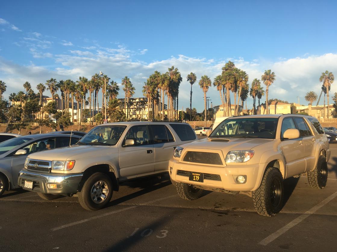

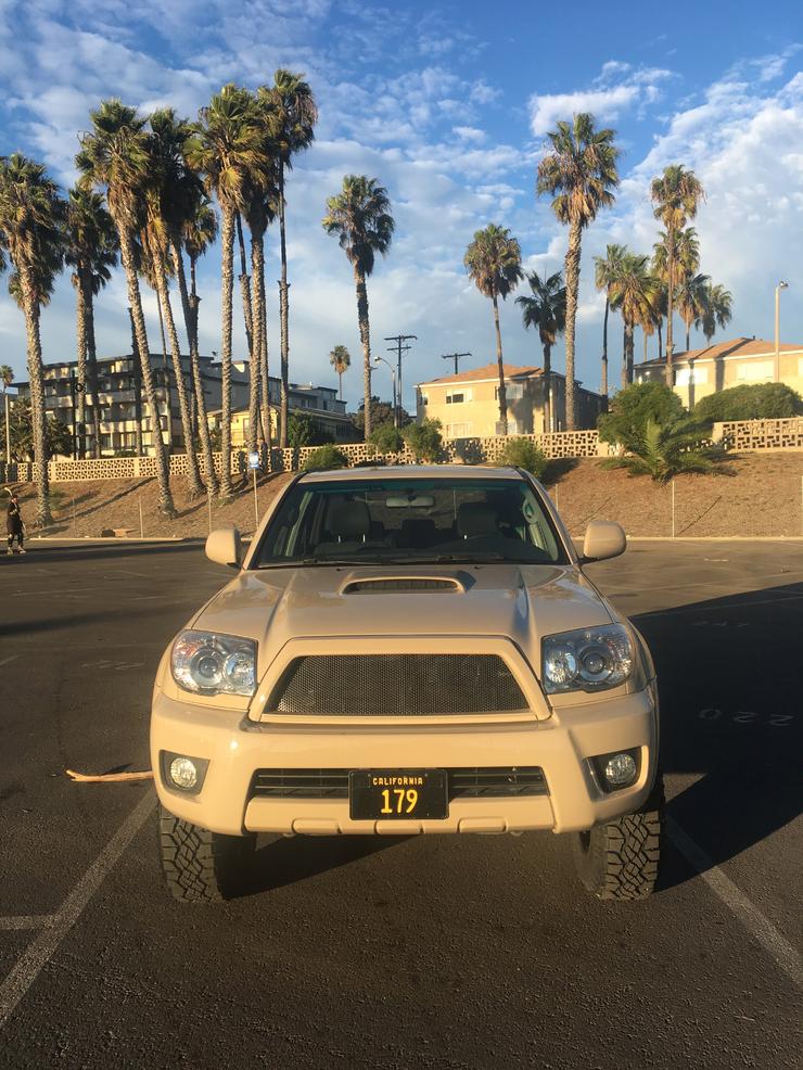

I got the Tacoma kit, it was incredibly easy to install, took maybe a half hour. Just had to drill one hole in each fog pocket and then connect everything up. If you want the exact part number for the kit, let me know.
I have the Squadron Pro lights, and they put out a TON of light. I have the mixed flood and spot lens, so it throws a low-wide beam and then a spot down the road.
That said, if I was going to do it again, I might use the Squadron Sport lights. I pretty much cannot use my lights on the road if anyone else is around because they're too bright. My friend at Baja Designs uses the Sports and he can run them full time. Ultimately, I guess the choice depends on what you want to use them for. I wanted them for off road use only, so I'm good.
You can see where I had to drill a new hole further back in the fog pocket to mount the Baja Designs lights. I then sprayed the whole pocket black.

I used this kit from Baja Designs: LINK
Short version: I removed the stock fog lights, I drilled a new hole about 1 1/2" back from the inner hole (which you can see in the picture above), then mounted the new lights in the fog light pockets. As you can see from the link above, the kit comes with two black plates to mount the lights to. Each plate has two "ears" that are 90 degree bends. You use bolts to secure the plates (with the lights attached) in place.

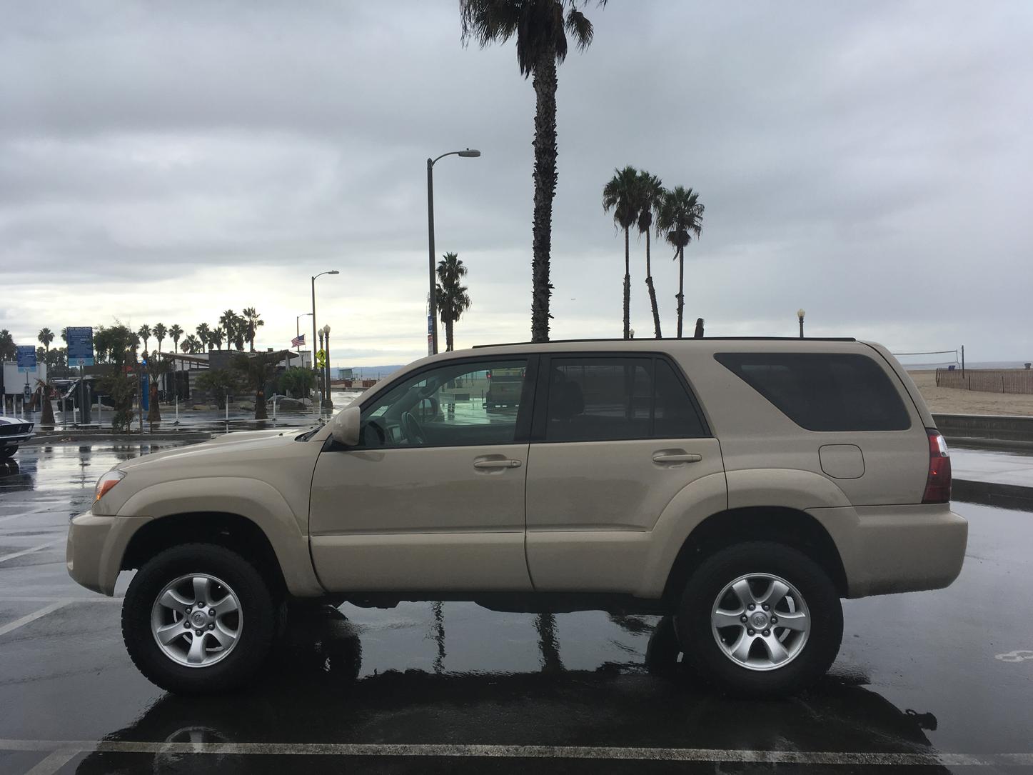

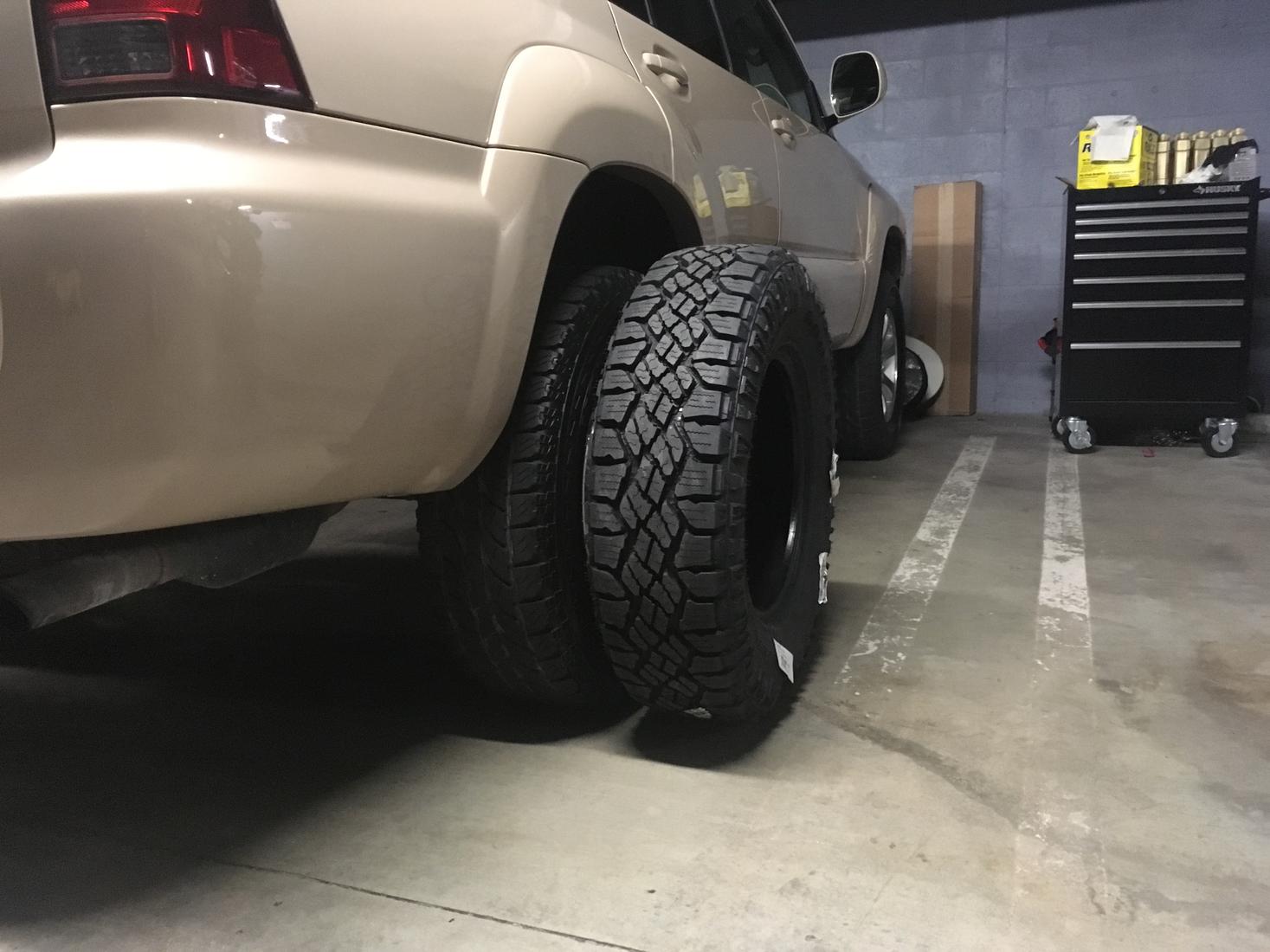

Interesting that the 32" Duratrac looks so much taller than the 31.9" Geolandar. A few 32nd's for wear and the truck's weight prob account for the difference? Duratracs are .8" narrower and 2lbs lighter. Can't wait!

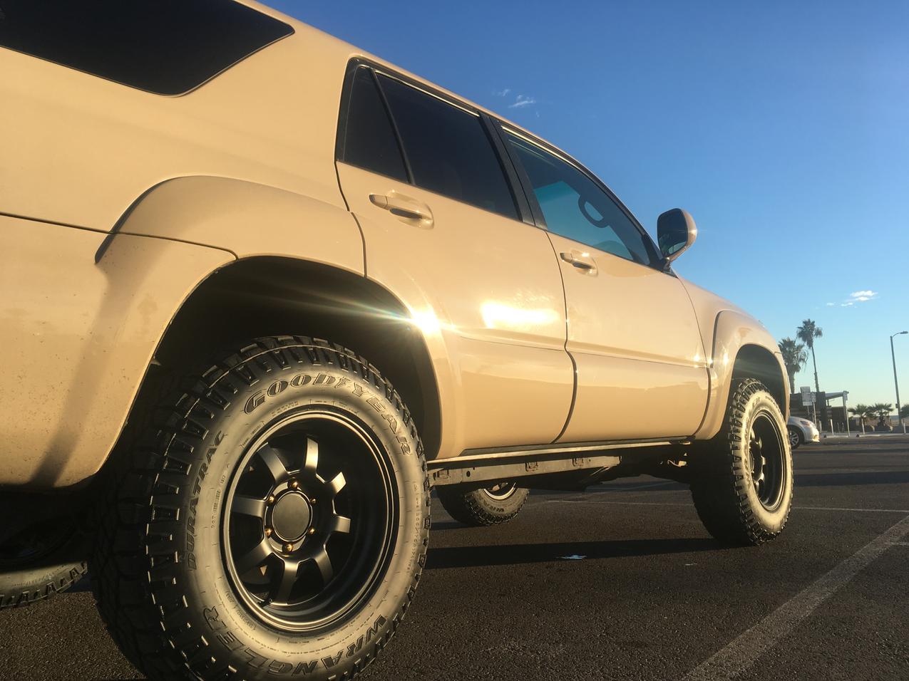

FNW FTW. Konig Verge 17x8.5. Great customer service made the decision easy. Got exactly the offset/backspace/tire poke I wanted too.
The 255's are legit. They are a little louder than I expected based on reviews but I love them and it suits the truck well I think. Louder than my Geolanders (faint noise) and much quieter than the BFG MT's (loud). Such a subjective thing..hard to anticipate until you hear it.

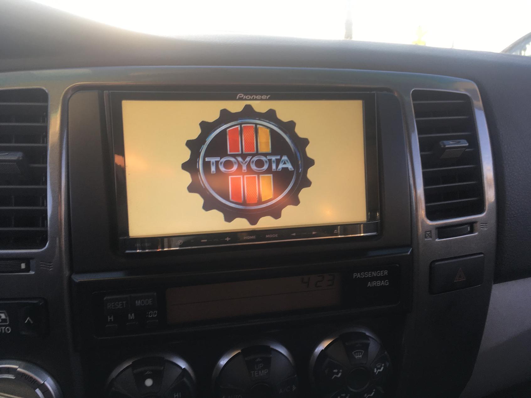

I think I'm going to keep the outside clean. Might consider one for the front grille but for now just the splash screen

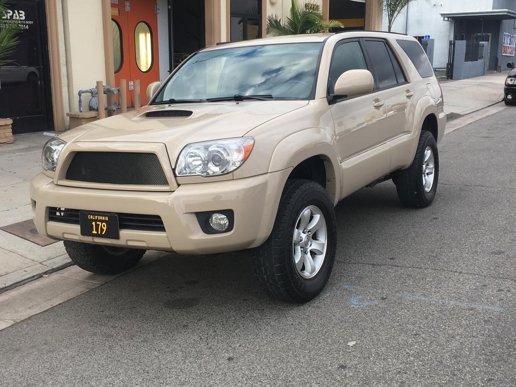

Tim, the wheels look good! What offset did you get? I want 17x8.5 next too your poke looks good, except I have 265/70/17. I like how the 255's look, I'd go for them too except that's a rarer size in most tires and I got a deal on the Nitto Terra Grapler G2, good tire, not too loud either.
Thanks! I'm loving them. Specs are 17x8.5" -6mm offset (4.5" backspacing) 6x139.7 PCD. Same specs for [MENTION=85422]FNWheels[/MENTION] Overlander and Five Star I think. Dustin feel free to jump in if you're watching. And thanks for dealing with my OCD and helping me find the right specs!
I was a little nervous about 255's on 8.5's but it's within manufacturer recs and I think it came out great :)
Just picked up some 255/75/17 Duratracs from Discount Tire! Thanks Matt! Anyone have experience with these in the sand?
Can't speak for the 255s, but the Duratracs are great in the sand. Mine are 285s. Went to Pismo a few weeks ago, aired down to 20 psi, no issues. Color looks great BTW.
