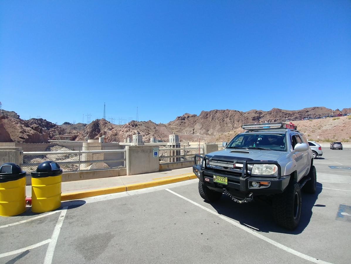

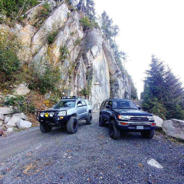

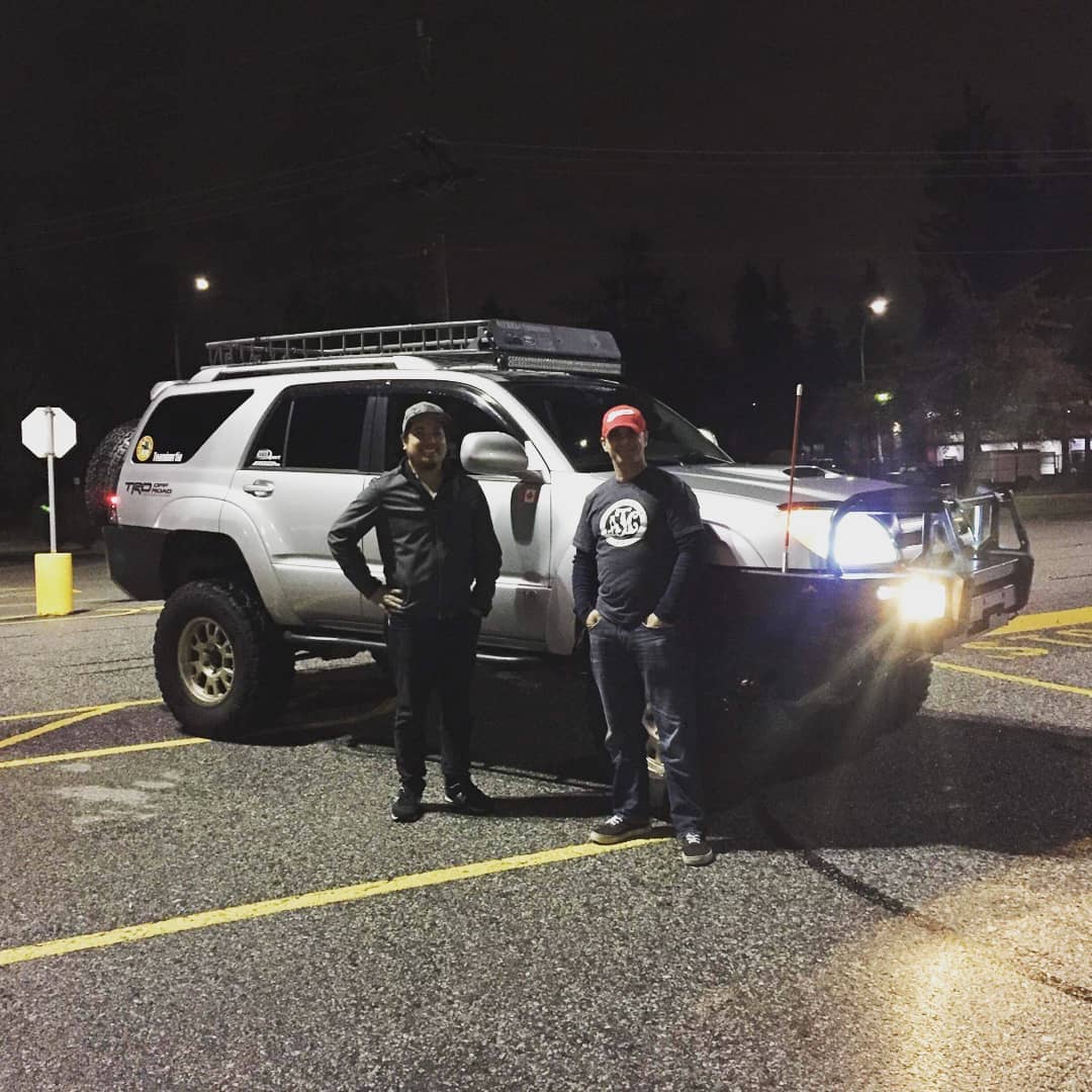

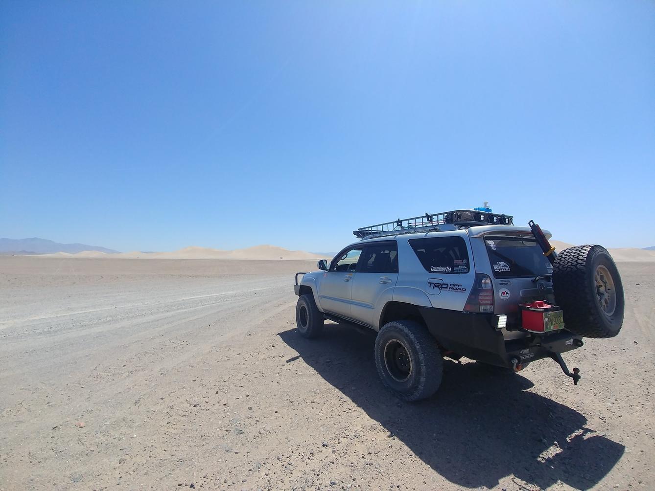

Well, the time came & sold the 4Runner. I enjoyed having the truck. It has been the best vehicle I've owned so far. It has taken me through some awesome road trips never had issues. BC, Alberta, Washington, Oregon, Nevada, Idaho, California & Arizona.
I'm gonna miss that V8 grunt!
