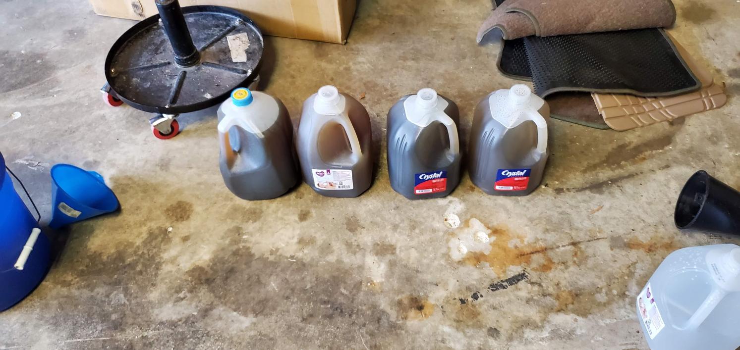

I purchased a new Denso radiator, and I was planning on flushing the old system before installing the new radiator. But I can't seem to get the system clean. I have ran distilled water through it multiple times, and the coolant comes out black. I've gone through about 10 gallons of water. This is 4 flushes worth...

did you run a detergent (flush cleaner)? Might help speed up the process a little. I think I was clean on the 5th or 6th flush myself.
I did, I ran 3 bottles of the stuff. Usually ran them for a week each.
How much are you getting out with each flush? Two gallons-ish hopefully? Might speed things up by draining the engine block too if you're not getting a couple gallons each time. Capacity is 8.5-9.5 qts

Yeah, I am getting about 2 gallons each time. I'll see if I can find that block drain next time I drain it.
it's not oily stuff? hope it's not engine oil or atf that has mixed with the coolant. clean atf is red but if it's burnt, it can become black or dark brown
You can buy a flush kit which allows you to splice a garden hose into the heater hose. Run the engine while running the hose with the radiator cap off until it run clean. Then open the block drains to empty out the lowest point.
I wonder if someone had used a leak stop product.
the block drain is located on the RH side, between the 1st and 2nd cylinders. you have to undo the drain cock (bolt) then the coolant will flow from the union drain just below the drain cock (bolt)
That could just be a week's worth of rust then. I wouldn't freak out too much about it (yet). Get some good quality coolant in there and see if it changes color quickly.
