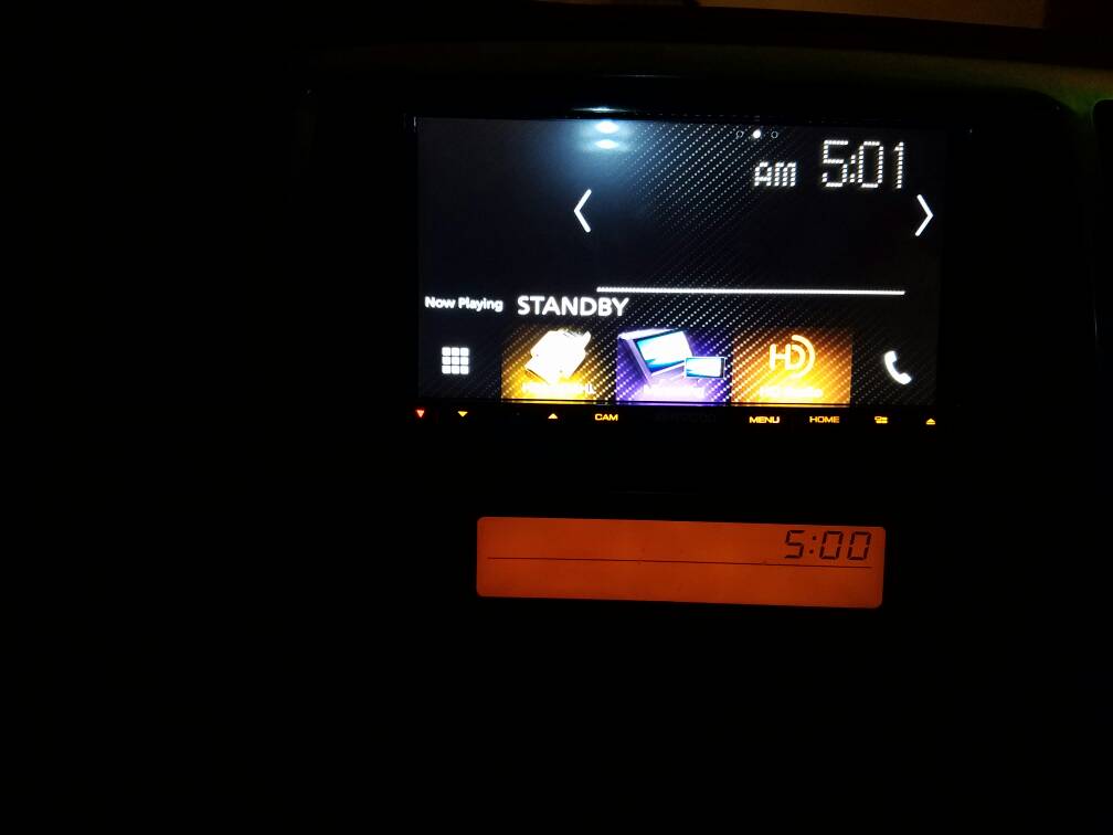

Just upgraded to a Kenwood DDX9703S. Gonna swap out the stock speakers for some Kickers nextView attachment 1
Sent from my SM-G930T using Tapatalk

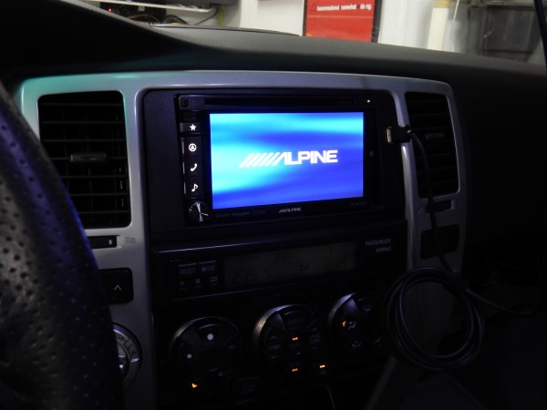

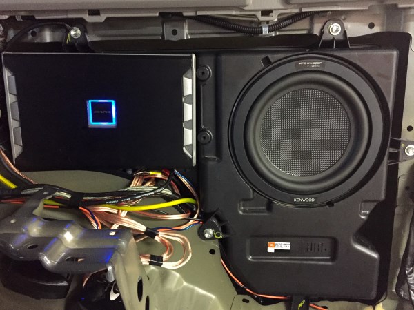

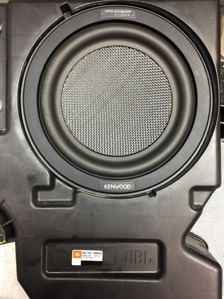

Okay so I'm about done my install.
My trusty Alpine IVE-S920HD from my 3rd Gen.
Old school Alpine 6022GX tweeters with current SPX-17PRO mids.
Alpine PDR-V75 5 Channel amp. A little tight so just had to Dremel one of the plastic mounting ribs.

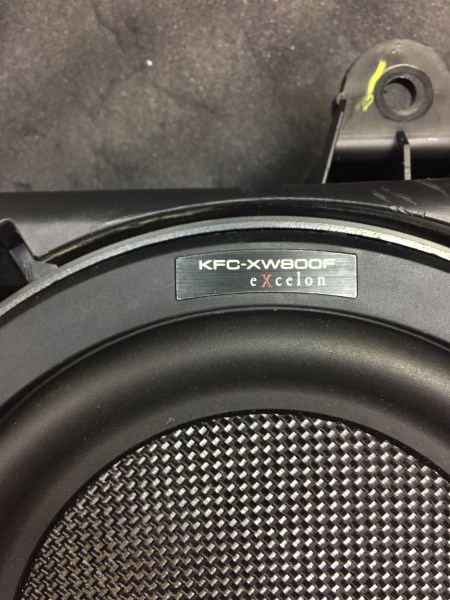

Kenwood KFCXW800F shallow mount sub.
The sub is a single 4ohm coil. Perfect fit. Drops in with no modifications at all!

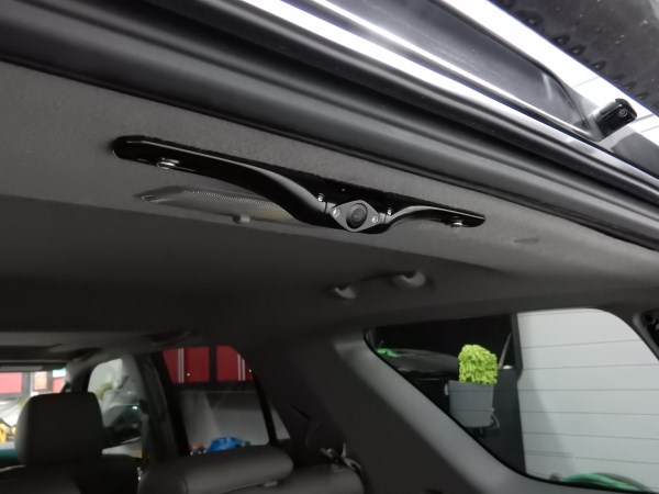

For the back up camera, I used a swivel plate type and like my 3rd Gen, mounted it inside.
You have to reverse the camera as its mounted upside down and aim it downwards.
The camera never gets dirty and if the window happens to be really dirty, simply roll it down a few inches.
Center channel speaker removed and under the grille instead is the Sirius/XM & GPS antenna.
Total stealth install.
