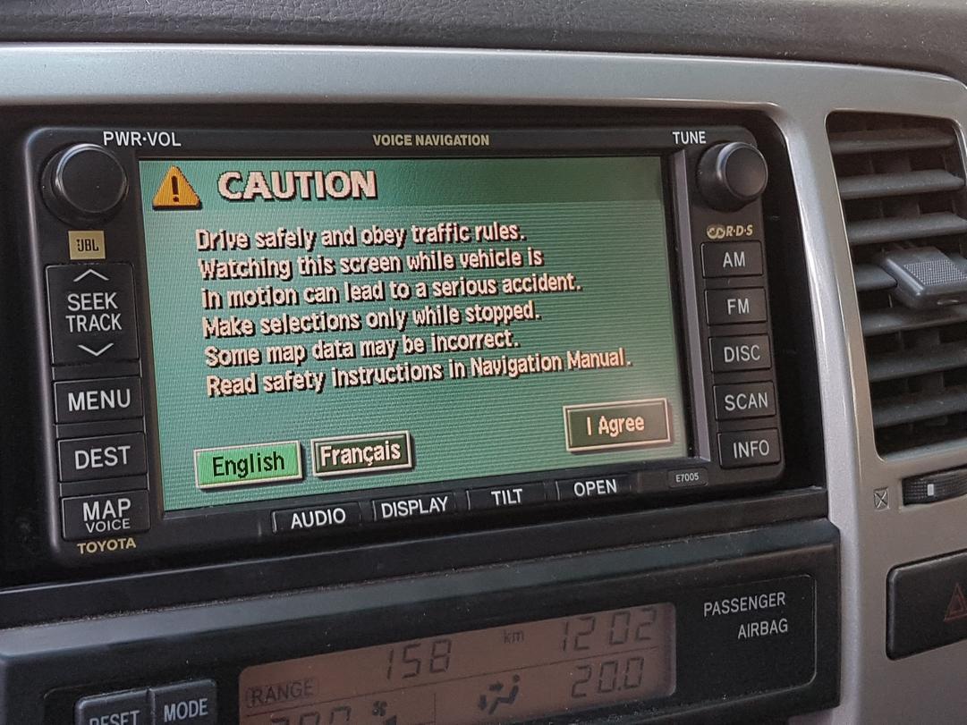

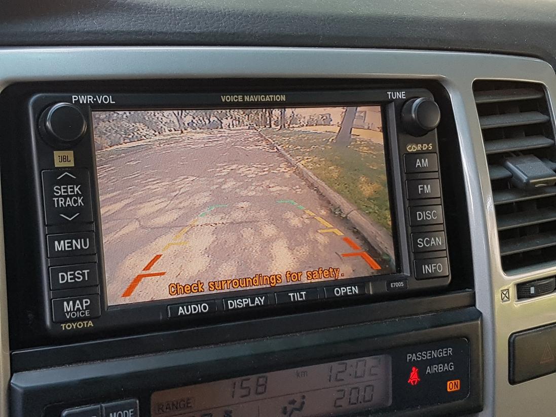

Added a E7005 I found online for cheap $200CAD, Added back up cam as well.
I Heard complaints about the gap in the dash it doesn't bother me at all as i thought it would from reports on here.

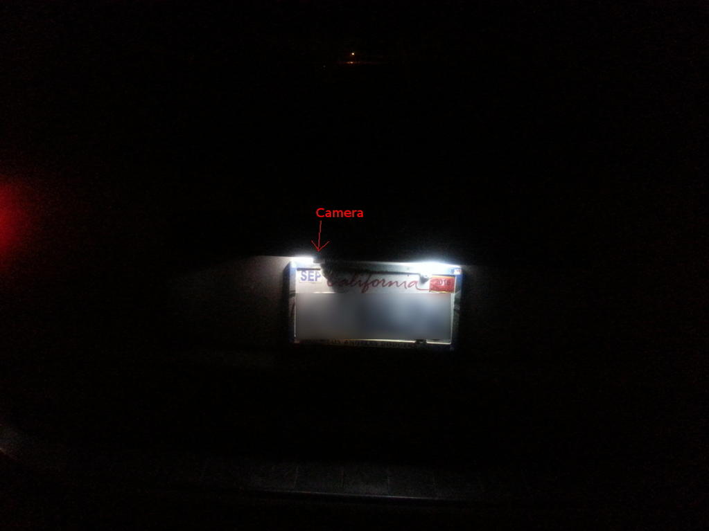

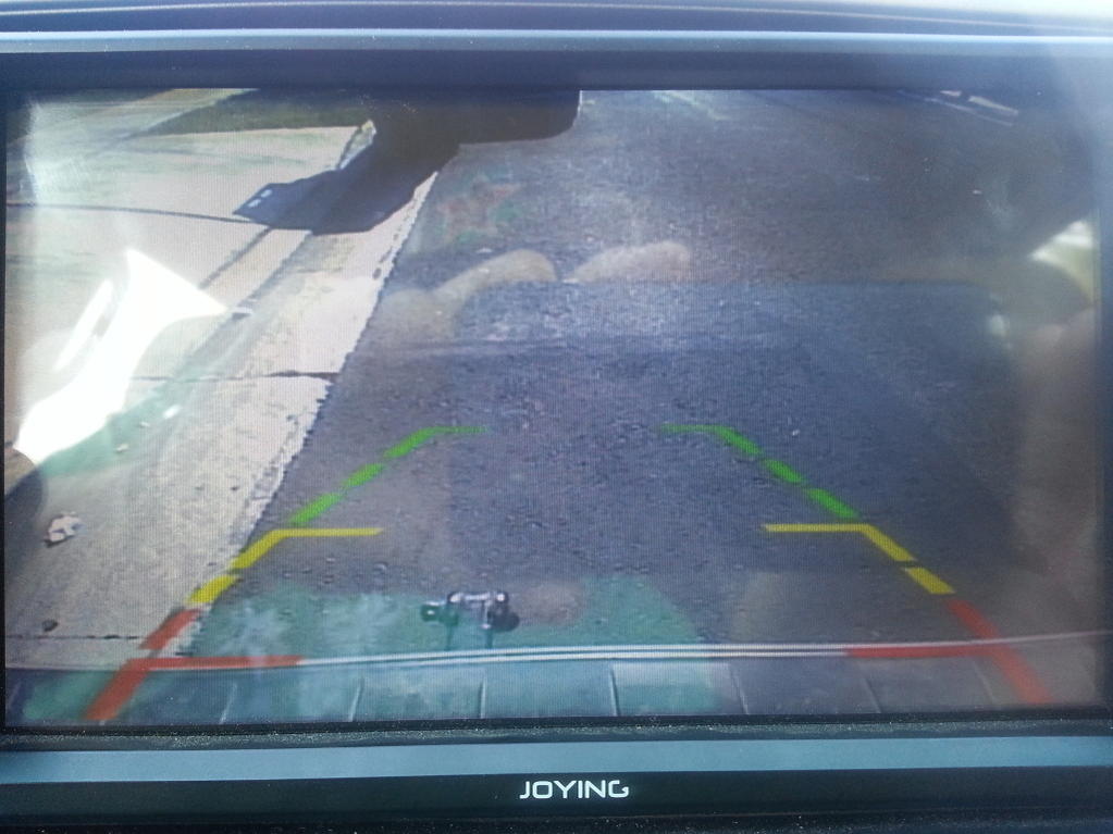

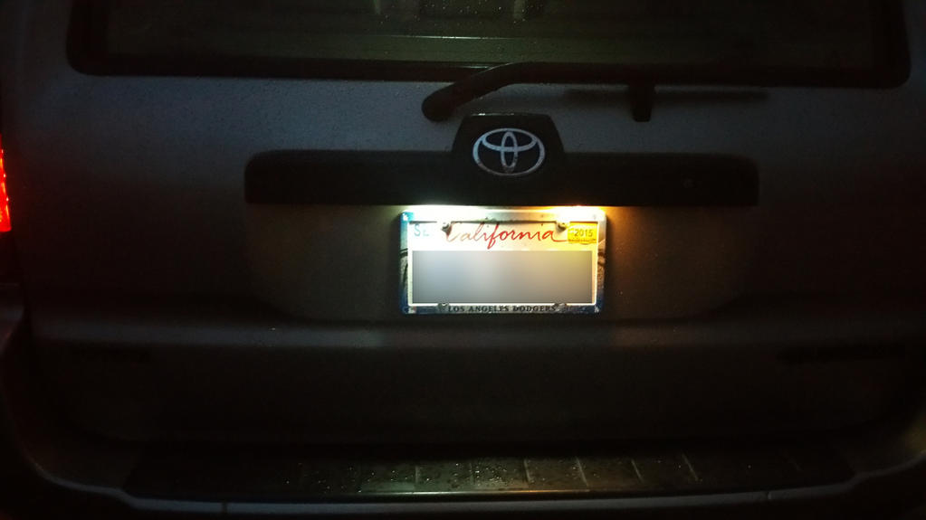

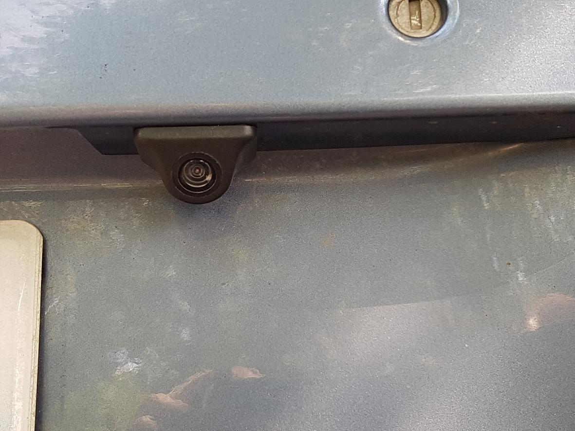

As promised and only a week late. Quality is poor as I'm using my old cell phone atm. This camera allows me to put my bumper within an inch of an object.
Photo #1 shows OEM license bulb(Right) vs LED Swap(Left)
Photo #2 shows LED Swap(Right) vs backup camera LED(Left)

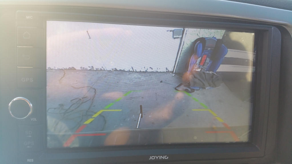

Photo #3 backup camera image as well as the original angle. There is a tool sticking out of my hitch receiver.
Photo #4 After I corrected the angle of the camera by using rubber washer/grommet to keep tension but allowed to me tighten one side and keep the other "loose" but snug. Again my hitch is visible showing you how far offset the camera is by being mounted on the Driver side.

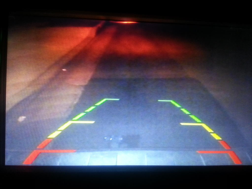

Photo #5 Night comparison. It does have a night vision mode (black and white) but you will never see it due to your backup lights.

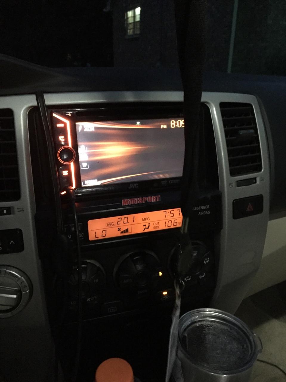

Bought mine with this JVC double-din. Perfect fit, touch screen, and has everything but nav. PO also put in some banging upgraded speakers, need to take one of the doors off and see what's inside. No back-up camera yet, but plan on getting one of the wireless ones to connect to head unit.

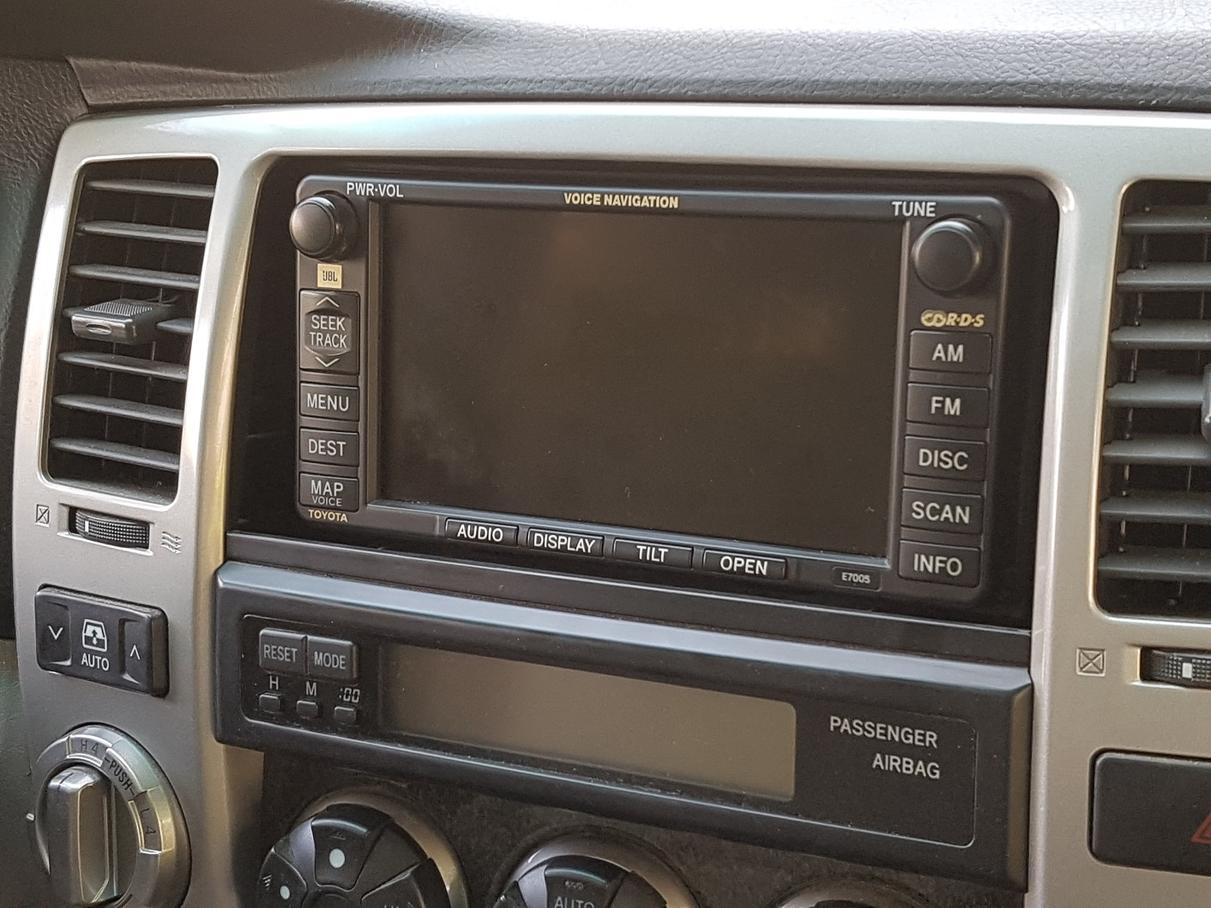

removed the factory navi... I couldn't resist! Pioneer AVIC -8100 NEX
Looks great! I recently installed the same thing and was wondering, do you HAVE to have the navigation antenna installed in order for the time/date to set correctly? It's driving me crazy.
