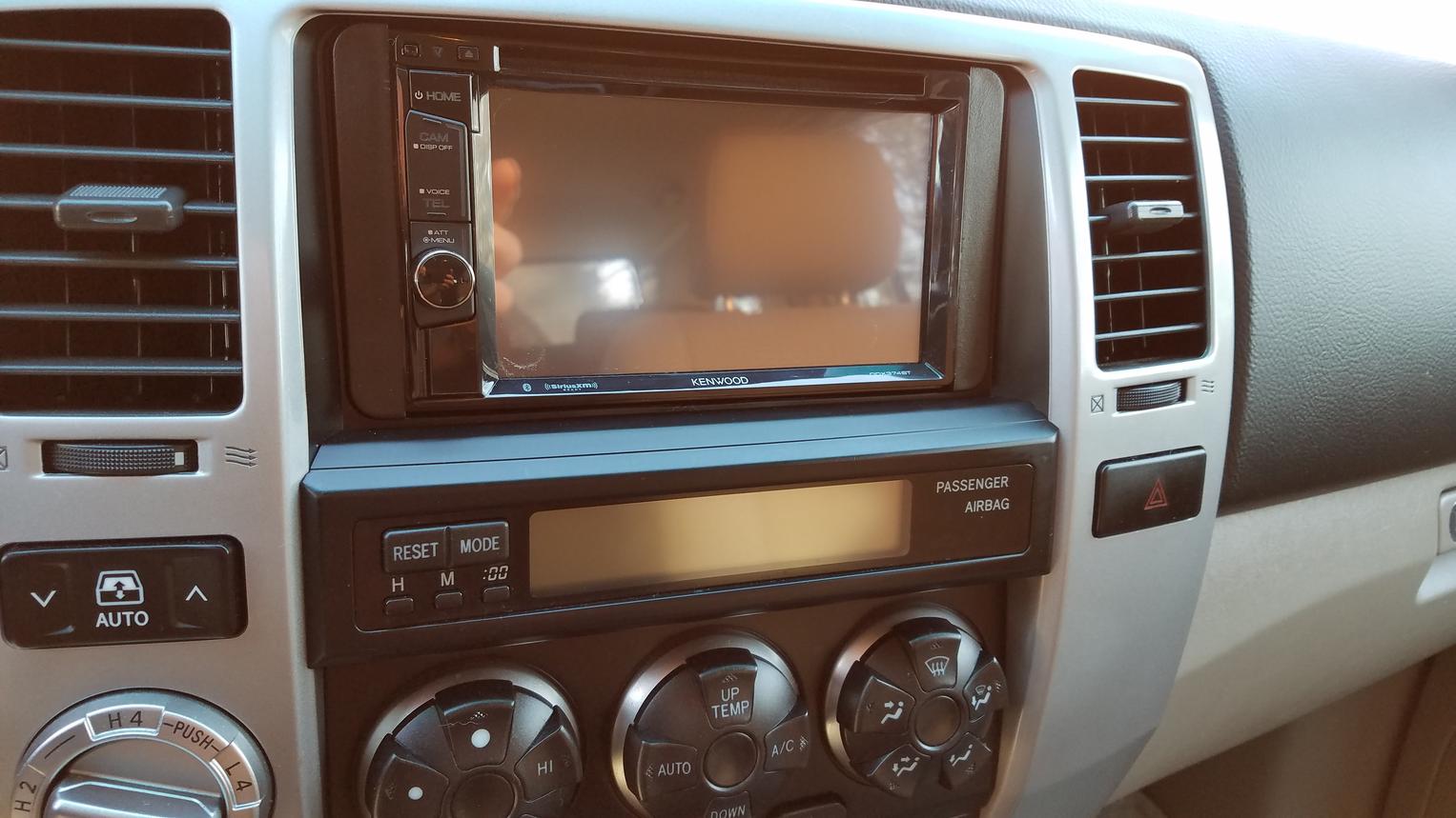

I just want to know if a kenwood touchscreen/dvd receiver fits. So I can put one in mine
Yes....I installed a Kenwood ddx374bt last weekend.....To wire it all up, I used the CRUX SWRTY-61S kit.
