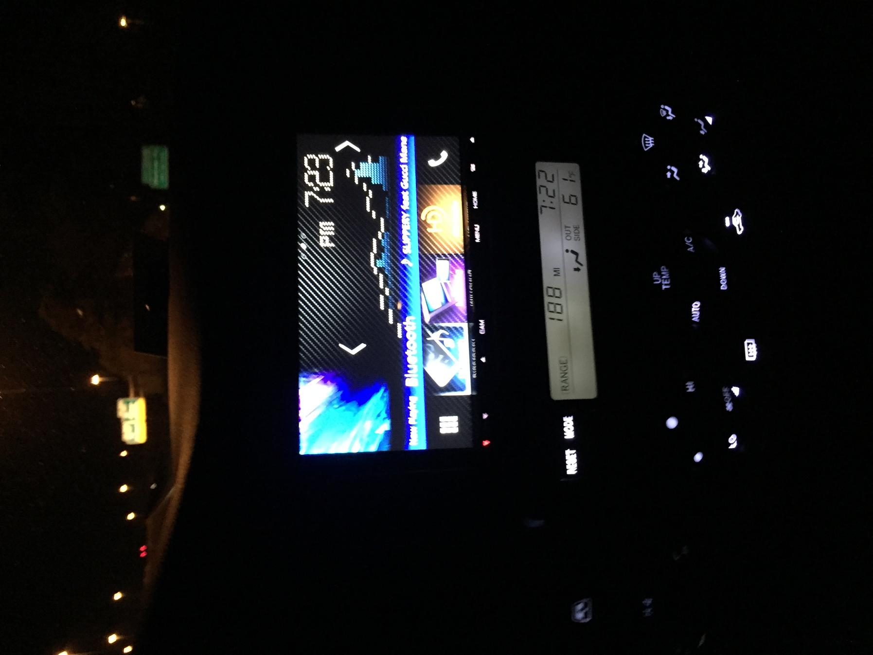

'05 JBL powered E7005 stock nav to Pioneer AVIC-5200NEX via PAC PAC RP4.2-TY11
Hi all, after frantically searching through a hundred threads on here last night about all the various stock configurations out there, and staring at 3 vehicle harnesses with no connectors along with like a million unused PAC harnesses, all I had to do was cut a few wires and got this installed today - everything's up and running except the factory backup cam - waiting on a cheap harness to arrive.
PICS: '05 4runner V8 limited factory JBL powered E7005 swap for Pioneer*AVIC-5200NEX via PAC RP4.2-TY11 interface - Album on Imgur
I couldn't find a wiring diagram for '05 (and even if I did, apparently they used 2 different JBL Nav's that year so it might not've been right) but I deduced that a gray 5-pin, 3-wire harness in the back of my old HU contained the three dreaded Reverse, Parking Brake and VSS wires, so I lucked out that they were there for me but would've thought an expensive interface would've had a plug for them. I just cut it off and wired them direct to the Pioneer, working great. It was...challenging to fit all those wires and the interface back there, I'm dreading taking it out when the camera cords come... But for now, it's pretty and the sound is above and beyond my expectations.
Apple carplay is ok for music/phone, but for an expensiveish unit I'm disappointed there's not easier video inputs (like USB/hdmi - apparently the 6200's+ have HDMI and had I researched, probably would've ponied up $100 more.
Can't wait to get into the menus and customize everything, all I've done so far is change the lights to match the orange interior. Still need to find a permanent spot for the mic, install the second set of steering controls for bluetooth (the radio ones are working great), hook up the cam and sell the E7005. :trophy:

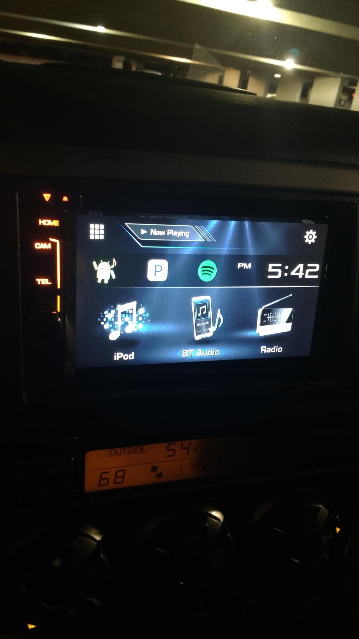

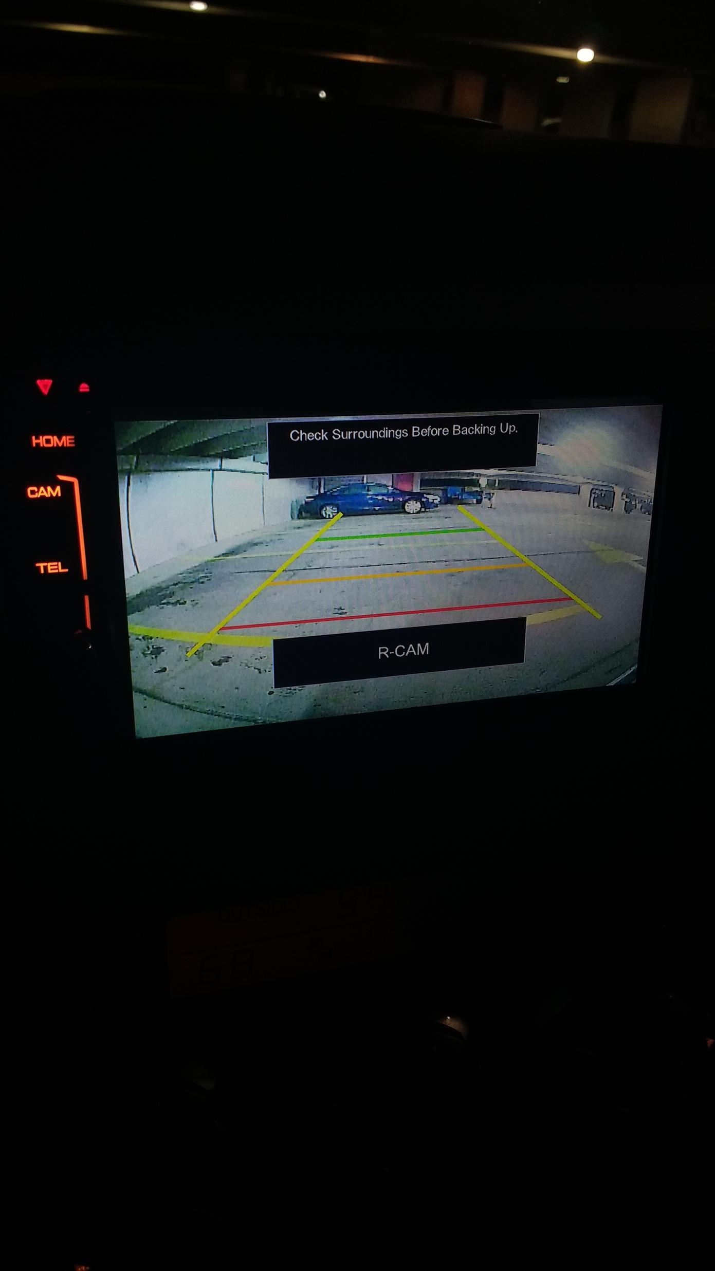

kenwood DDX374BT with backup camera
just got this installed last week, the interface is clean and simple, got the adapters so my steering controls still work too.
