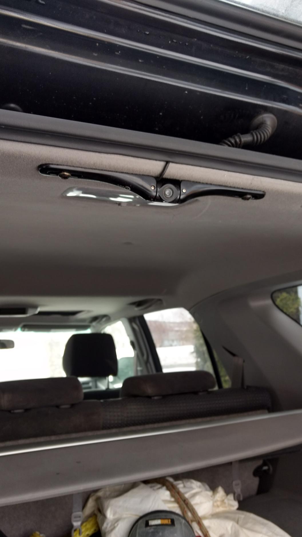

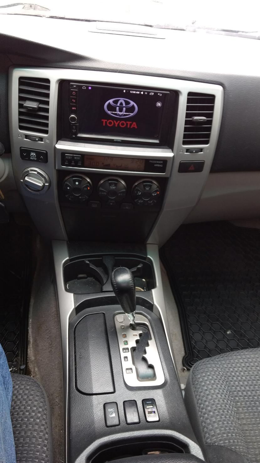

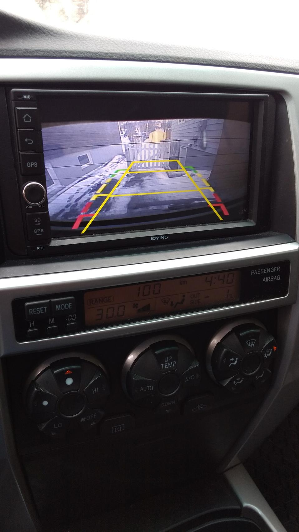

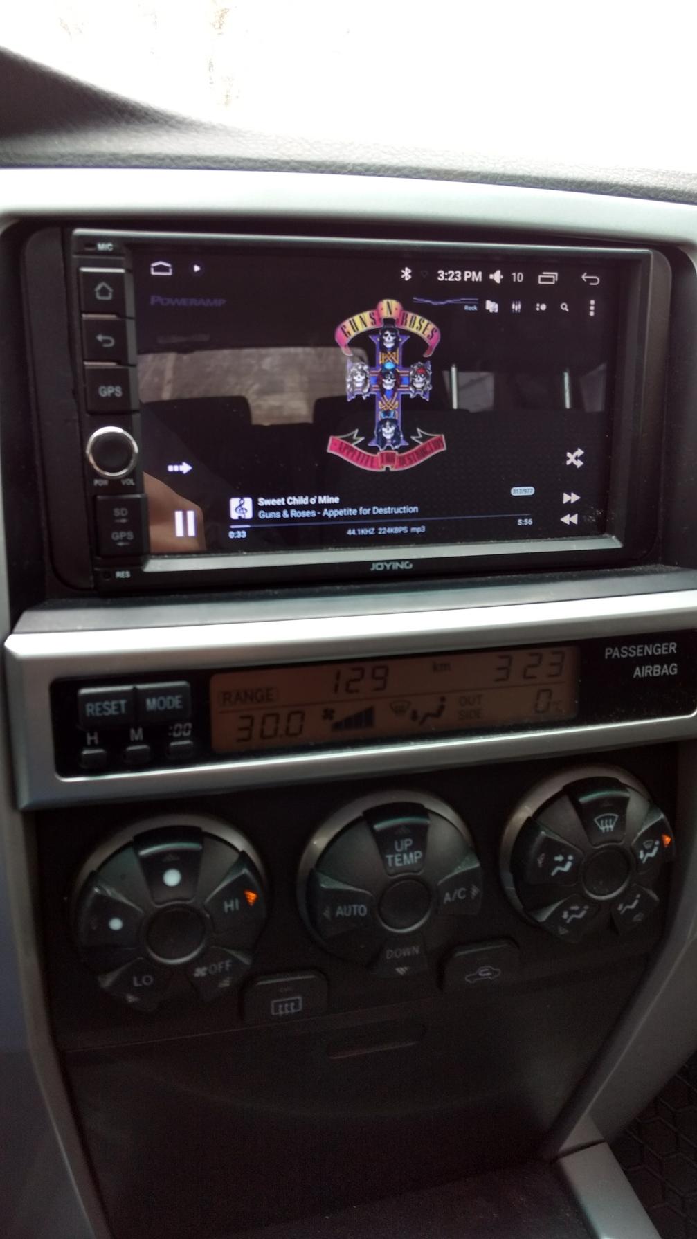

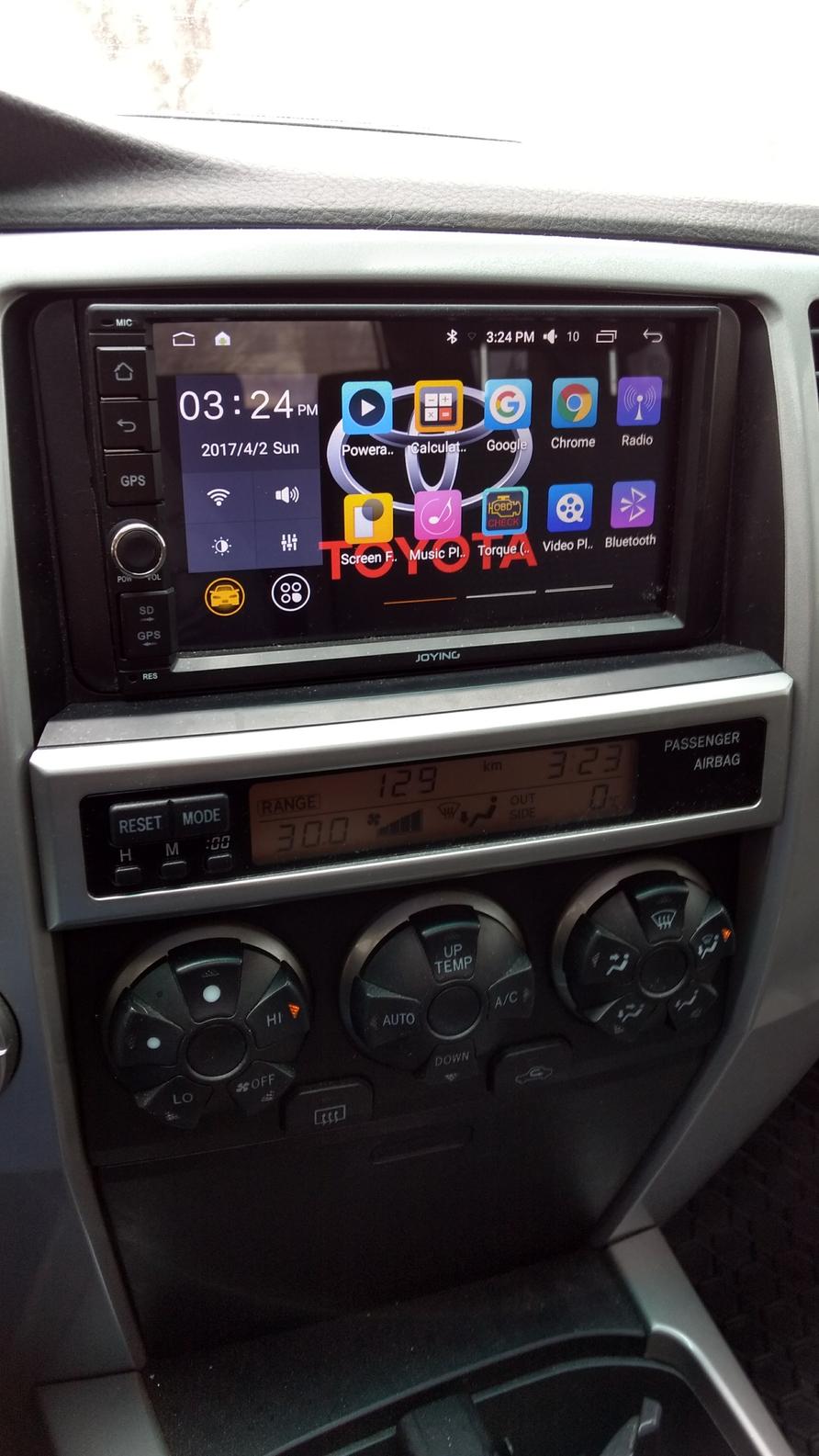

Last week I finished my head unit upgrade. I added a Joying 2GB unit with rearview camera and USB charge/audio port in console. I added the camera on the inside vs the outside. I got that idea from this thread but cannot remember who to give that credit to. Works great and never gets dirty, if the window is dirty give it a wipe or lower the window...genius.
I had the JBL system and used the adapter and steering wheel module. Sounds great! May consider amp and speaker upgrade some time in the future but for now its loud and clear besides there are a ton of great android equalizers to work the sound to your liking. Poweramp is a must!
