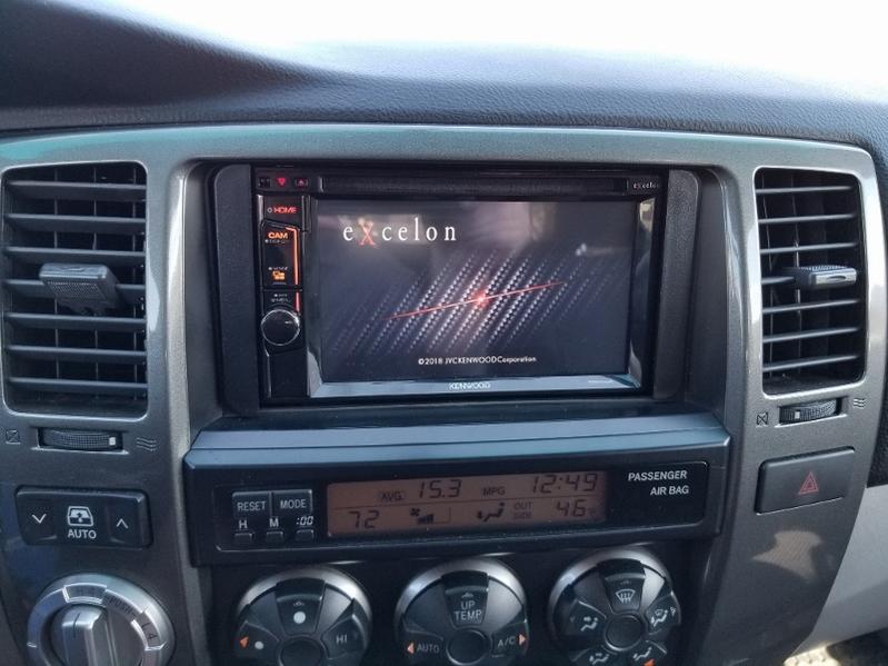

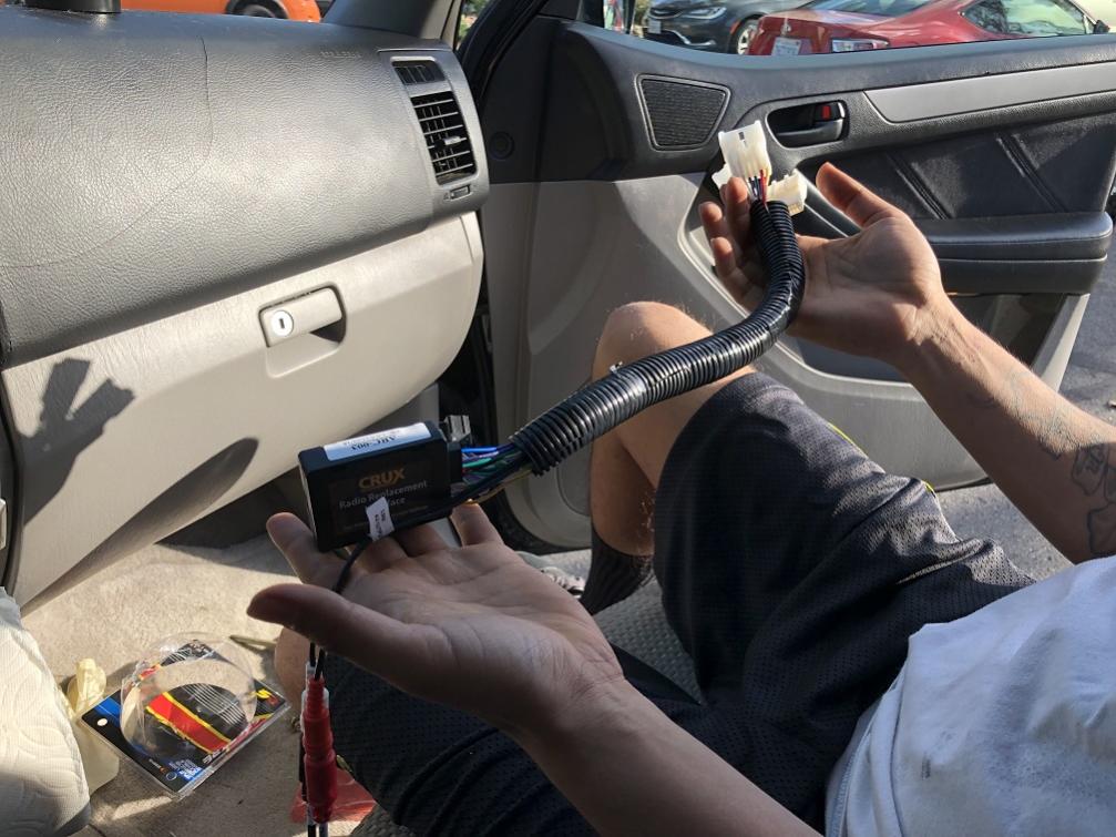

I just installed a Kenwood DDX-595 from Crutchfield with the cheaper CRUX steering wheel controls. I figure I have an ELM BT module and Torque pro on my phone. It can do anything the Maestro can and for under $20.

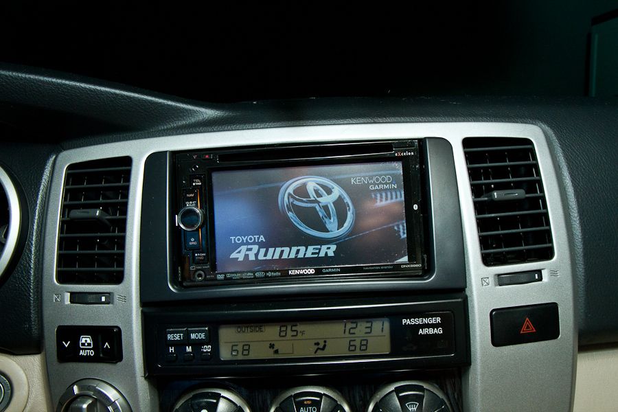

I went with the kenwood ddx6705s, I looked at the same head units, the sony were nice but didn't have the waze app (not a big fan of google maps)and the screen was smaller, the pioneer had the same apps as the kenwood, but I find the touch screen has a little lag to it, seems like the kenwood had a faster processor
I was thinking of the Pioneer, also. But, your post has me looking at this Kenwood now. Did you need the Maestro modules for it? Was there problems finding a dash kit for it?

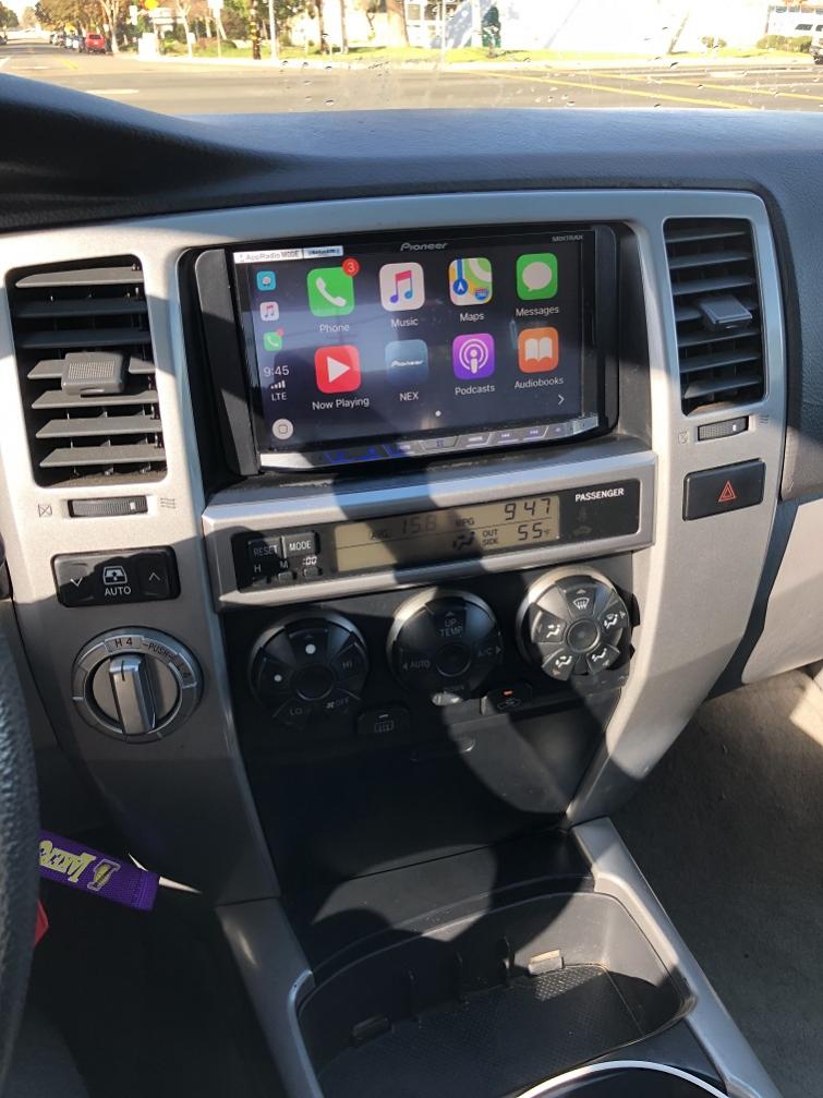

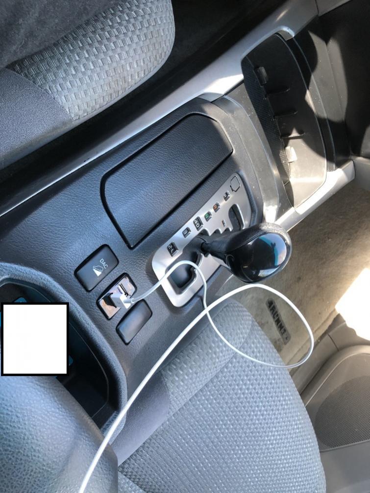

I installed a Pioneer 4100nex that I had laying around (new in box). I am a huge car audio guy... I can tell you right now, do not hesitate to add apple car play to any car you own! As of October 2018, they added support for Waze and it works flawless. I followed Provo Beast tutorial (YouTube) and everything worked on first try. I dont have steering wheel controls but I used that wire harness and just didnt connect that part. By the way this was my first stereo install ever. I also added the USB plug-in next to the DAC button as shown in the video. I am beyond pleased with the result.
If I had to do it over again (and was purchasing a new head unit) I would look into the new wireless CarPlay units. But I would still install the USB charging ports next to DAC on shift bezel. Its nice that it charges your phone while in CarPlay mode.

If you have a unit that supports CarPlay, but isn’t the wireless version, you need to tether your phone through USB anyway, so why not have a clean port, rather than a cord hanging out of the front of the stereo. Even if the stereo supports wireless CarPlay, the port can still charge your phone since the streaming drains the battery quickly. No downside that I can think of,other than the extra time to run the wires and a bit of additional cost.
I think he's referring to the 3.5 AUX port, not the USB port. Seems unlikely that there would be much use for the 3.5 ... nice install though.
