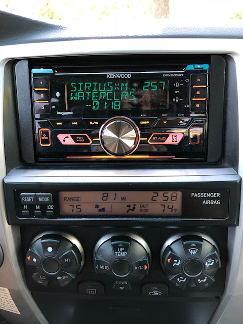

I went a more basic route. A Kenwood DPX503BT, with XM, Bluetooth, Spotify, Pandora, etc. Pretty easy installation and sounds great!
