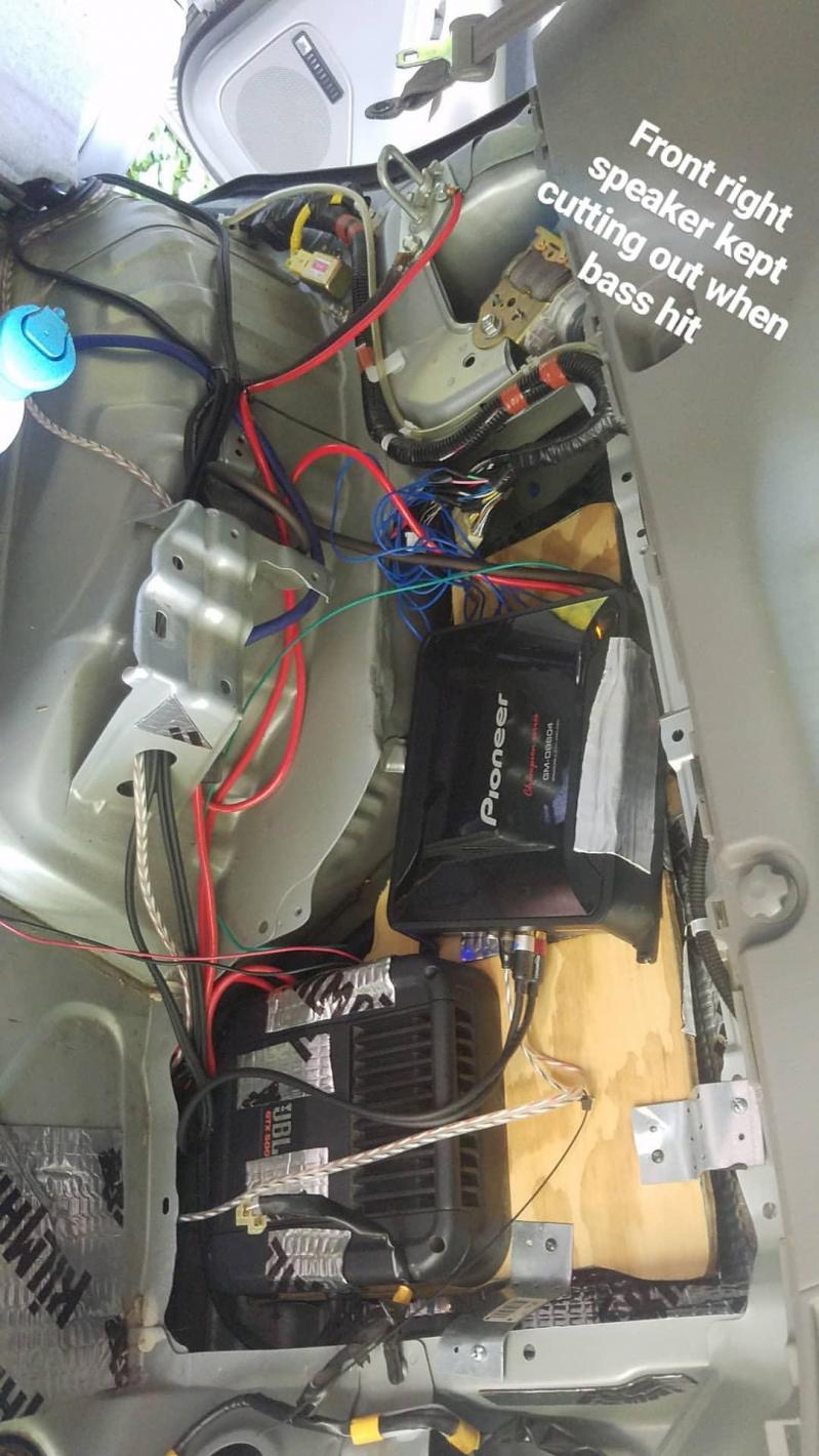

Dual Amp Setup
Hey guys,
I replaced my head unit, amp and speakers 3 years ago with a 7-speaker system I pieced together. The specs:
HU:
Kenwood DPX502BT It was the cheapest good-looking 6 channel amp I could find. I did not have the budget to spend on a touchscreen at the time! The only complaint I can even think about is that the screen is dim mid- day.
Monoblock Amp:
JBL GTX500 500W. Cheap, reliable and high enough power for me!
Subwoofer:
Kicker CompVR 43CVR124 12" Dual 4-ohm. It SAYS its rated for 400W, but I can drive my amp all the way to when the protection circuit kicks in before the subwoofer begins to sound overdriven, so either the amp is over- rated or the sub is under- rated. If I had to guess, I would say it's the latter. Its real loud and sounds great
Box:
Sound Ordnance BB12-200V with like 3 Walmart $1 pillows in it. I had a cheap box before and buying this made everything SO much better. Sound quality and volume skyrocketed.
Speaker Amp:
Pioneer GM-D8604 it was easy to tune and can drive all my speakers as far as they can go. This thing has power on-deck for the price and I don't know what more I would need!
Front door speakers:
Kicker 40CSS694 6" x 9" Component Speaker System with Alpine tweeters (the Kicker tweeters didn't make it this far, the woofers did)
Rear Door:
Kicker C coaxials that just do the job and take power alright. The dont sound bad, just not the best
Attached is where I wired and placed the amps. Please excuse the text, it was an instagram story where I showed why my FL speaker cut out (for the first time in 3 years!)

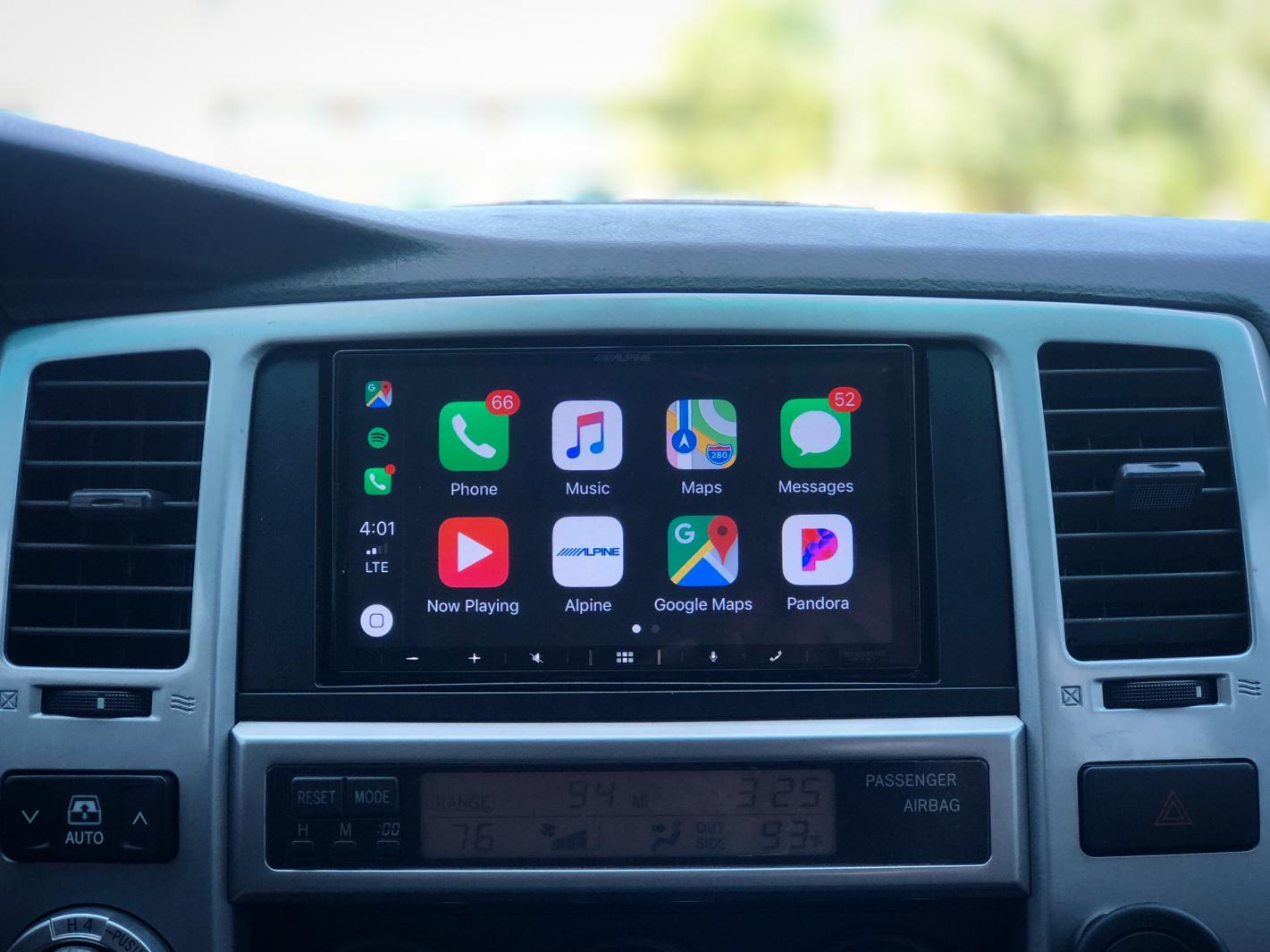

Finished the install of my Alpine ILX-W650 unit I got from Crutchfield and I am very happy with it. I am using the PAC RP4.2-TY11 Wiring Interface and Metra 95-8210 Dash Kit. Basically, everything that Crutchfield recommended for a 4runner with the JBL Premium Sound System. Alpine requires you to hook up the head unit to the parking break in order to be able to access any settings so I bought a PAC TR-7 Universal Trigger Output Module for Video Bypass of Amazon to wire in with the harness and it works great.
With the PAC wiring interface, I was able to wire the steering wheel controls as listed.
Volume Up
Volume Down
Up Arrow: Next Track
Down Arrow: Previous Track
Hold Up Arrow: Answer Call
Hold Down Arrow: End Call
Mode: Mute
Hold Mode: Activate Siri
