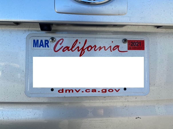

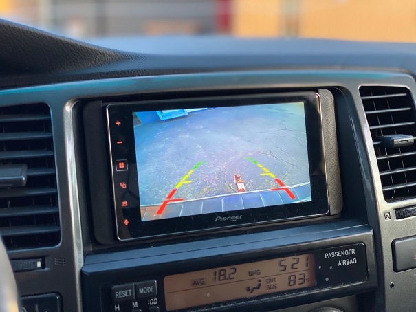

Forgot to mention I added a backup camera so I can catch kids and bikes behind my 4Runner. That must have took 80% of the install effort.

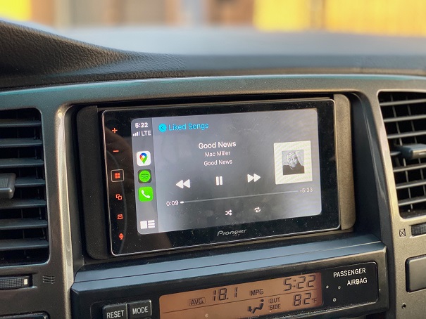

Recently replaced my Kenwood with the excellent Pioneer AVH-2550NEX & couldn’t be happier with it. I placed a magnetic phone mount as shown using one of those removable 3M strips, a solution I would have loved to have figured out much sooner.

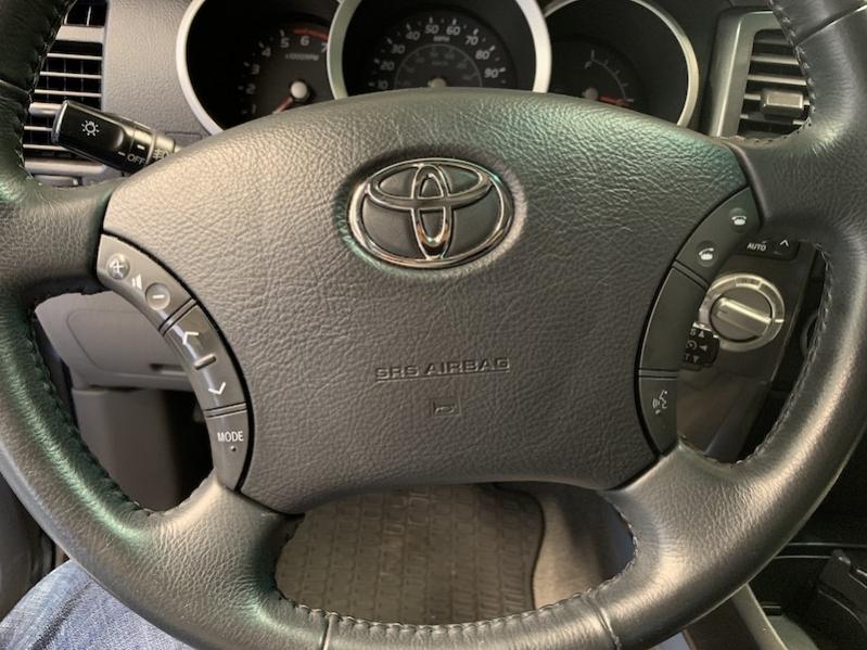

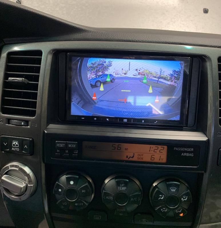

Finished the install of my Alpine ILX-W650 unit I got from Crutchfield and I am very happy with it. I am using the PAC RP4.2-TY11 Wiring Interface and Metra 95-8210 Dash Kit. Basically, everything that Crutchfield recommended for a 4runner with the JBL Premium Sound System. Alpine requires you to hook up the head unit to the parking break in order to be able to access any settings so I bought a PAC TR-7 Universal Trigger Output Module for Video Bypass of Amazon to wire in with the harness and it works great.
With the PAC wiring interface, I was able to wire the steering wheel controls as listed.
Volume Up
Volume Down
Up Arrow: Next Track
Down Arrow: Previous Track
Hold Up Arrow: Answer Call
Hold Down Arrow: End Call
Mode: Mute
Hold Mode: Activate Siri
Next thing to do is install a back-up camera. The Head Unit has inputs for 2 cameras. I would like to do a second camera but I'm not sure where I will be putting it.

I got this backup camera on amazon: Amazon.com: NATIKA Backup/Front View Camera,IP69K Waterproof Great Night Vision HD and Super Wide Angle Metal OEM Style Reverse Rear View Backup Camera for Cars Pickup Trucks SUVs RVs Vans (Black): Car Electronics
The camera looks pretty solid, and the picture is clear. Hopefully it will last because it was a bear installing it. Routing the wiring was probably the biggest chore.

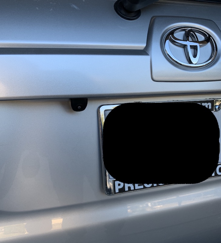

Finally got around to putting something more modern in the T4R with the following:
Pioneer MVH-1400NEX
Metra 95-8202
CRUX SWRTY-61S
CCD Backup camera in place of the license plate light
The Pioneer unit was relatively cheap ($233.5) and the apple play function is great!! Installation went smoothly and no issue getting my factory steering wheel controls to work with the CRUX SWRTY-61S. Only gripe is the backup camera. Does not fit in the existing mounting holes so they needed to be re-drilled and the provided RCA cable was not long enough so an extension is needed. Also the angle might not be optimal for most but works for me as I was tired of getting in and out of the car while hitching up the trailers.

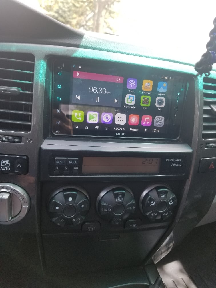

Ive been running the atoto A6 for a little over a year now along with the Natika backup camera and heres my take:
The atoto a6:
Fits great in the oem spot, hence why i wanted it. Android auto with the dongle used to work great. Relatively plug and play with the steering wheel controls, i did have to modify the metra harness to get it all to work, but its great now that it does. The last few months ive had constant bluetooth issues, along with android auto always freezing. Now their customer service is awesome, they are quick to get back and try different solutions, theyve exchanged the android auto dongle twice because of my freezing issue. Theyve sent updates to alleviate my bluetooth and backup camera issues. However just yesterday the screen went dead and ive emailed them to let them know the issue. They gave me a solution to try and i will give it a shot. If not, i will probably be looking elsewhere which sucks because it is such and awesome radio when everything is working. This is just and fyi.
The natika "oem" style backup camera:
Much like the HU, worked awesome for a few months, vision is clear even at night. However i noticed anytime it rained or i washed the truck, the camera would stop working until it stopped working completely. Emailed them, and they had me buy another camera and redunded me. This new camera has been good for a few months, but i did seal it with silicone just in case. This is just an fyi with my setup. I might be looking into the sony xav if i continue to have issues with my atoto unit
