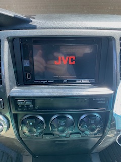

Jvc kw-v250bt
Picked up the JVC KW-V250BT from Best Buy, on sale for only $179. No nav, but I use my phone for nav anyways. Not a lot of bells and whistles, but does everything I want, including Appleplay, Bluetooth, Sirrus XM, etc. Nice sound, we are pleased.

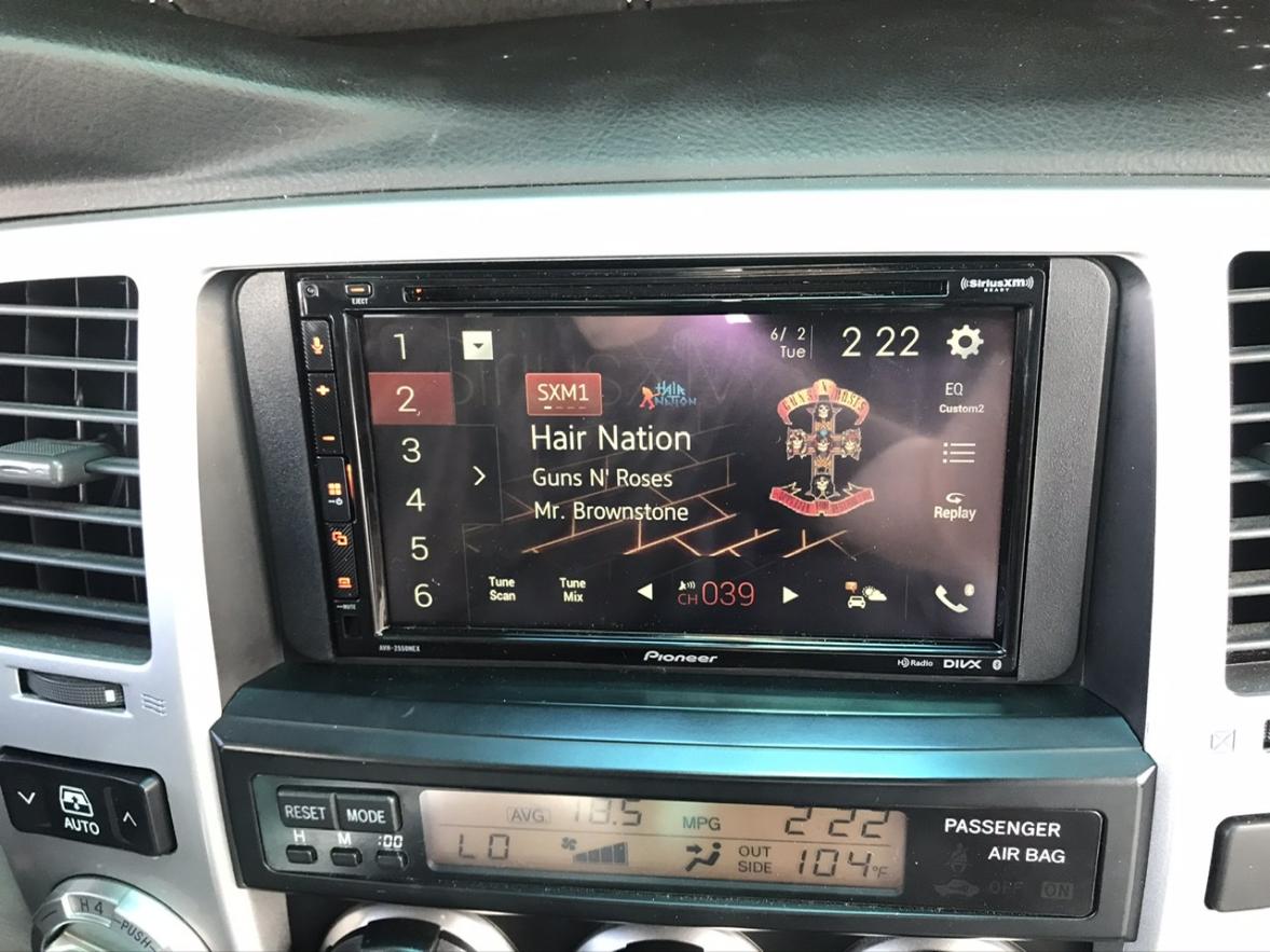

Pionerr AVH-2550NEX head unit

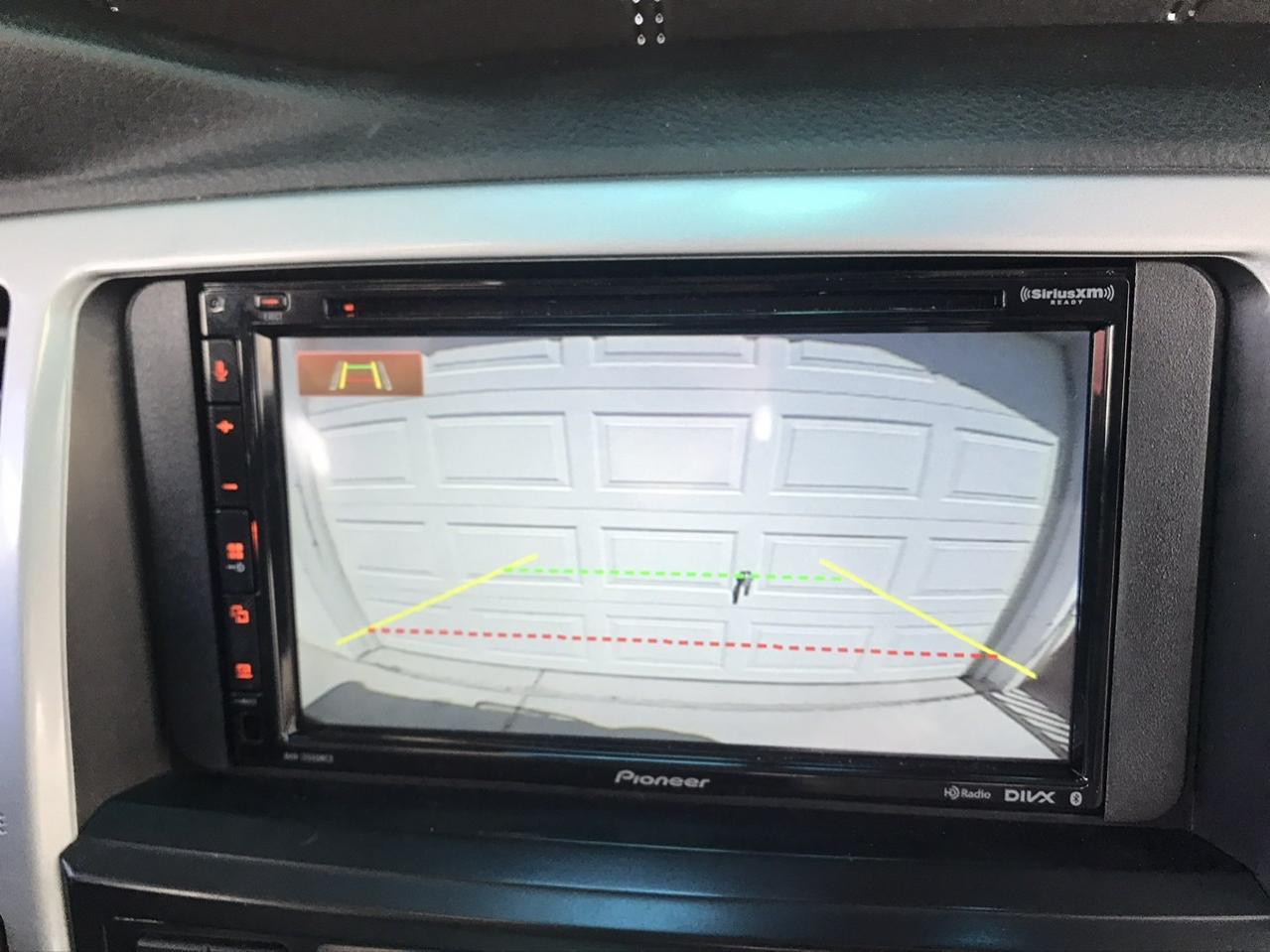

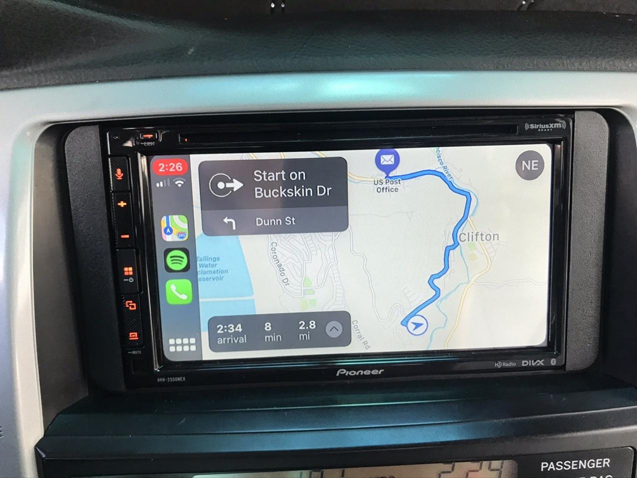

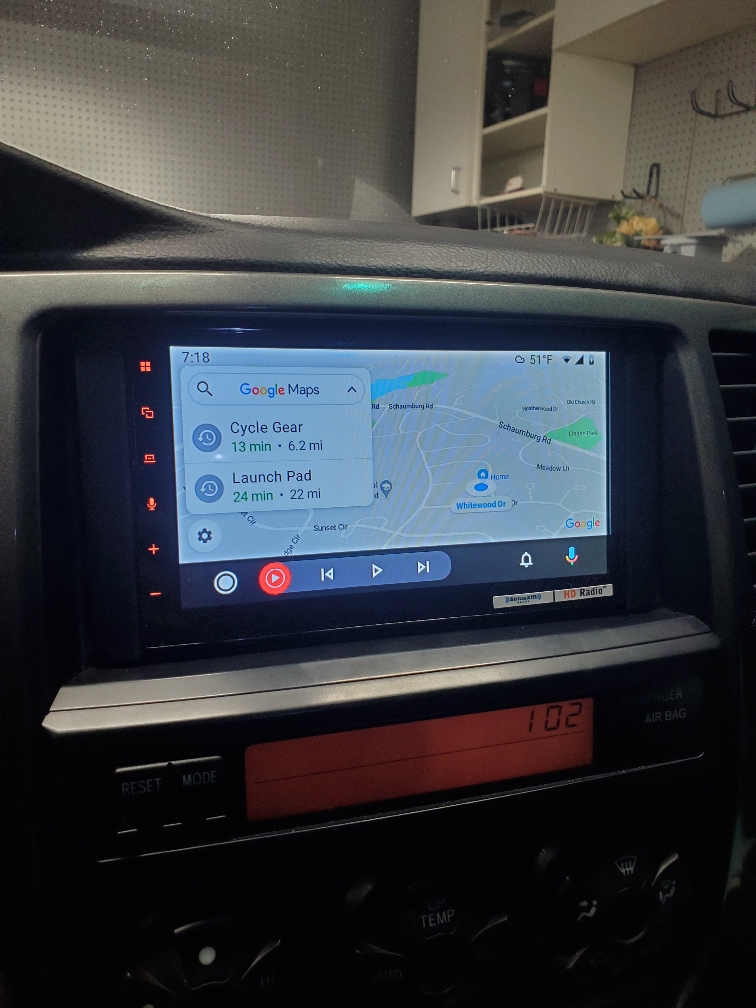

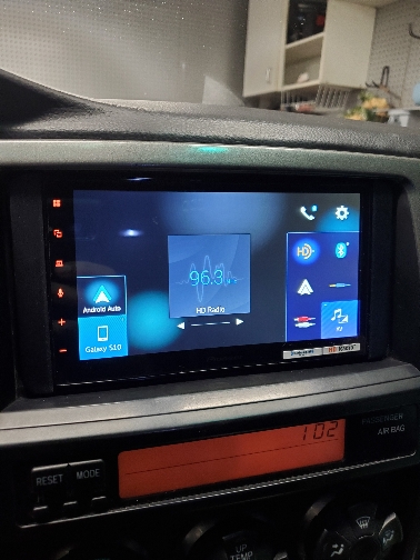

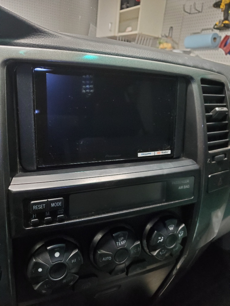

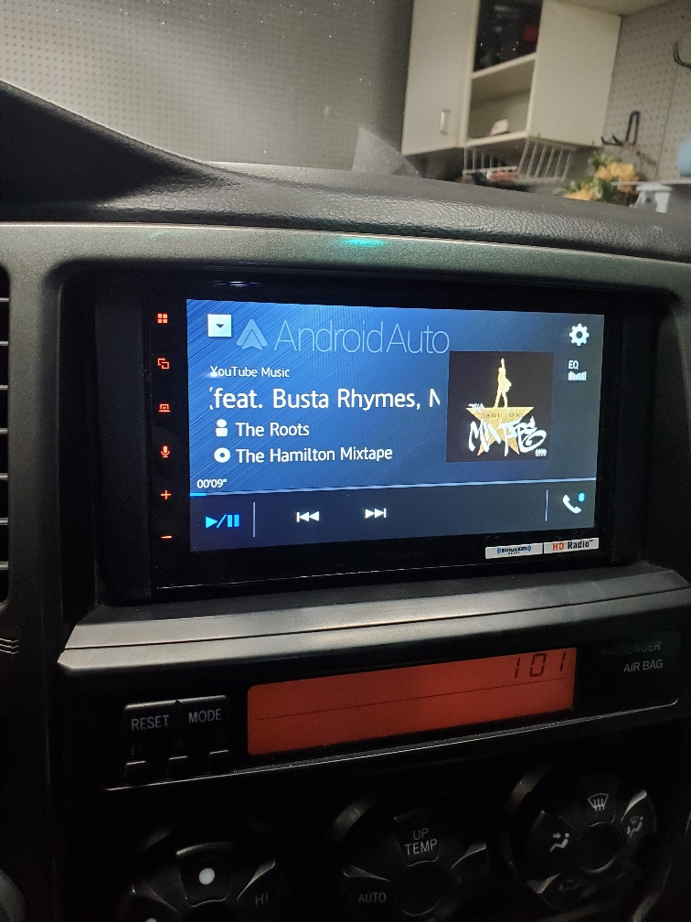

Got my Pioneer AVH-2550NEX installed. Pretty nice unit overall and does everything I need it to I believe. Upgraded from my Kenwood DDX-471HD primarily only because I wanted apple CarPlay. Got the lights, scene, and background orange to match pretty close too.
The free wiring patch cables and kit from Crutchfield were super simple and color coded. It definitely sits deeper into the opening so it was a challenge to get all the wiring out of the way behind there. Took a few try’s in and out but got it.

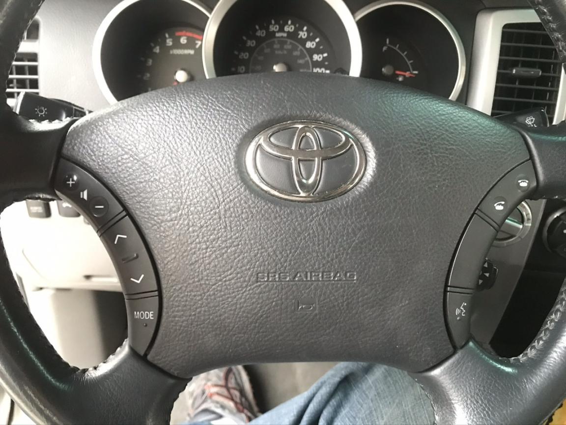

It works well with new to me right hand side steering wheel Bluetooth buttons (while phone’s unplugged).
Used my Axxess ASWC-1 steering wheel controller that I already had and steering wheel controls work perfect.

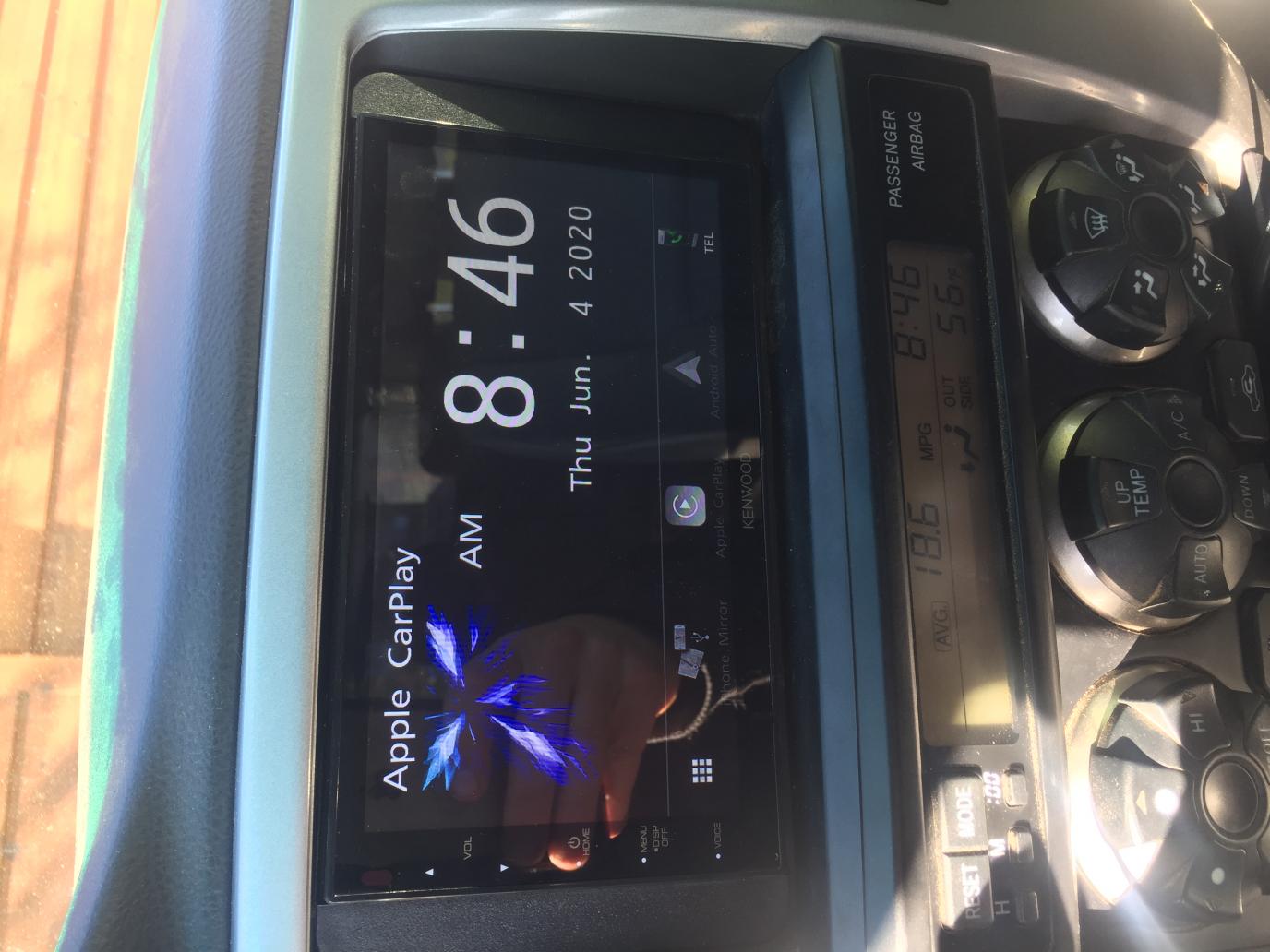

The new kenwood dmx4707s CarPlay capacitive touch 300 bones!
