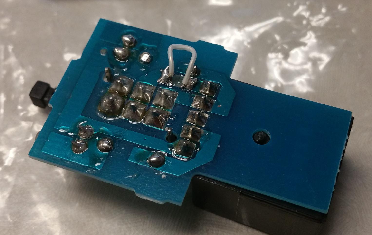

Those switches can be temperamental. I had one blow because the trace coverlay was exposed and I had to solder a small jumper wire. No issues after that. You should be able to take the switch apart and see if any of the connections severed.

Thanks for the reply: Rago got back to me and told me that i needed a different harness with a relay. Apparently the amperage coming directly from the battery would "fry" the switch. SO,
I know have a new wiring harness with relay, plus new switch. Following their instructions, I'm still getting no love: switch will light up, but lights won't light up. Hoping to get on the phone with them again today to get some help.
