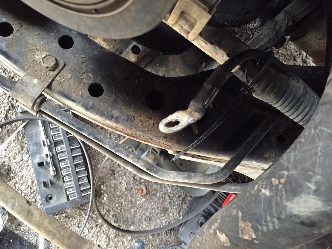

I was changing the belts today and came across a rather large gauge wire with tape on the end of it. I took the tape off and it looks like a massive ground wire. Just hanging out, sticking out of the harness attached to the frame at the bottom of the truck.
I have literally no idea WHY it's there or what it goes to. I was hoping you all might be able to help. I've attached a pic. I looked hard to determine if i could tell what it was originally hooked up to but I found nothing.
I just taped it back up for now. But hopefully someone can help me figure out what thus goes to?

First I'd get an ohm meter and verify it's a ground, and likely it is.
It's probably the one that goes from body to frame.
There's a third that goes from frame to engine.

That sure looks like a factory battery to engine ground cable, especially if it ducks inside the split loom and heads up toward the battery. Here's betting someone replaced it with another and didn't bother cutting out the old one. Bet you find the other end loose up near the battery somewhere.
Let us know what you find.

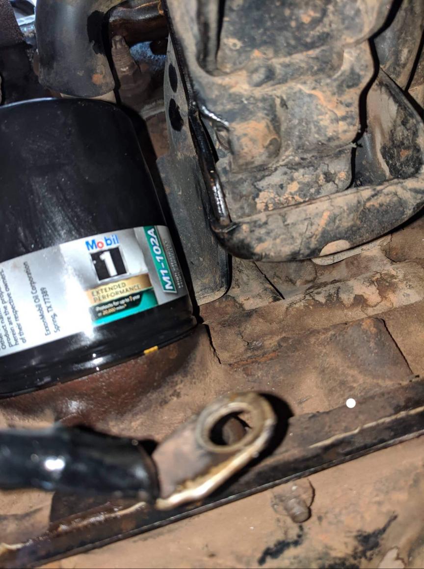

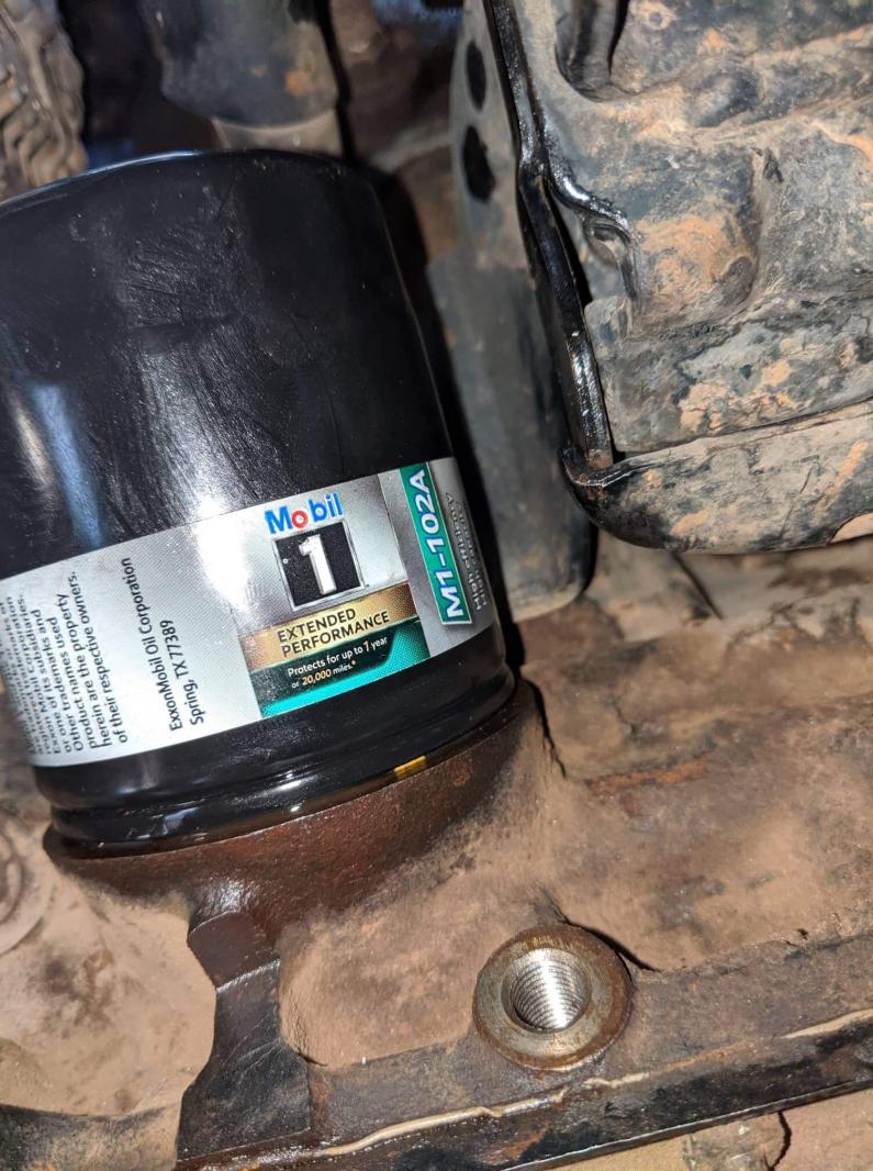

I found this wire too while giving my 2002 4Runner sr5 an oil change. Right under the oil filter. Does anyone know the size of the bolt it attaches to on the engine block. Mine was missing. I think the previous mechanic somehow took the bolt off and never replaced it.
14mm head and 10mm x1.25. However, is fairly short. I send a photo of the OEM bolt later. :)

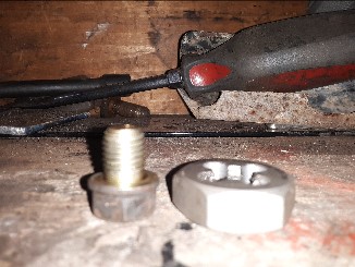

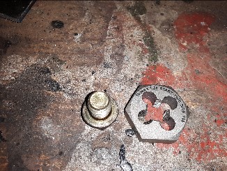

Here are the photos
Also both have lock washers.. So don't forget those or you might be replacing them again..:D
