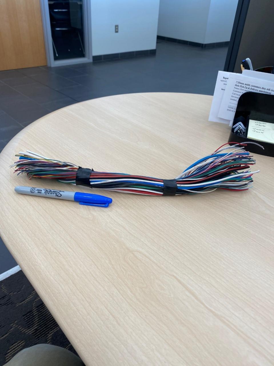

I was able to grab a section today. I put a sharpie marker next to it for scale. I dont think it will be more than $5-$10 to ship. Here is a pic so let me know if this will work.

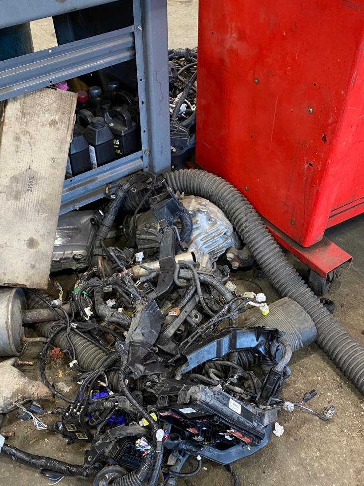

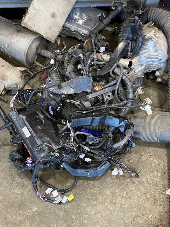

Here is what we had, It was actually a pile of 3 harnesses. The section I removed was off the bottom of the fuse block, not the ECM as I had previously stated.
