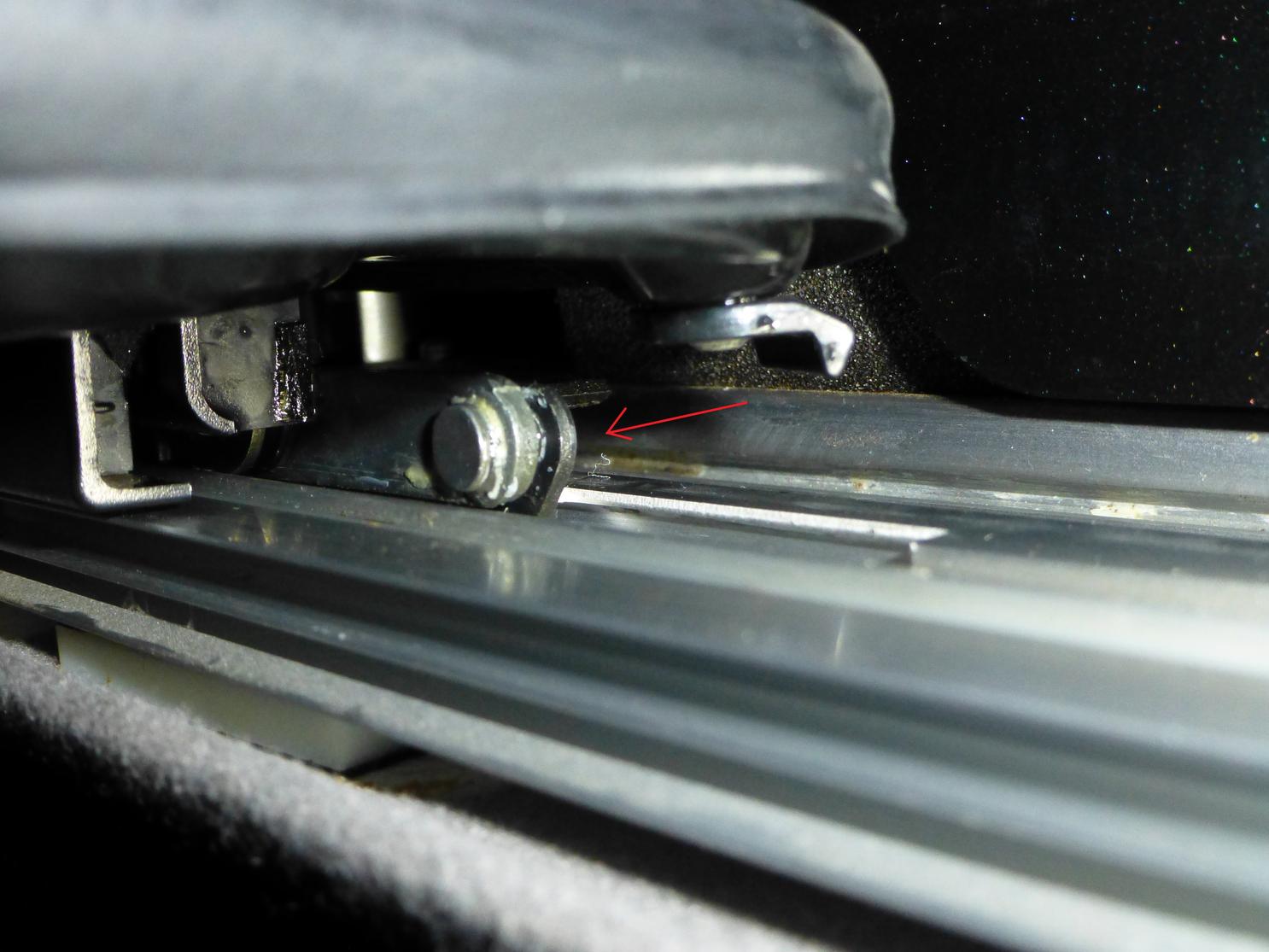

OK, here are the pictures for the fix, sorry I took so long.
This first picture is of the general area. Note that this fix needs to be done to both sides of the vehicle. And even though the sounds you might here sound like they are coming from somewhere else (much like mine did) this is actually where they are originating.

After seeing this post showing the tilt mechanism, I think that may be the source of my remaining rattle. I can push up on the sunroof in the closed position and hear it make the same sound it makes when driving - I just need to find a way of eliminating (or at least minimizing) the mechanical play in the mechanism.
This is where I am stuck - I am working on figuring out some way to "pre-load" the sunroof when it is in the closed position so that it is as if I am pushing up on the glass all the time. If and/or when I come up with something, or if I see something while I am lurking on this and other forums, I'll add it to this thread.

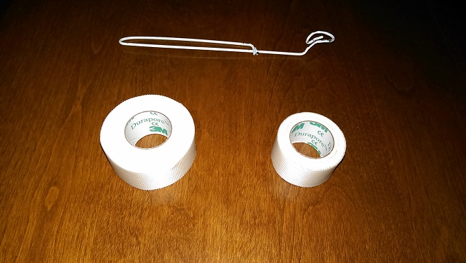

Sunroof rattle fix

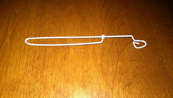

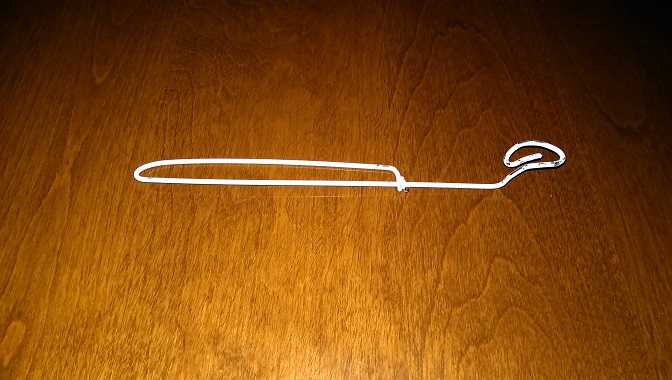

I got my Durapore tape in today with nearly smooth edges, and applied it to the sunroof opening. The following is what I did:
Below are the two rolls of Durapore - the one on the left is a complete roll, the one on the right after applying the tape. You might consider getting two rolls as well, because if you have difficulties, you might run out of the tape and have to wait on another roll to come in, and they are really cheap - less than $5 each on Amazon.
The white wire contraption is a tape applicator to press the edges of the tape to the underside of the roof, keeping the Durapore from catching on the edge of the rubber gasket when closing the sunroof. You might find a better way - my fingers can't fit between the sunroof panel and the sunroof opening.

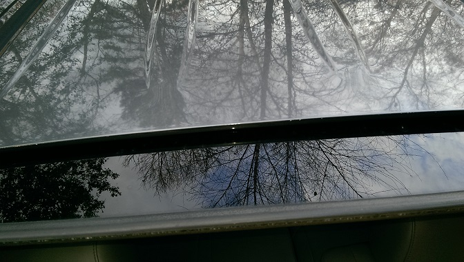

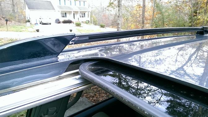

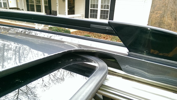

Here is a look at the sunroof opening before I did anything:
