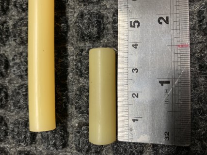

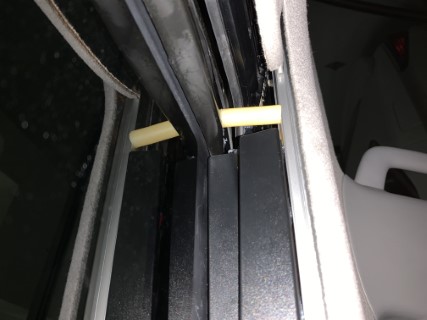

Like most of you who struggled to get rid of the moonroof rattle. I have tried most of the suggestions incuding the TSB. But did not solve the problem. The only one that I did not do was to pull down the headliner and inspect for anything loose. That's just too much work.
I just like to share how I got rid of the rattling noise. I used a plastic melt glue stick and cut it 36mm length and put it between the aluminum rail and the moonroof metal frame (that holds the glass). Be aware that you must remove the glue stick if you want to open the moonroof.
