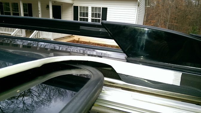

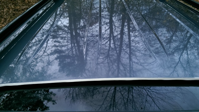

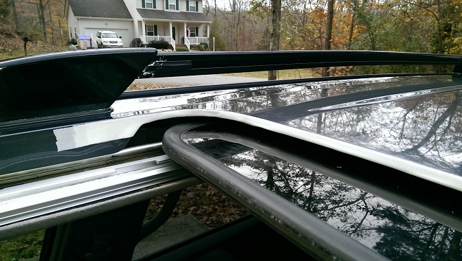

Lastly, I repeated the first step a couple times and got the tape to a thickness of three layers. I then took it for another road test, and it is dead silent from overhead. Think my problem is solved! Pics of the finished tape:
If you look, you can see that the ends of the layers next to the roof rack supports, are staggered. The innermost layer is shortest, and the outermost layer is longest to protect the ends of the strips.Also, I took these pictures before I tilted the sunroof up and pressed the tape against the inside of the roof panel with my fingers - the tool I made was more or less to just get the tape out of the way and not get torn off when I raised the sunroof to access the roof panel. Hope this helps someone. My own sanity has now been preserved.

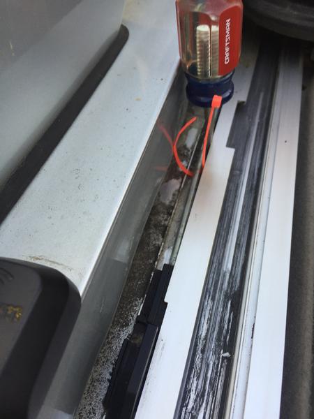

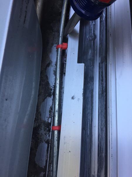

Read a lot of good treads on this topic and decided to take my own stab at it.
Found some small zip ties (of course all I have is red) and ran them around the aforementioned rod:
The trick here is after you cut the excess off, push the "stub" IN towards the center. It fits perfectly in the groove the rod is in and gives tension, thus ceasing the rattle.
I used three zip ties on each side (equally spaced) and it seems to be working pretty well so far.
That might work if your rods are what is causing the rattle. On mine the rear portion literally moves up/down about half an inch due to play in the hinge assembly. At 50 mph the sunroof would flap up/down causing a crazy rattle. If you push up on the rear corner and it moves up more then an a sixteenth of an inch this may be your problem. Only way to fix it is replace the whole assembly.
