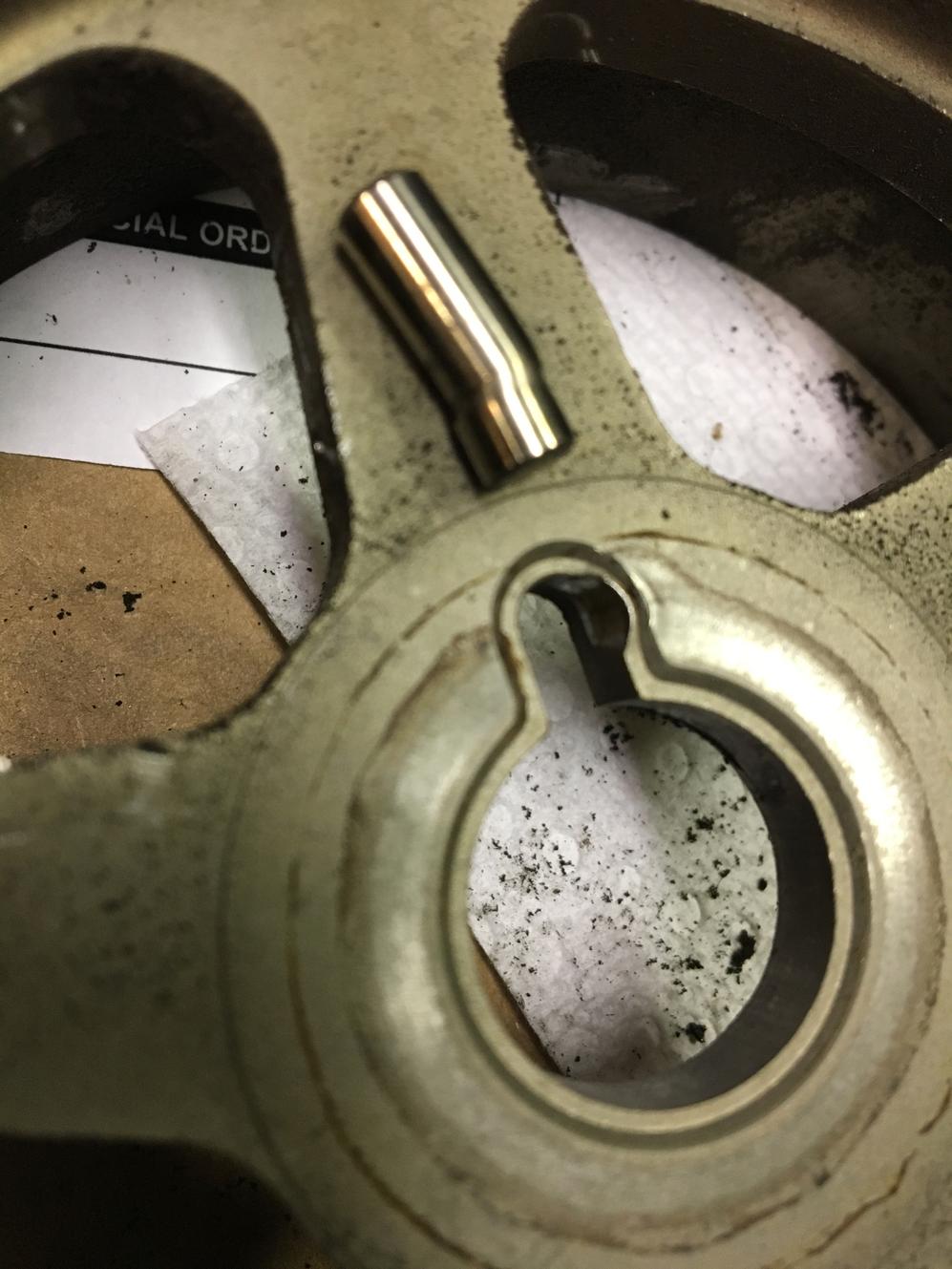

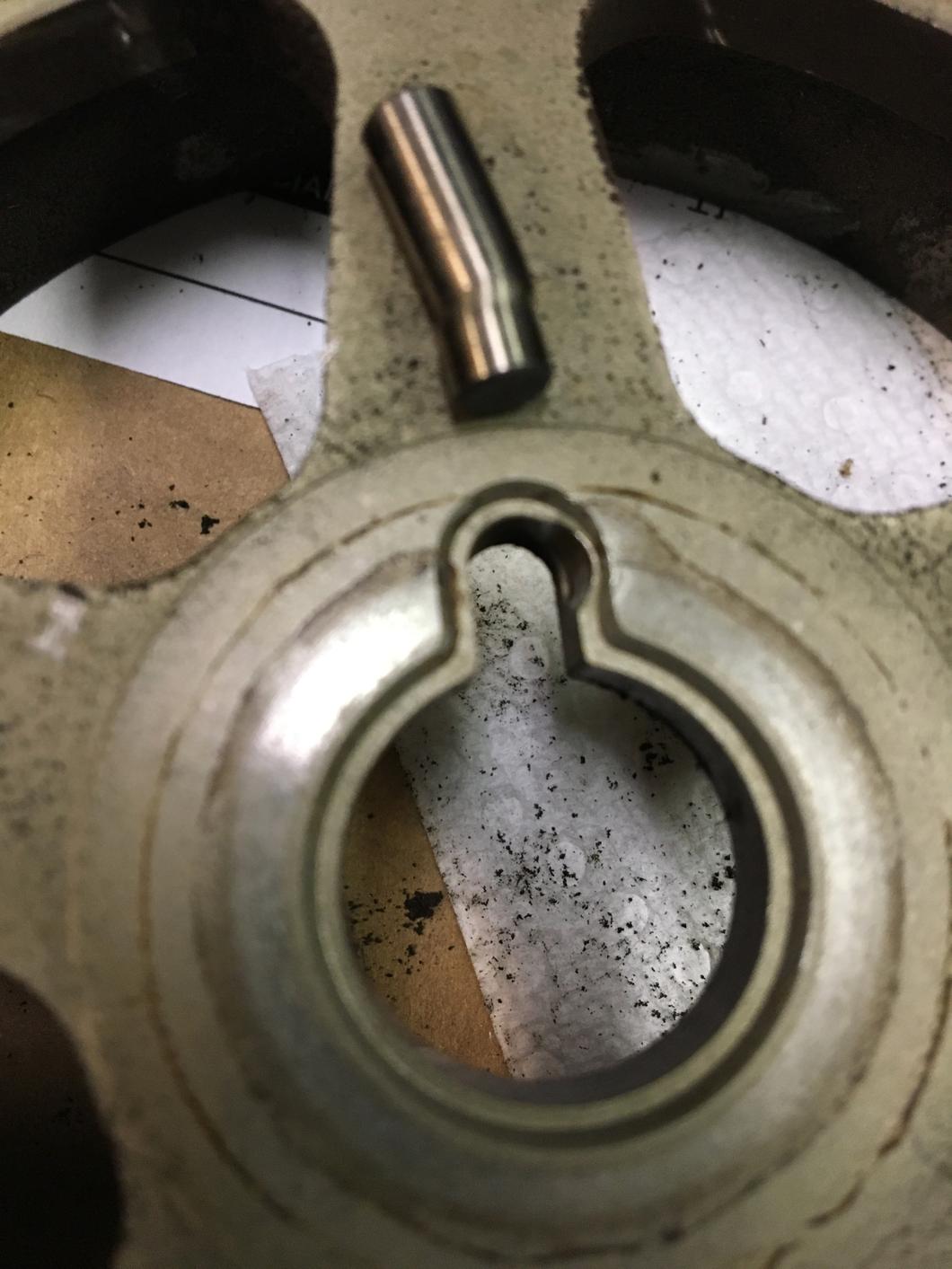

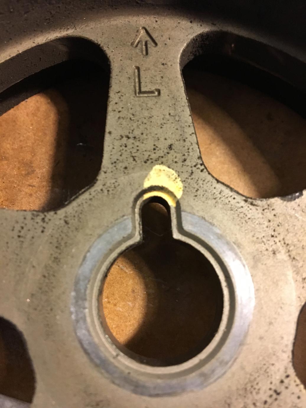

Hi All, I am doing the T belt (thank you Timmy the Tool Man) and had a heck of a time getting the cam pulley bolts loose as do many folks apparently. I somehow bent the pin, which I will obviously need to replace but I also dented the cam pulley where the pin impacted it. My question is do I need a new cam pulley? A mechanic I know says the bolt will hold it in place, but I do NOT want to have to take everything apart to fix it later. Anybody seen this before and have a firm answer? Thanks much!

With the bent pin, you may have a one tooth off from the timing. Check any 5vzfe: These are in tacoma's Tundra's T100 pickps.
If you are in a pinch try to reverse pin into cam.. it isn't bent enough to change timing.
84944628
You can also use a roll pin if you have a selection available.
Torque: 110 Nm (1,100 kgf-cm, 81 ft. lbs.)
The bent pin won't work however the dent in the cam pulley shouldn't affect the timing as the bolt is what ultimately holds the cam pulley into place, not the pin. The pin just acts as a locator.

BUT, the front is undamaged. I think I can use a new pin (not pushed all the way in, so it contacts the front of the pulley) to locate the pulley, and then tighten the bolt. Does that seem prudent to you guys?
that should work.

I wouldn't freak out if you can't get a new pulley. There are many engines out there that don't even use an alignment pin... though the ones I know are German, so maybe that's not the best thing to copy!
But yes, if the bolt stays tight, there is no force on the pin during regular engine operation.

I agree what others have suggested. Either get a used one at a junk yard or just buy a new one. I don't think it's worth the risk of using that one that got damaged.
I'm trying to envision how this happened in the first place? How were you securing the cam pulley while you were breaking the bolt free. When Sean and I did it, all the force was being applied to the bolt and a couple of the pulley spokes.

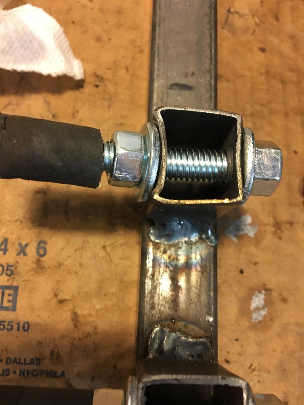

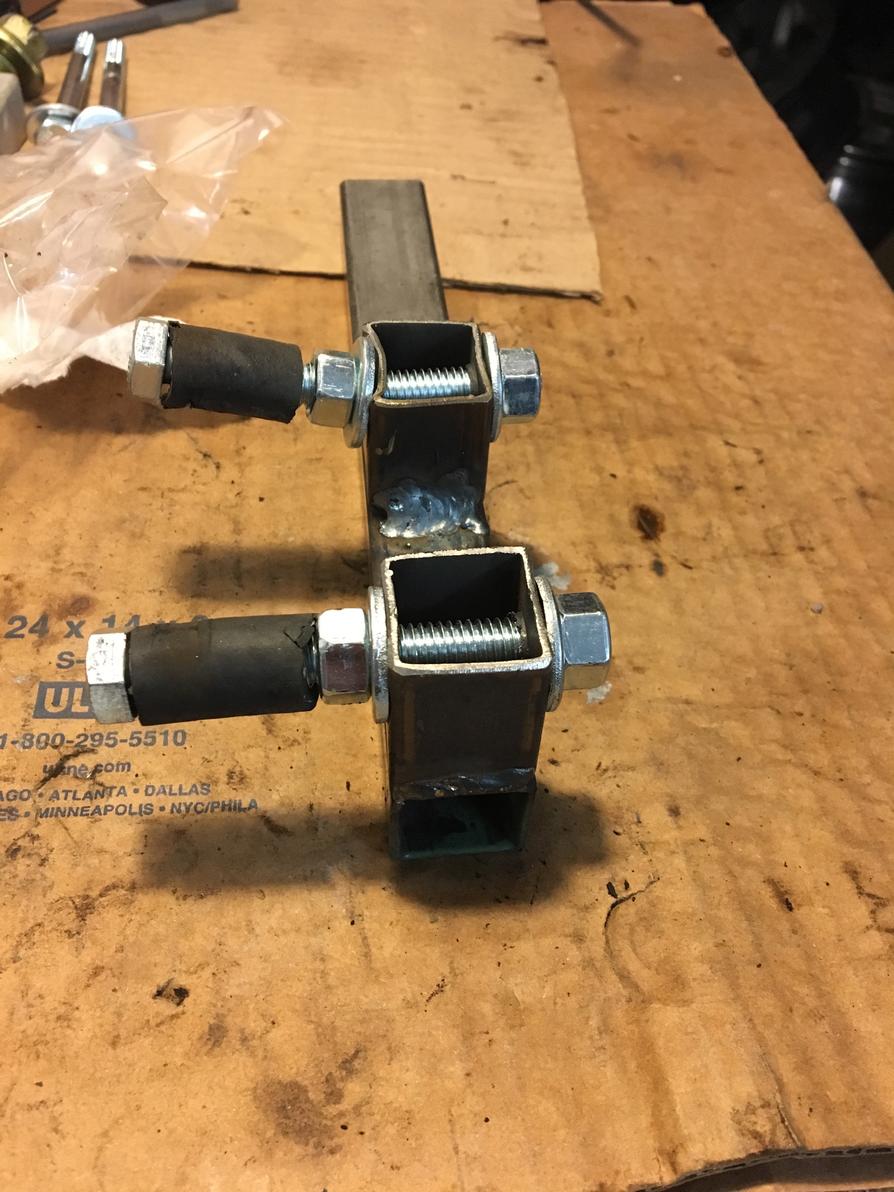

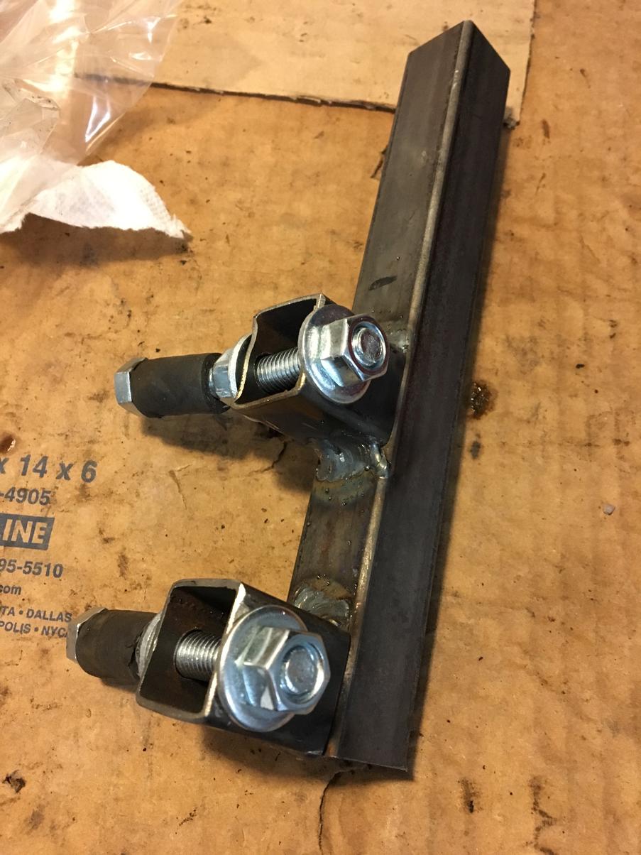

Tim- I am doing this pretty much step but step with your video (THANK YOU for the vids- already did my valve cover gaskets and couldn't do anything without the videos- they are awesome!). I made a tool to hold the pulley in place and it worked pretty well although it did bend a bit. It looks like the pulley turned on the shaft, isn't that the only way it could have happened? If anyone has any other idea please chime in. Both bolts were VERY tight. I set up my tool to hold against the frame rail and pulled as hard as I could and it finally popped.
Another question- the crank gear is not "falling off" like yours did in the video. Any suggestions for tools (maybe auto parts store rentals?) to get that off. I ordered the seal puller Tim uses today off Amazon.
Here's the tool I made. As i said, it did the trick but I'll have to replace the one bolt to install the pulleys. It is 1" square tubing (18 GA I think- thicker would have been better obviously). I used a 3/4" square tube (about 3' long) for the handle part. Thanks for all the replies guys. Love my 4Runners and this forum is a big reason we recently purchased one for the daughter.
