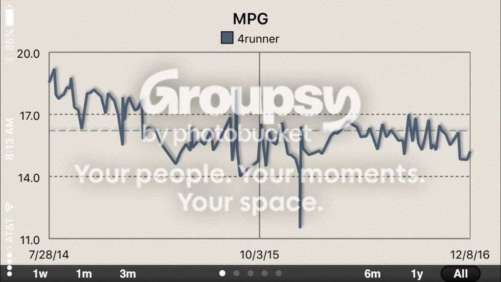

I use gas cubby like [MENTION=105481]3wbdriver[/MENTION] . Give you cool graphs and charts so you can watch your efficiency drain away with each mod!
