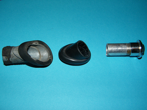

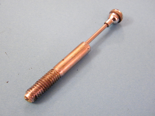

After opening the power antenna up to see what was inside, I cut out the important bits.

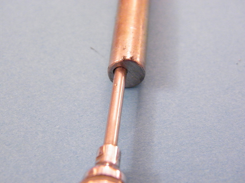

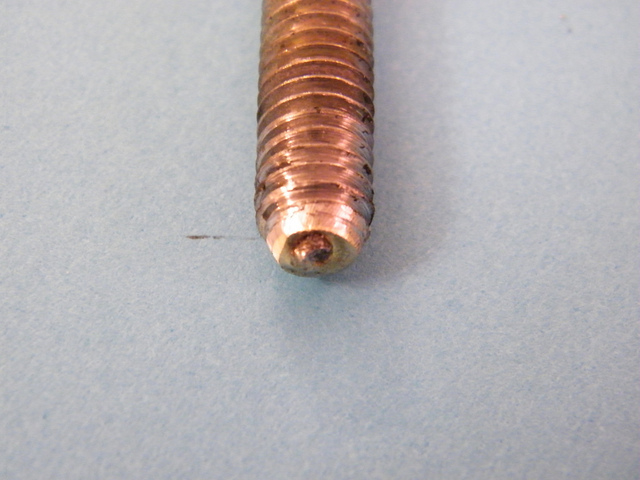

Then I took a bolt, cut the head off, bored a hole thru it and welded a chunk of antenna into it.

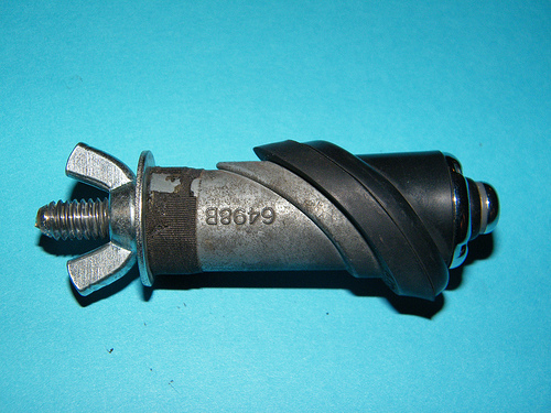

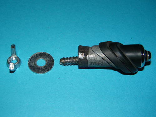

Add a washer and wing nut...
And Viola, a plug for my ugly hole that cost $0
