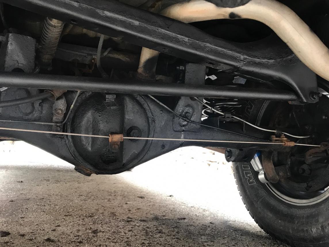

Hello,
The rear brake line that runs along the differential on the passenger side just started to leak. Does anyone know this part #? I would rather have a direct fit if possible. Thank you
1999 Toyota 4Runner
SR5 4x4, ABS
I believe that there is an individual line that runs left and right to each drum from a T fitting at top of rear differential.
If you have part numbers to both sides that would be great. I guess I could replace both. If there is a stainless steel hose option, I would consider that too.
Any feedback is greatly appreciated
This is a super easy line to bend yourself. Just measure the length and go to a part store to see if you can get the pre-made sections in a length that's the right length, or slightly longer.
Before 6/99 with 265/70r16 tire
47325-35280 pass
47326-35060 drv
After 6/99 with 265/70r16 tire
47325-35282 pass
47326-35062 drv
ToyotaPartsDeal.com part numbers.
Do your own research to make sure these are the correct part numbers for your optioned 4r.
thank you very much! my production date was 05/99 with 15" tires. Although, when I purchased the vehicle, it had 16" tires on it. do you think that this would make a difference? I was thinking of going with the part numbers that are for 15" just to be safe so that it would be a direct fit.
which are..
47325-35270 right 15"
47326-35050 left 15"
Any input is much appreciated.
