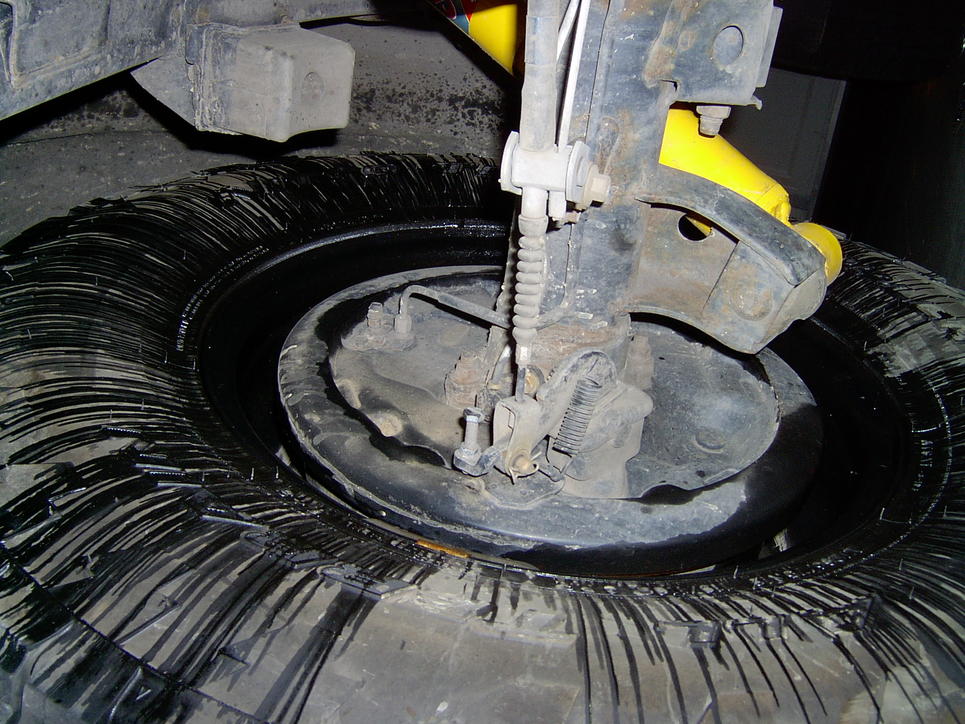

Once your wheels are off, your drums will have varying amounts of gear oil on them, looking something like this:
Your wheel and tire will look something like this:
Now take the rubber hammer and lightly strike the drum until it comes loose and you can pull it off the wheel studs. Once you remove it, you will see that the inside is full of thick black grease. This is a combination of gear oil and brake dust.

I liked the nature of the photographs such as before and afters and that one shot framing the lady in the newspaper photo gives some relevance to your hometown news of the time. Sorry to read about that car wreck.
