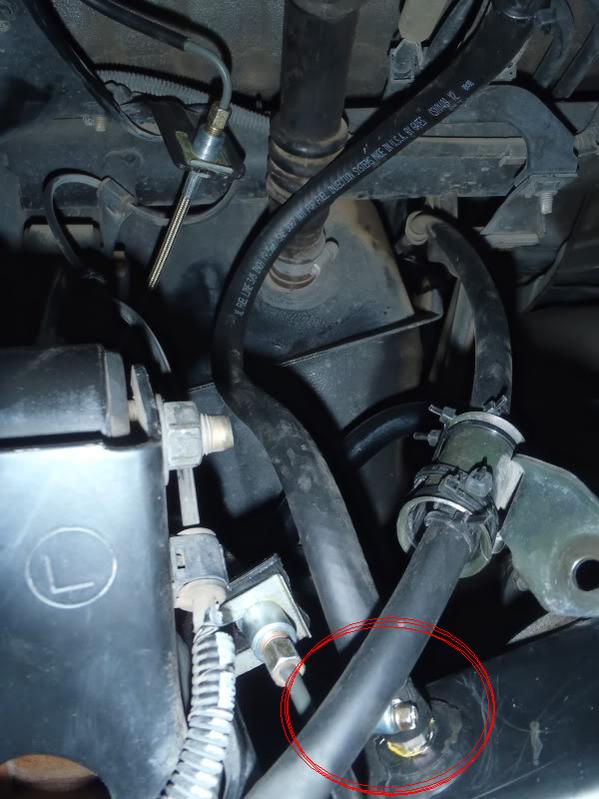

I replaced my rear axle seals today (with great help from this post!) and I could not seem to find the “breather tube” on the rear differential! Any one have a photo of this? (I have a 2000 4WD limited)

I replaced my rear axle seals today .....and I could not seem to find the “breather tube” on the rear differential! Any one have a photo of this? (I have a 2000 4WD limited)
Sorry for the late reply on this, but I've attached two images at the bottom of the post that show the location of the rear differential breather. The top picture is my '01, and the bottom is my '97. Both have extended breathers, hence the tubes coming off the axle/diff housings. If yours has not been extended you will see a small cylinder about 1/2" wide and about 1" tall extending out from that spot...that is your stock breather.

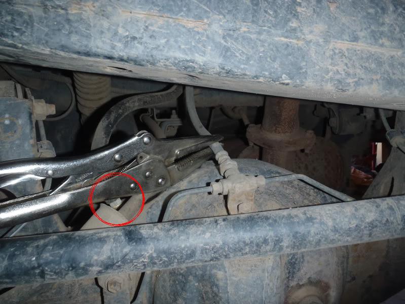

I'm working on my drivers side axle right now and I have a couple of alternative suggestions. When I went to pinch the flex hose to the rear brakes it was stiff from age and I didn't want to risk stressing it. What I've decided to do since I have everything apart is to just replace the wheel cylinder now since it has 158,000 miles on it anyway. Since the brake line has to be disconnected, its a great time to install a new cylinder and a speed bleeder all at the same time. So instead of pinching the hose I unbolted the cylinder from the hub backing and re-attached it to the brake fluid line to stop it from leaking. when I install the axle again, the new cylinder will be bolted in place. Just in case you are thinking that you are too cheap to buying another part, you can buy one from Autozone for $12 or really splurge and get an Aisin from Rockauto.com for $25 ea. You know its just a matter of time before it starts leaking anyway. Note the cylinder is contained with a zip tie to keep the pistons from popping out.
