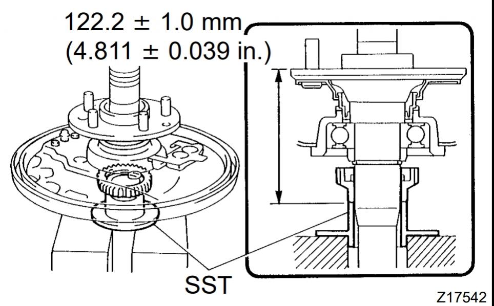

I could really use some help. I'm in the middle of replacing the seals, bearings, etc... I previously paid a shop to do this and it failed. I have a 2001 4Runner and the bearings I just pulled out do not have the lip (maybe this contributed to the quick failure). I've moved, so seeking warranty work from the shop that botched it isn't an option.
I'm installing the 90363-40068 bearings, with the lip. It looks like the lip must go toward the wheel, and the flat side of the bearing towards the ABS Ring. I just want confirm this is correct, before I start pressing stuff into place.
Any help would be greatly appreciated.
Looking at this FSM pg. SA-84 I'd say lip goes inward toward ABS ring. FSM can be deceiving.
Bearing inner race being beveled like it is there's usually a reason and a like mating surface.
https://s3.amazonaws.com/rparts-sit...403335c7/cebc24b8e377be1b848b96472887bb99.jpg
Been 8 years since replacing seals in my 01 didn't pay attention to this detail.
I'm pretty sure the extended inner race on the 90363-40068 goes outward toward the wheel. That's how I remember from 10-years ago when I first did mine.
Now you have conflicting advice :/
I need to (again) do the same bearing/seals work on my 2001, so I'm interested in an authoritative answer, also.
Okay, after looking at the mating surfaces, the answer became obvious. The lip side of the race has an inward bevel. If you were to press the retainer on against the bevel, you'd run the risk of the retainer ring slipping into the bevel and distorting the lip. Therefore, the lip side has to go toward the wheel and the flat side goes toward the ABS ring, as the flat side will mate up well with the retaining ring.

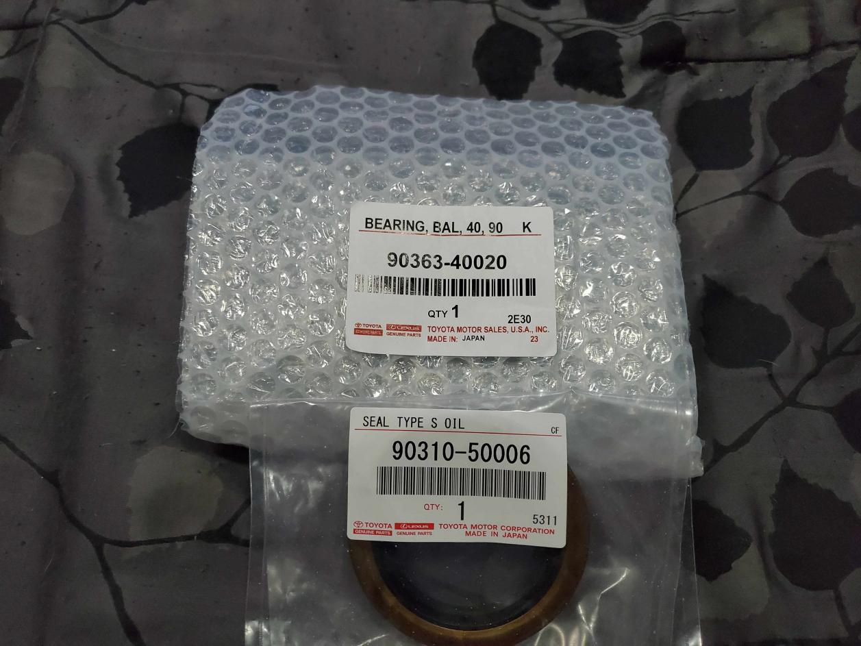

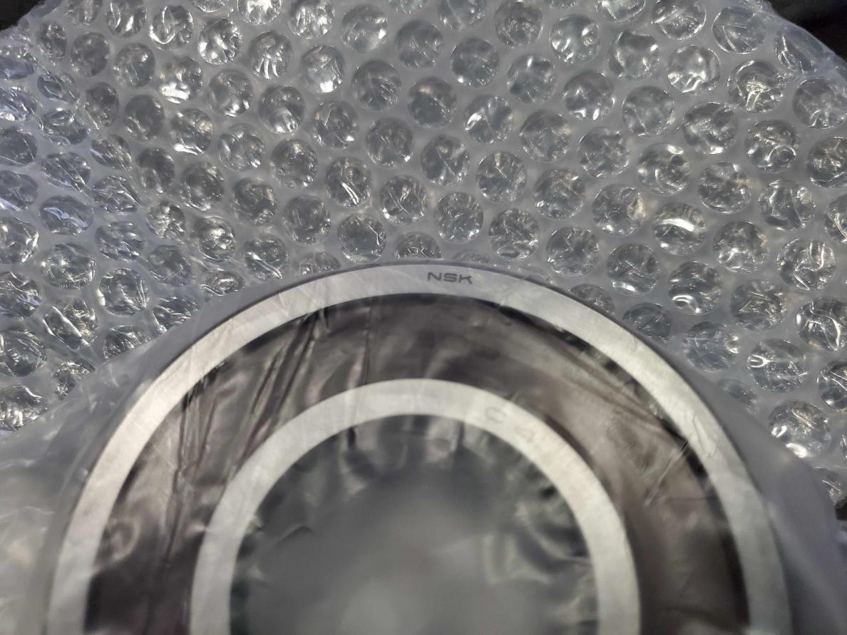

Bumping an old thread. Just a FYI the oem toyota rear wheel bearing part # 90363-40020-77 is now discontinued.
I was able to get a set from toyotapartsdeal but they didn't come from the normal place, and have a suspicious part label sticker that looks fake. The bearings are NSK, so not oem koyo or nachi. And came in bubble wrap and not a toyota box. Super suspicious.
The seal is oem w/oem parts sticker.
