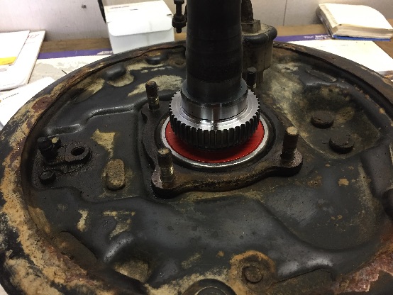

So. I'll play a game of good news, bad news! The good news is that I got the leaking side replaced. The bad news is that I short-ordered the ABS ring retainers by two so I could only have one side pressed.
I replaced and relocated the diff breather so I should be able to survive for another week or so...

Hey, do you have a before picture to compare that to? It looks like the bearing is really far out and the retainer seems really far in. Just want to make sure its right before you put it all back together.
Here's where mine is in relation to the smooth area of the axle.
And the bearing is sunk in there pretty good.
I did. And I panicked when I saw it and went to bolt things up. The bearing was sitting out by about 3mm. Thankfully, everything was taken care of.
