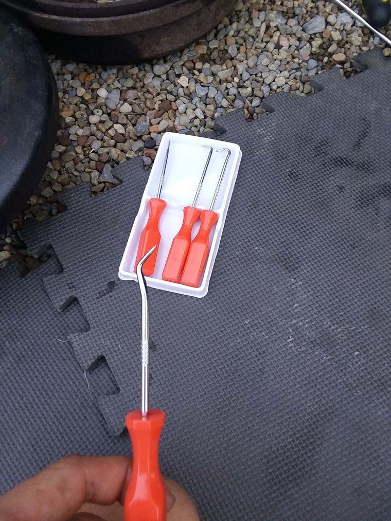

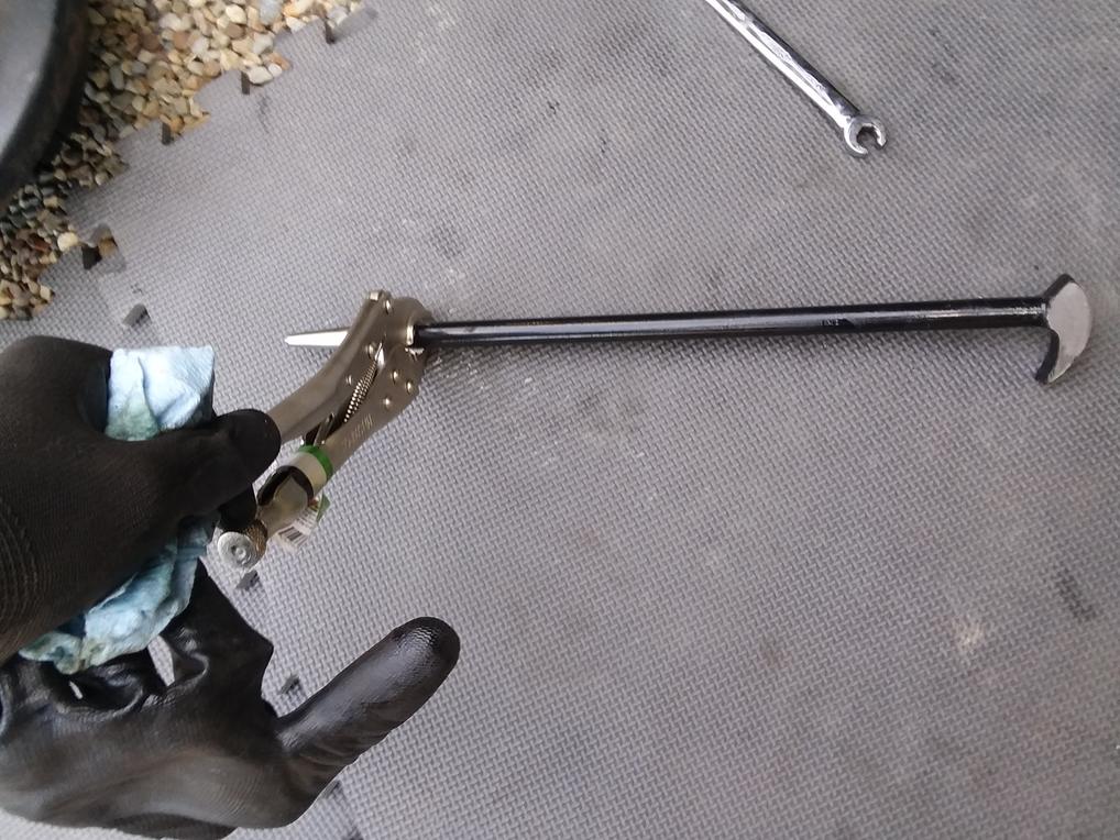

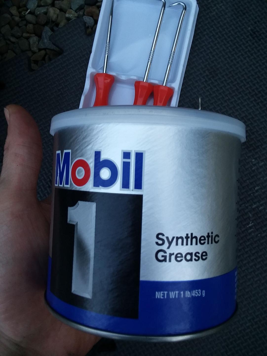

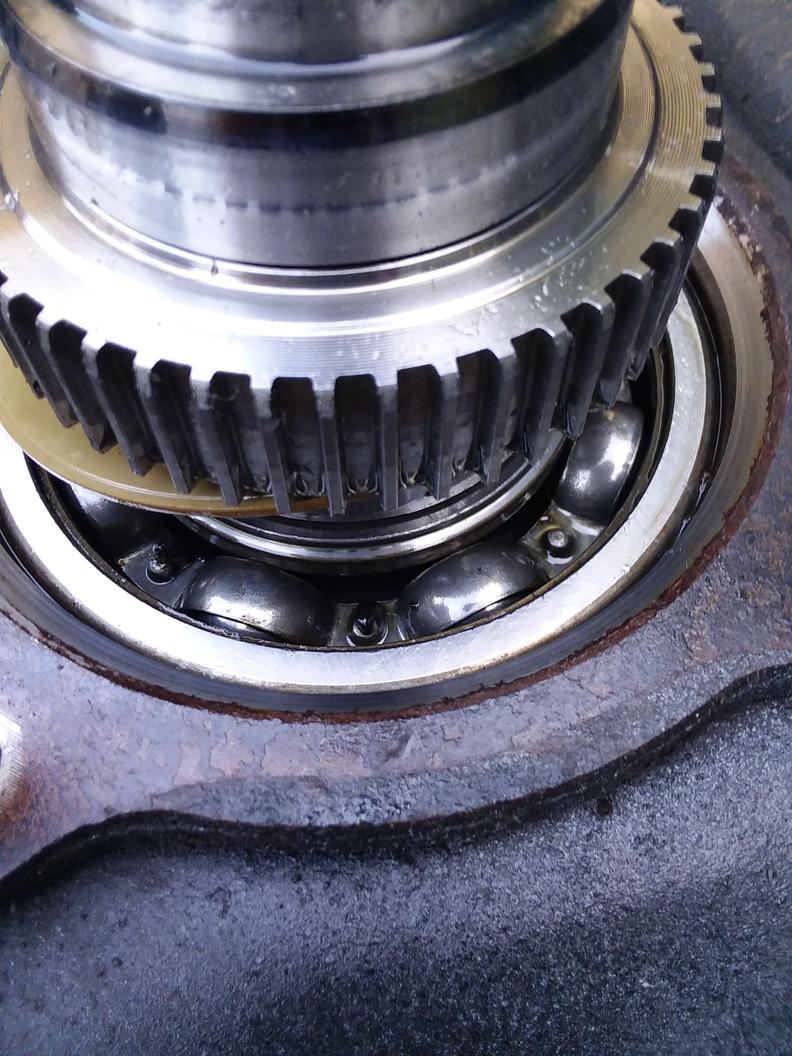

I wanted to add some tips and tricks to this informative thread. I did the driver's side seal a week or two ago and heard that the bearing grease gets washed out by the gear lube so I did not drive the vehicle in fear the bearing would wear out. I recently saw a video on how to pack an engine pulley bearing and decided why not do that with the 4runner axle bearing and maybe extend it's life? So I headed to Harbor Freight and picked up some tools.
The first picture is my custom seal puller. It's just a pry bar and locking pliers. I used a hammer to tap against the pliers and it popped the seal right out.
The second picture is a set of picks I picked up at Advance Auto. These are used to carefully pry off the side cover on the bearing.
The third picture shows the side cover off the bearing and you can see that the grease has been cleaned out by the lube.
The last picture is synthetic bearing grease from Mobil 1. I packed the bearing using my pinky finger to squish it in between the ball bearings then inserted the side cover back on the bearing.
