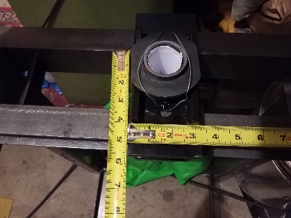

It seems most people are using the harbor freight 20 ton press to replace the bearing and retainers. I picked up a harbor freight 12 ton at a yard sale for 20 bucks since I've always wanted a press at home. A month later I have a leaky axle so I thought this would be a perfect time to use the press. I've replaced my bearing and seal a few years ago but had a shop press new gear on.
I'm wondering if its physically possible to use the 12 ton press to remove and install all new hardware with the exception of one retainer and abs gear. I would buy the removal tool you can buy on ebay if it's possible to use with the 12 ton press. Is the main problem the distance from the lowest setting on the crossmember to the Jack isnt tall enough? I've heard that you can remove the wheel studs for additional room. Has anyone successfully removed and installed the bearing and retainers with a 12 ton press from harbor freight?
I wanted to update my situation and answer my own question so others know. I bought the bearing puller on ebay and this tool wont work with a 12 ton harbor freight press unless you modify it a little bit which wasn't a big deal. The reason it will not work is the space between the crossmember is too skinny for the bearing puller to slide up through it. Tool comes in around 4.5" wide. I had to grind off some of the metal in order for it to fit through. I think it was a little over a half inch on each side of the tool. Just enough of the flange to cut back so it could be slide up through the space between the crossmember on the press. Obviously this can change the strength of the tool by taking off material so do it at your own risk. 12 ton jack had plenty of strength to pop off the bearing and retainers in my case There's enough space between the jack and lowest setting on the crossmember to work with to remove and install the retainers, abs ring and bearing. I did not have to remove any wheel studs for extra space. It was pretty close but just barely enough space to complete the job.
Overall it was really easy to use the tool and press for this job. I dont know the spacing of other 12 ton press but harbor freight 12 ton worked great.
