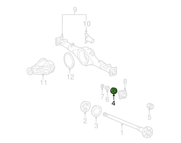

I found that the official toyota part numbers for these are
90363-40020-77 for the flat pre-2000 models
(pic) 1984-2004 Toyota Bearing 90363-40020-77 | Camelback Toyota Parts
90363-40068 for the last two years

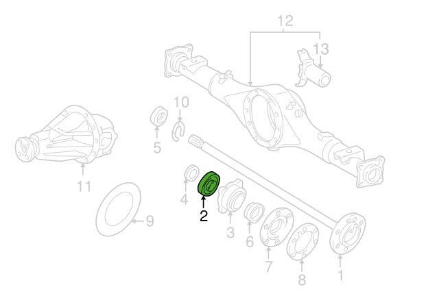

(pic) 1998-2006 Toyota Bearing 90363-40068 | Camelback Toyota Parts
I'm not smart enough to know WHY, but the guy at Marlin told me it has to do with how the later models are assembled. Not sure why Toyota changed the last two years this way, but I'm sure there was a reason.
part pictures for schematic organization
left is older, right is newer
