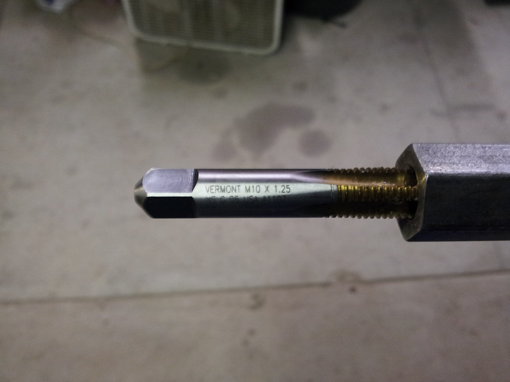

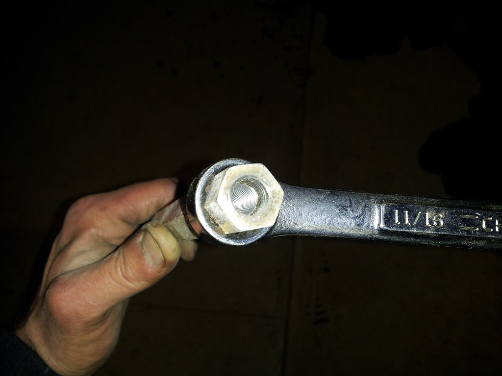

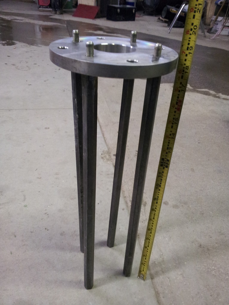

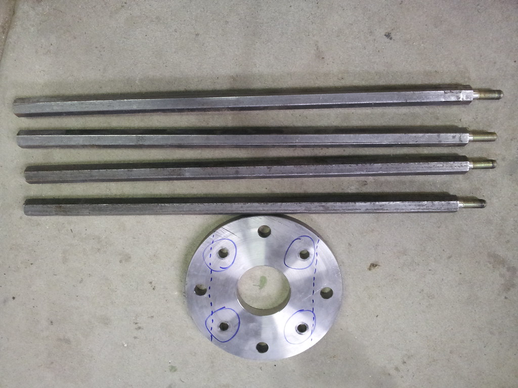

To anyone that wants to attempt the bearing press work themselves I have includes pictures of my own SST. There are various homemade styles out there but I thought I would share mine to possibly give ideas to others. The components that I chose were ones that I had available to me for very cheap so the cost drove my design. The stainless steel ring started out life as something completely different hence the extra holes. The circled holes are the same bolt pattern as the flange and there only 4 that are needed for this application. I chose hex rod because it was available and could be gripped with a wrench to tighten down onto the four M10X1.25 studs on the backing plate. I decided to relieve the tapped holes towards the end because the studs aren’t threaded all of the way down. In the picture you can see that the threads in the tapped holes do not start right away. To the outside of the dashed lines on the ring is the point of contact for the press and the ring. The studs on the end of the shaft are also M10X1.25 so you simply use the nuts that hold the backing plate to the flange as fasteners for the tool also. The overall length isn’t critical I only put a tape measure in the photo for scale. As far as the retainer removal I made an extended reach gear puller. Imagine the one pictured below with MUCH longer shackles. I was told it looked like a War of the Worlds Tripod :). Try to use a gear puller that has a sharp point on the bottom like the one pictured. This allows the puller to stay located onto the end of the axle shaft. The axle shaft has a center drill mark for holding purposes during machining.

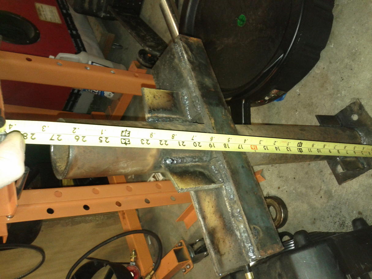

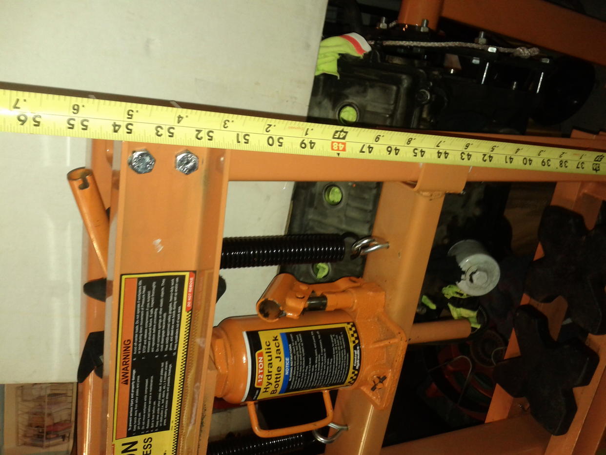

this is the press I used and the SST I made to get the bearing, races, and ABS skid control rotor pressed off. My tape measure its a 10ths tape but you can still see the inch side, and the pics might be sideways if so sorry, dont have time to edit. hope this helps
