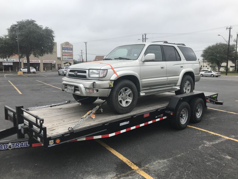

I got lucky and located another rear locker axle (and extras) for 1000$ This one's rust free.
