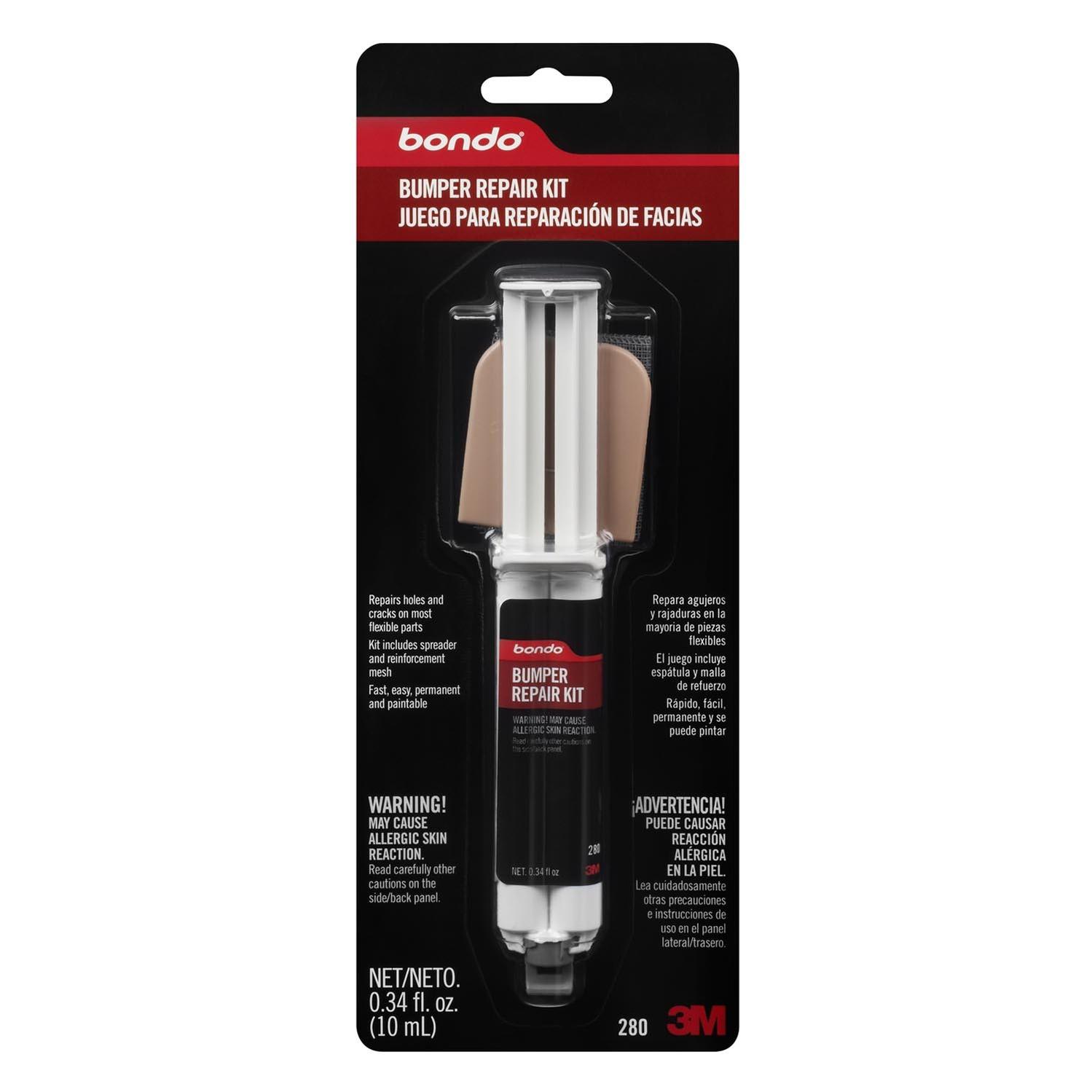

This will work- I filled in some holes on my front bumper and it worked great. Kit comes with a mesh screen to help fix cracks like you describe.
Any autoparts store should have it.
As already said repairing bumpers is expensive to do it well it's a lot of labor. You can use the kit above or better would be buy a cheap plastic welder. It's basically a soldering iron with a flat tip. But you will still have the paint problem.

Thanks for the plastic welder - I looked it up but I am not sure I want to take the chance of creating more of a mess. The crack is very defined - if I press the bumper, the cracked parts fit back well together - no plastic came off or anything. I am hoping once the crack is epoxied, it will just look like a hairline and hoping to do maybe a quick touchup job or leave it as is- I have the blizzard pearl so I don't know if trying a touch up will make it look worse. I really don't want to spend $1000 just to fix this. Only thing I don't know is if whether it will eventually recrack due to heat/cold weather.

the quick touchup still means filler and paint
If you just want to glue it back together, just remove the cover and epoxy the backside of it
