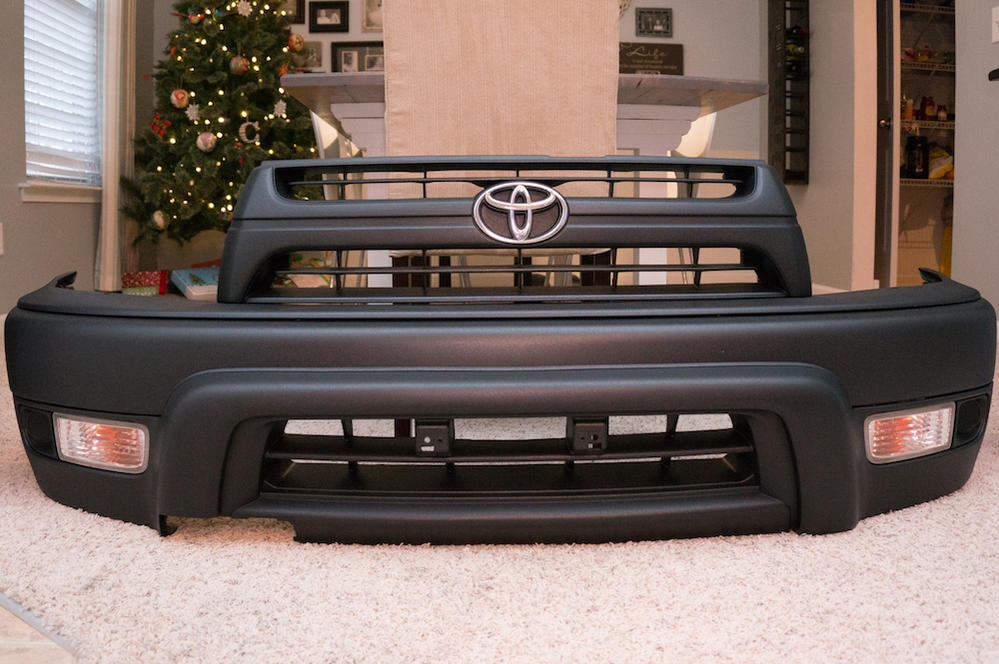

Its raining like crazy right now ... I actually just finished them last night. Gonna wait till I can get out there without getting drenched to put them on. Prob gonna b Monday but here is a look with them stacked inside ...
Check out my thread ... the whole process is on there if you are interested ...

Will do haha. I've been doing the same thing you've been doing haha my own "operation blackout" I just finished the emblems and redid a wheel because the tire changer ripped it to shreds. Btw how aggressive is the texture?

Best way I know how to explain it ... maybe like some 100-150 grit sandpaper. It applied very smooth and even, not chunky at all ... I expected it to be more textured but I like it. I think any more texture and it would actually look weird. there is a close up at the start of my thread I think ... it show the texture a little better ...

That's exaclty what I was thinking haha that's why I asked how much it was textured. I can't wait to see it mounted :D. Did you prime it? Or just spray away.

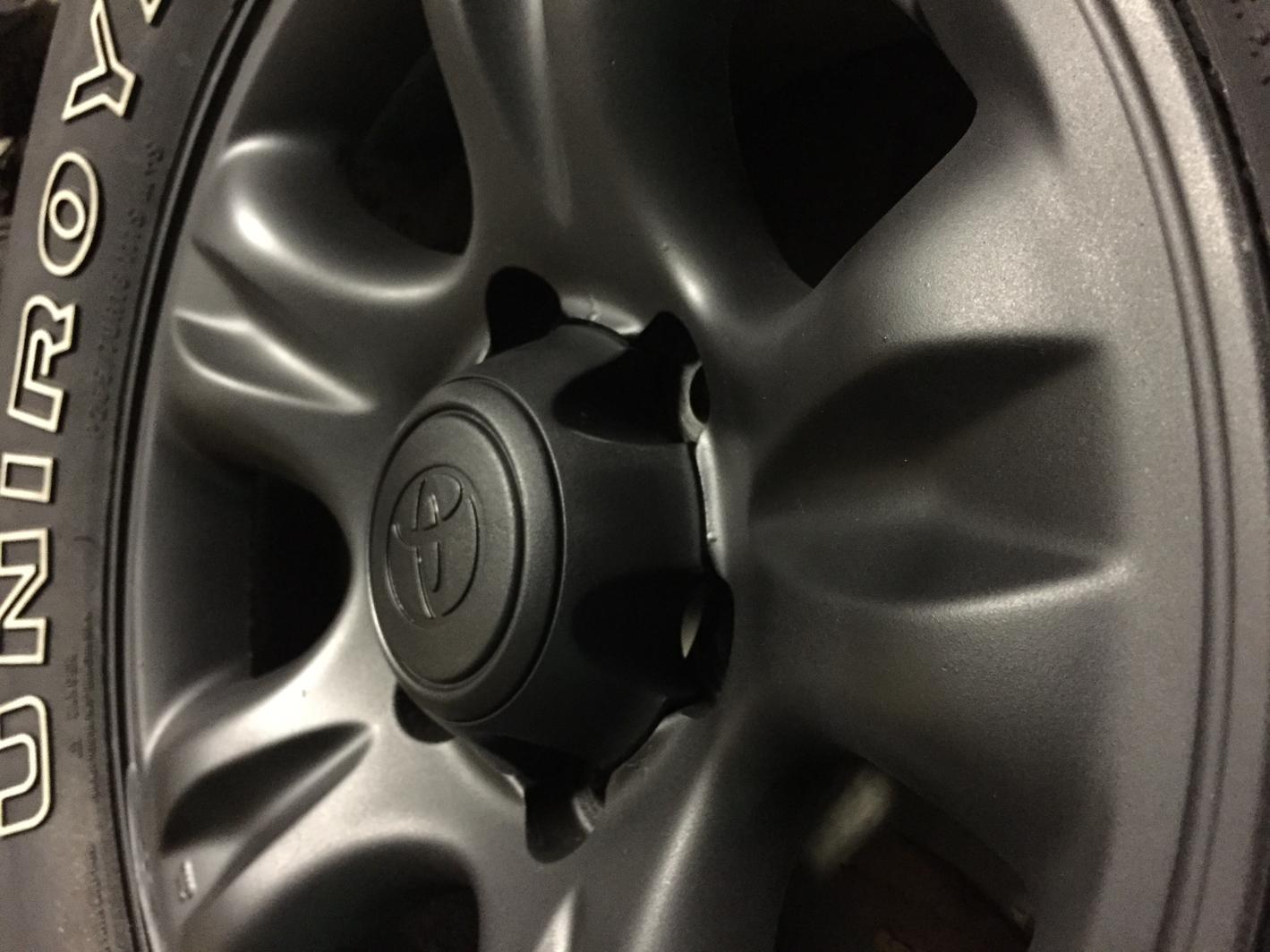

Off topic ... but ... How did you do your wheels? Is it holding up well?
I coated them with plasti-dip. They're holding up very well haha. I've been on numerous trails that were basically big briar patches and they aren't even scratched (just don't get them near a tire changer haha. They have about 4/5 coats each. About $30 for a complete set of tires (spare included). I was quoted almost $400 to have them painted haha so I like my savings.

Nice haha it looks like it paid off! The wheels I just sanded down any rough edges and then sprayed it on, haha the joy of plasti-dip. Do you think for the rear step Id need to do much? It's already kind of textured so I was thinkin about a light sanding and then off to bed liner.
Looks amazing ... How long has it been done? I see so many mixed opinions on Plasti-Dip wheels but I am convinced if you clean it well and coat it generously will probably hold up well ... Also saw a post of someone who coated with Plasti and then painted on top of that ... Caught my attention but I prob wouldn't do that ... I am almost sold on those wheels they are sharp :thumb3: Nice job.
Thanks! I really appreciate it haha. I did it about a month ago. I honestly love it, I plastipped my spoiler and decals too. You can plastidip literally anything haha I'm currently plastidipping my phone case because it was too slick. The great thing is if I don't like it then I can peel it off.
