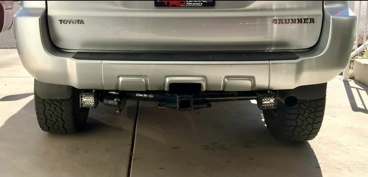

I have an 08 and bought these Amazon.com: LUYED (2 Extremely Bright 1600 Lumens Backup Reverse Lights 360-Degree Shine 921 912 W 16W 3020 30-EX Chipsets, Xenon White, No Hyper Flash: Automotive
and replaced my existing backup lights, huge difference. In addition I also mounted a couple LED’s to my aftermarket HD tow bar.
