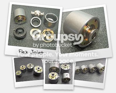

I'm between using a couple difference joints, and the decision will be made by time I get back from Colorado on the 2nd. Below are my two options.
Option 1:
  • Ballistic Poly Bushing
  • Ballistic Forged Joint
Option 2:
  • Summit Machine Poly Bushing
  • Summit Machine Flex Joint

I can attest to the Medium Summit joints fitting perfect, i also have the assembly tool if you want to use it. I could mail it to you for assembly and setting of preload. Its a lot easier than using a hammer and punch. lol

No big deal. I'm going to order some medium Summit Flex Joints and their 2-3/8" Poly Bushings next week.

I decided to just go Summit Machine all around on these. In order to use heim I would have spend a lot more money trying to get them to fit. It's great that 9/16" will bolt right up though!

I like the flex joints. Are you going to put them on the frame end and the bushings on the axle end?
I like them like this, I used that configuration with the arms that i built. The increase in articulation is noticeable with the Summit joints at just one end.

I'm putting the Flex Joints on the frame side and the Poly Joints on the axle side.
