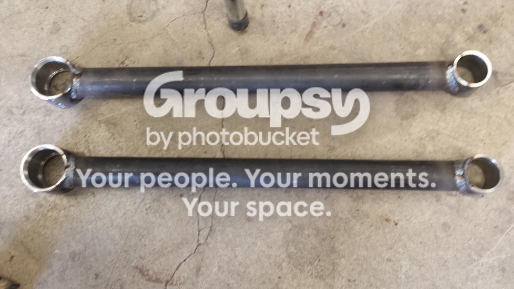

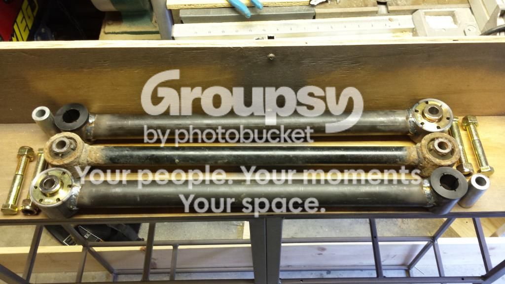

Rear Control Arm Build
Those arms are bad Ass bro. Now are you making adjustable ones or ? Lets say a person has 3-5" rear lift.
Adjustable will be an option. I'll most likely do fixed and adjustable arms. Getting adjustable arms wasn't something that I really cared about at the time, and I didn't want to spend the extra money the first time around. I'm still not sure on weather I should offer them as a weld together kit, welded kit, or both. I know a lot of people would be happy getting a kit and welding it up themselves to save some money. I also know some people don't have access to welder that will weld 1/4" wall tubing. I've got some thinking and painting to do this weekend. Hopefully I can have my mind made up by Monday and figure out some pricing.

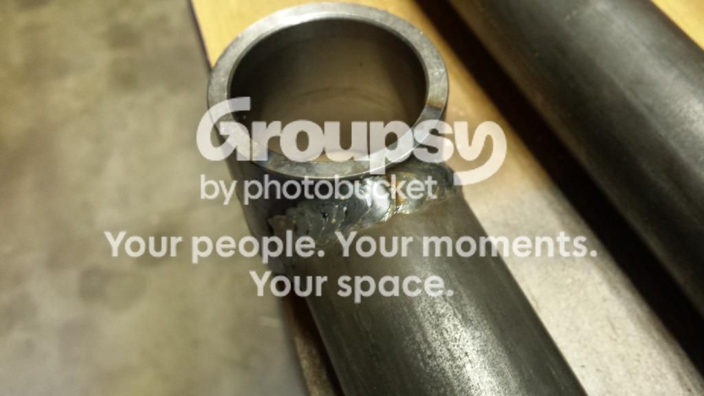

Round vs Square, Looking good man! I reused the stock barrels on the axle end since i used OEM bushings, did your poly setup require new barrels? I think i want to swap to Poly at the axle.

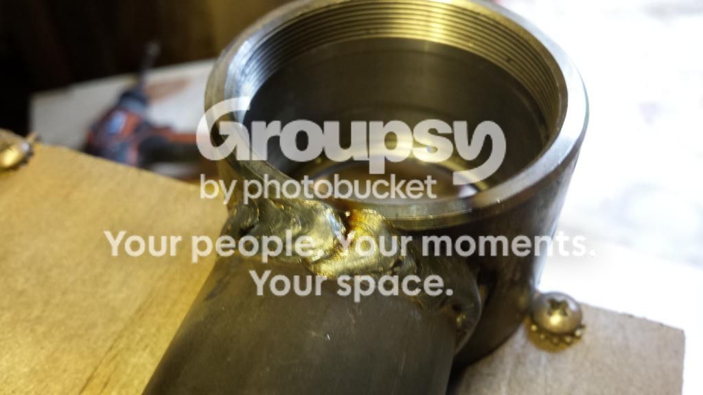

How close are your welds to the outer edge of the barrels? I was TIGing so i had to be careful with the heat it was so close on the sides. What tube did you decide on in the end?
The barrels that came with the poly bushings are the same as the Flex Joints (9/16"). They work with the stock bolts if you want to retain the 17mm factory bolts, or you can use 9/16" like they were made for. I wanted to use TIG for this, but I didn't have enough gas in the tank. Using MIG worked out just fine, and most likely gave me a better finish since I've only TIG'ed a couple times in the past.
I ended up using 1-1/2" x .250 DOM for this. That is the largest size DOM you can use with these joints, unless you sleeve over them as well. The tubing was pretty close to the cups on these as well. However, I think square would have been a bit closer to the edge of the cups than round.

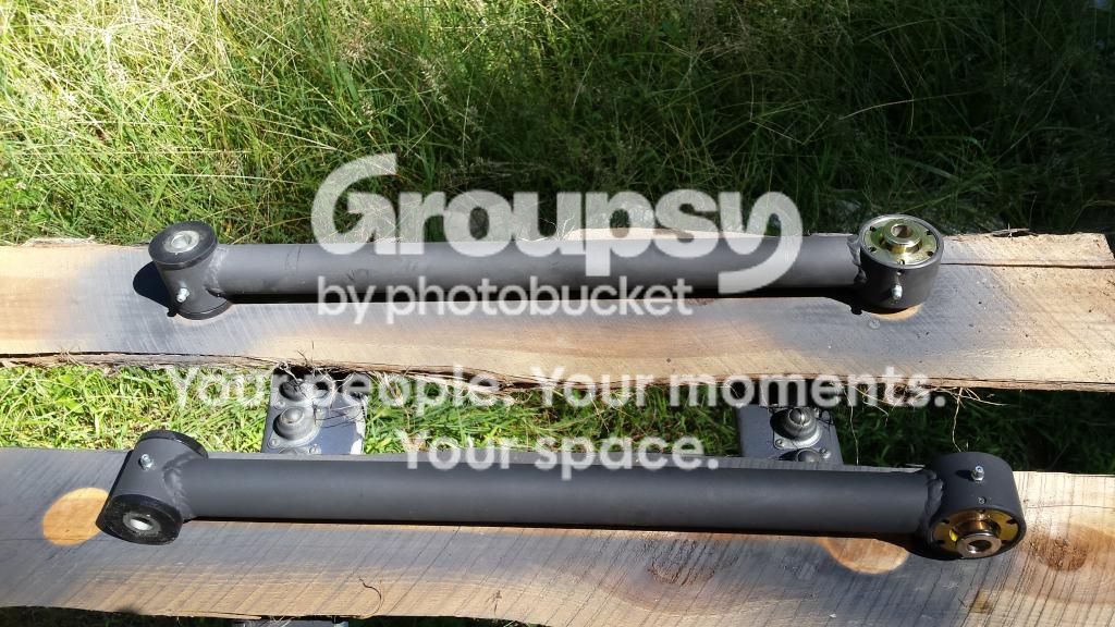

All painted, assembled, and greased. Just got finish putting them on the 4runner and washing it. It's hard to believe that I'm still cleaning red dirt and sand out from Gilmer Texas back in May.
ok i want a set... id like the hybrid version with adjustable up top... subing to this for updates.
Alright alright! I'm going to offer Summit links and heim links. Of course the heim links will be adjustable. I'll also offer the Summit links both fixed and adjustable. Give me a couple days to get everything together. I'll start a new thread and post a link here for it soon.
